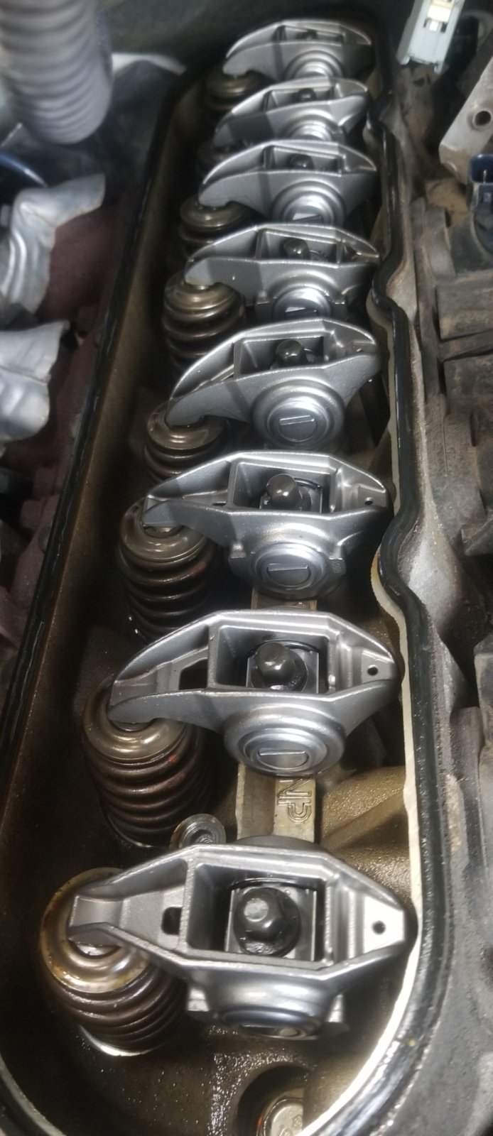

The #8 exhaust rocker had the most play, the rest had a little bit of excess play.

Already replaced the #6 exhaust rocker last week, replacing remaining 7 on this side today, almost done.

This was the play on the #8 exhaust rocker, slightly more than #6.
Well, seems the #8 exhaust rocker was the culprit. I didn't have time to get a magnetic base setup and measure the travel, I will build a jig and see how much play it had later.
I let the engine run at 1500 RPM for 20 min, then drove it around for about 20 miles.
All is quiet.!! :thumbsup: :cheers:
What a relief, definitely going to change the left side soon.
Looks like the worn rocker+heat expansion+ any manufacturing tolerances, was enough to remove enough lash for a tap.

Thanks, I wasn't aware af any issues with these rockers until I did some research after the fact. I was also surprised even the new rockers have some radial play but they have been known to go the distance.
When holding a high idle around 1500 RPM, there was even some popping in the exhaust, that has now ceased with the new rocker.
Seems some have had problems with needle bearings coming loose so maybe that's what might have happened later on...not sure.
