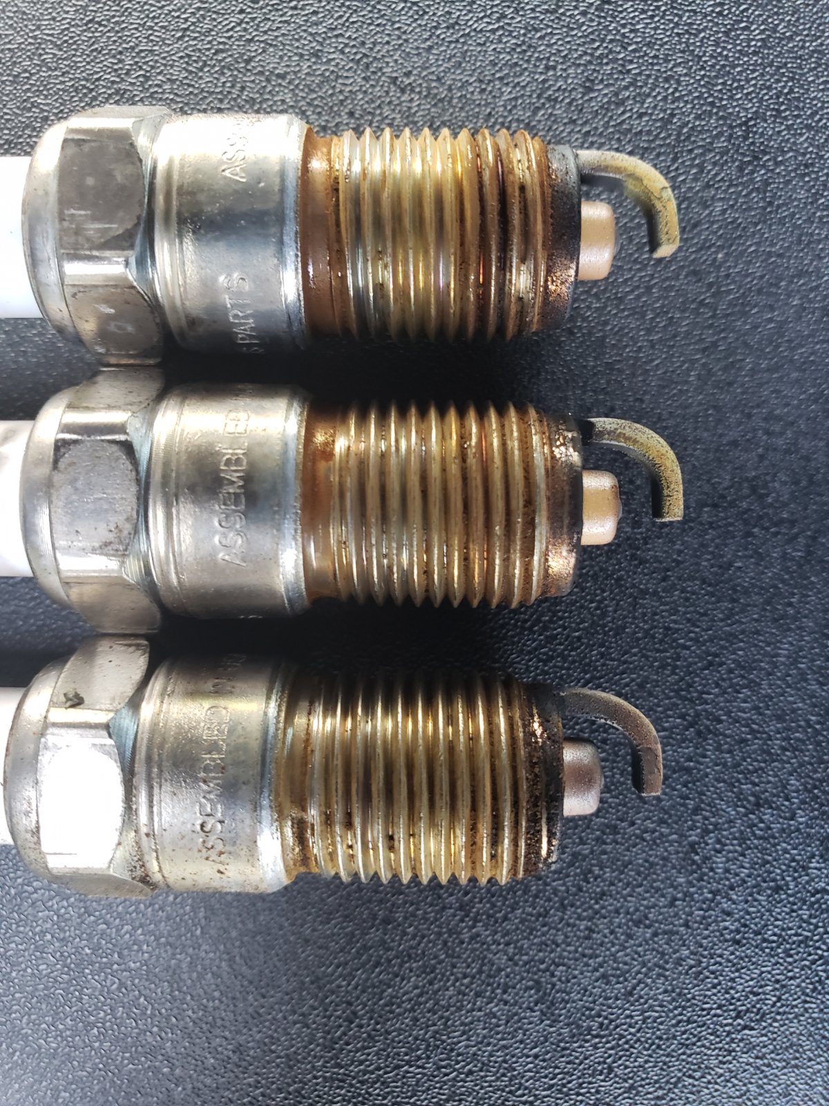

Personally I would pull at least 1 or 2 plugs just to put eyes on them and rule out it being a (fake) plug issue.
If the plugs look good then you can move on to looking at other possible culprits.
Thus is what my fake Delco Iridium plugs looked like when I pulled them compared to the new Ruthenium plugs...

how many miles on those? Wouldnt i have issues a while ago, like within first 10k miles?

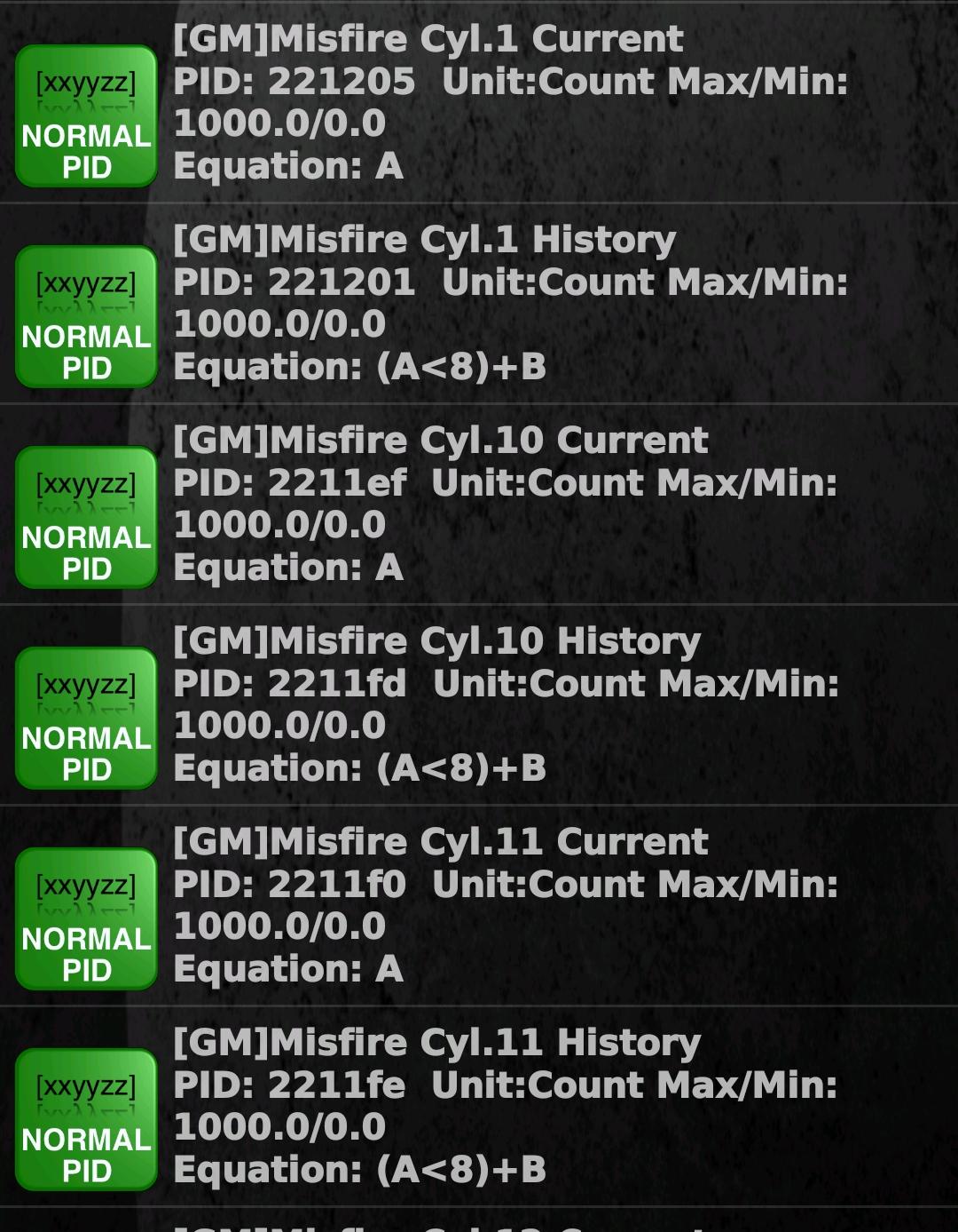

i dont remember seeing anything discussing misfires on torque :(
In the Torque Pro app go into Settings > Manage Extra PIDs/Sensors > press the 3 dots at top right of screen > select Add predefined set > Pontiac/GM/Opel/Vauxhall
Now scroll down about 40-45 PIDs and you will see this...
They are not in order... I don't know why... but all 8 cylinders are available.
Nope... mine had roughly 75k miles on them and I didn't have any misfires... only reason I changed them was because I wanted to try the Ruthenium plugs and I figured why not.
You are a God send. Great instructions except...mine only shows 6 cylinders. I have the free torque app. Not sure if that matters. It has 2 sets of misfires (current & history)
Also, what should be happening on this view? I can only edit or delete these options. They are set at 1000 max value.
Once you enable the PIDs then you will want to go back out and go to Realtime Information and long press on a blank screen and Add Display then choose which type, I use the Digital Display then you scroll down,like you did before, until you see Misfire Cylinder (X) current or history and select the one you want to see. Do this for each cylinder.
I'm not sure why yours only shows 6 cylinders... maybe it is because you have the free version.
