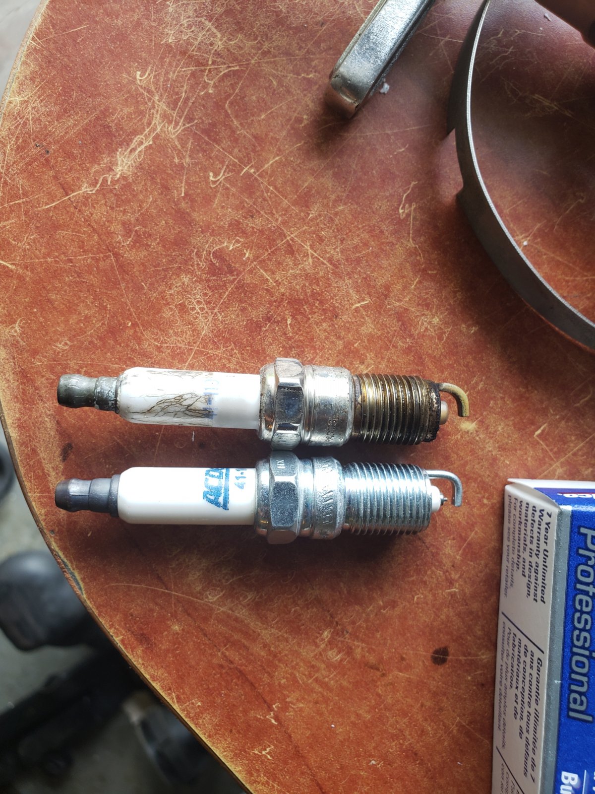

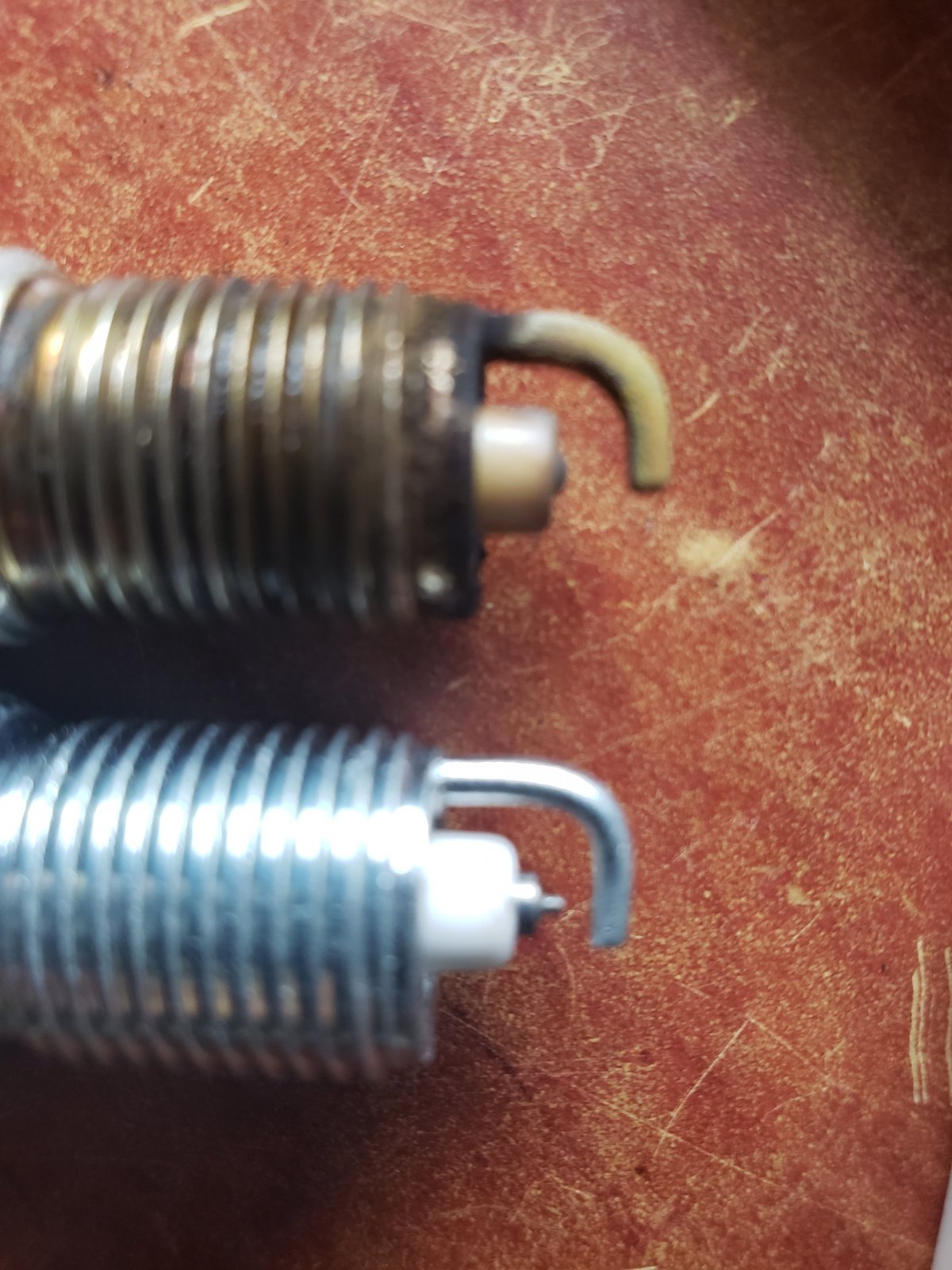

I checked plugs and the bad cylinders seem to be the same as the good cylinder. Took pics of 2, 4, and 5 and they all look the same. I'll share soon.

Way overdue for new plugs. Hardly any center electrode left, and huge gaps. SMH
EDIT: I think you got the same knockoffs as @kbuskill had. Actually, they look like plain old copper plugs. No longevity.
