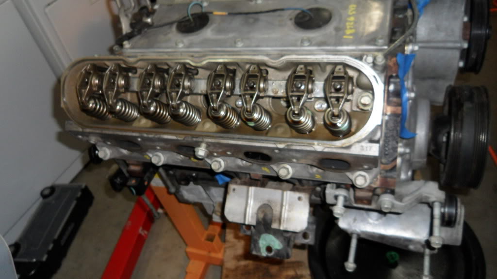

After doing a leak-down test I got 30% on a couple cylinders so I decided to just pull off the heads. After I pulled them off they weren't bad at all, just some carbon build up on the valves. Better off safe then sorry IMO. Also gives me an excuse to get them surfaced and have the machine shop do the springs for me.
Pics so I don't get stoned :owned:
I still need to decide on pushrods and springs.. I've read that the comp cam 918's have problems, considering pac 1518. Not sure whether I really need to replace the pushrods.
