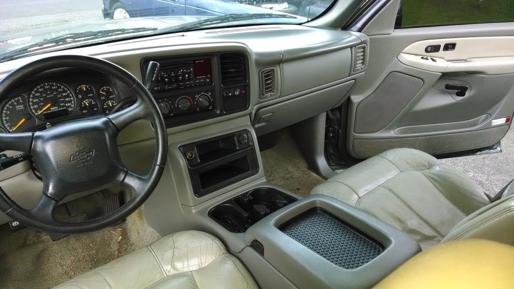

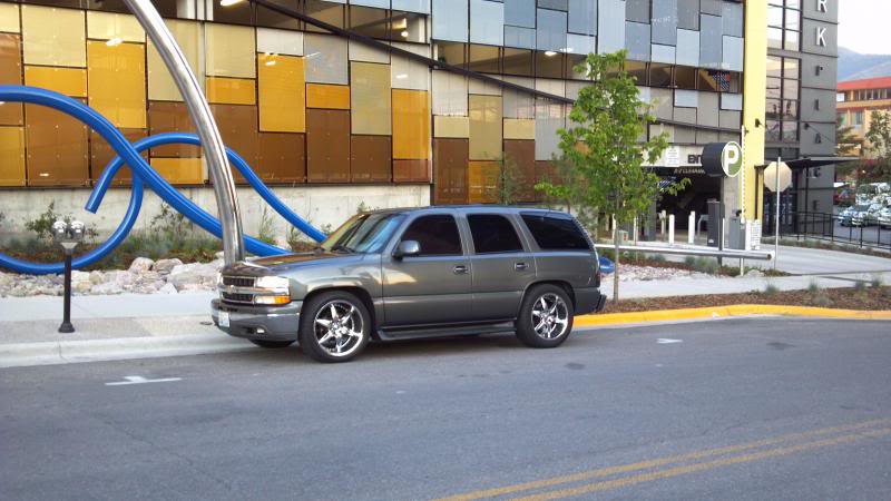

Here is the old girl in all her glory,,, at 5480 lbs. She's a big girl but I still think she's pretty good looking. :)
That is all. Will update as progress is made. :)
Mike

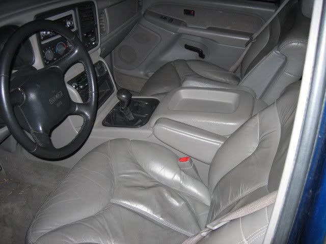

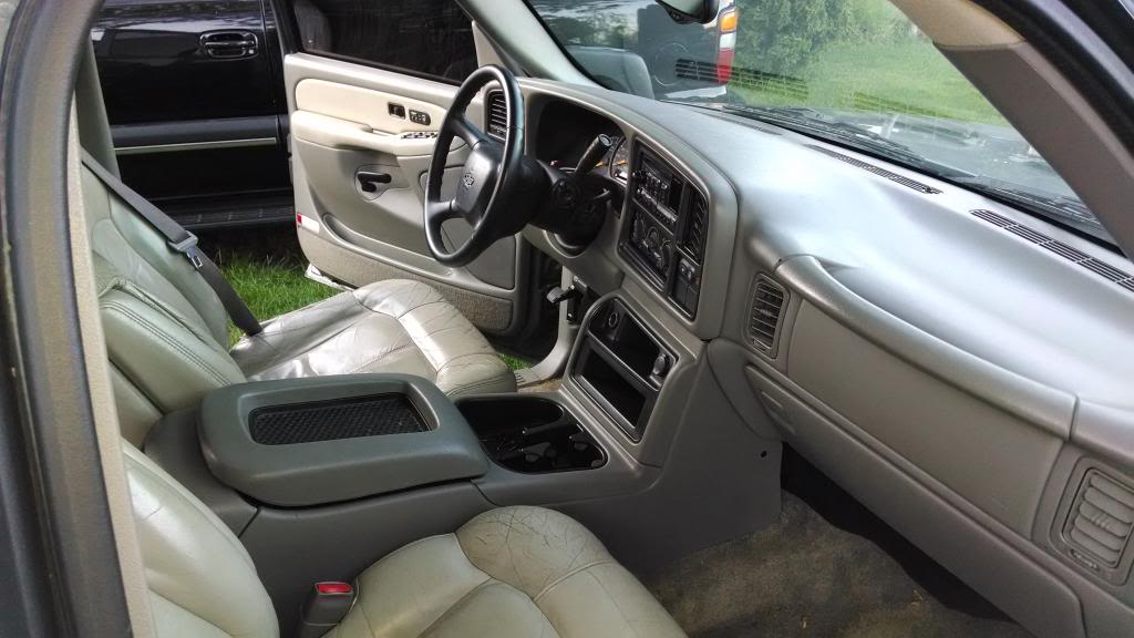

A couple weeks ago I picked up an 03+ center console and finally got around to installing it this past weekend. I got it in preparation for the T56 swap. I think these consoles look so much better than the original console. Plus, with having the drink holders on the side I can retain a drink holder while the shifter location will up through the left side. I will try to post a pic of what the final product should look like when its done.
OK here is a pic of an 03+ console with a shifter coming up through it.

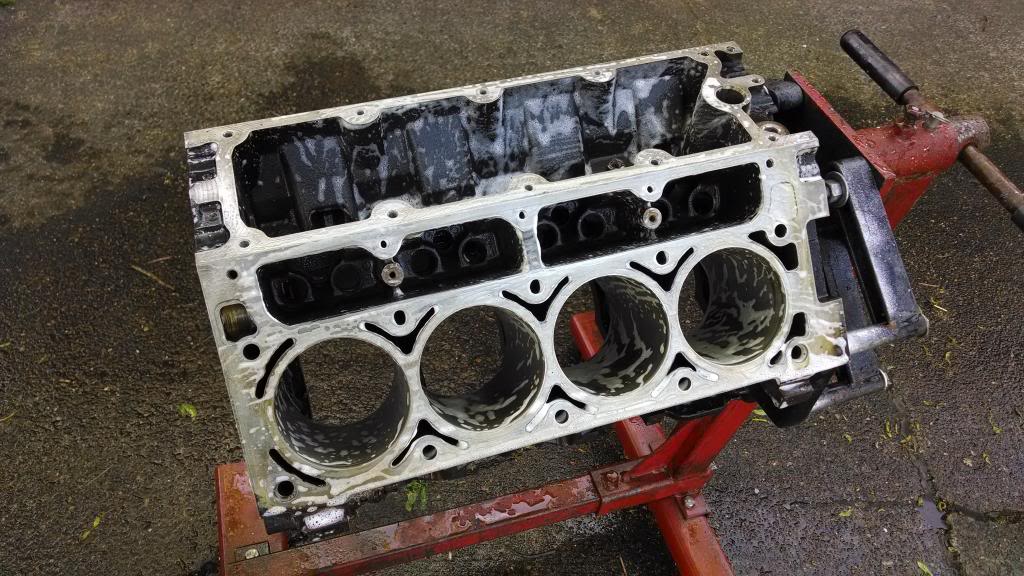

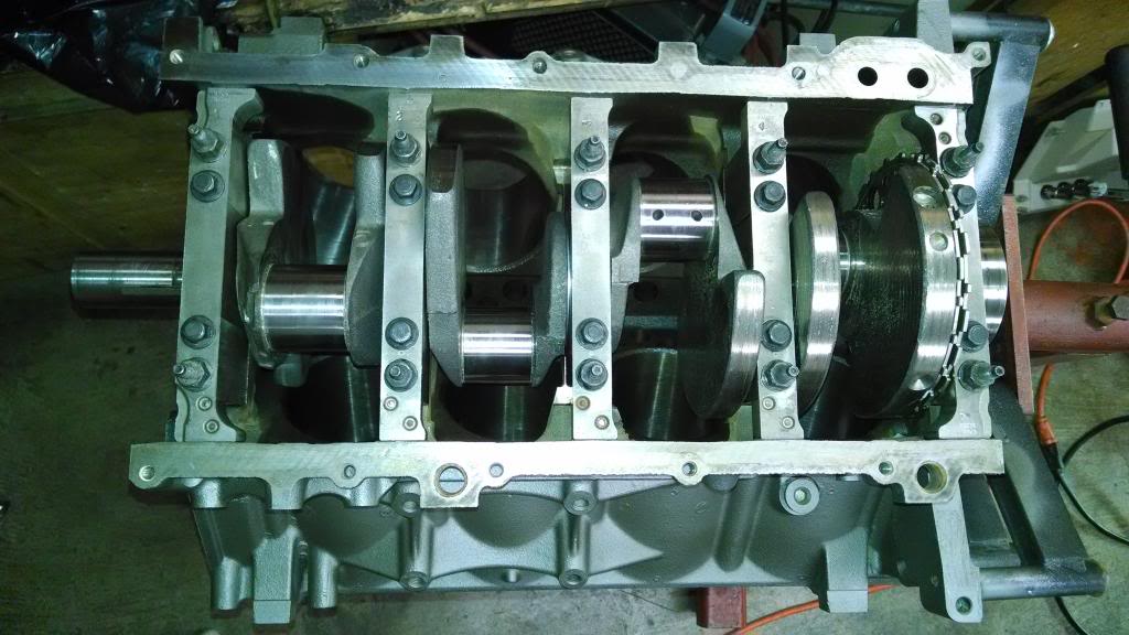

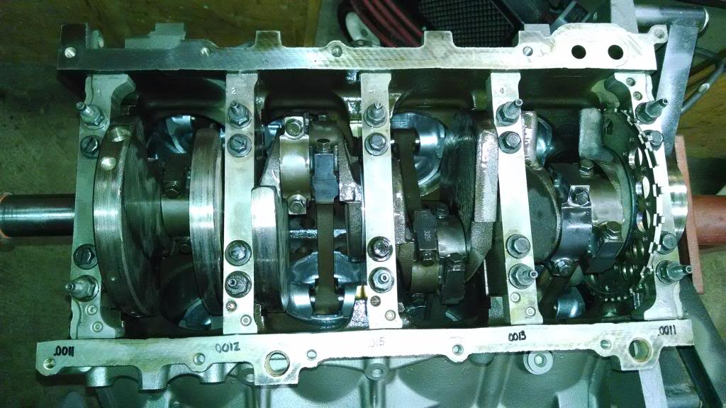

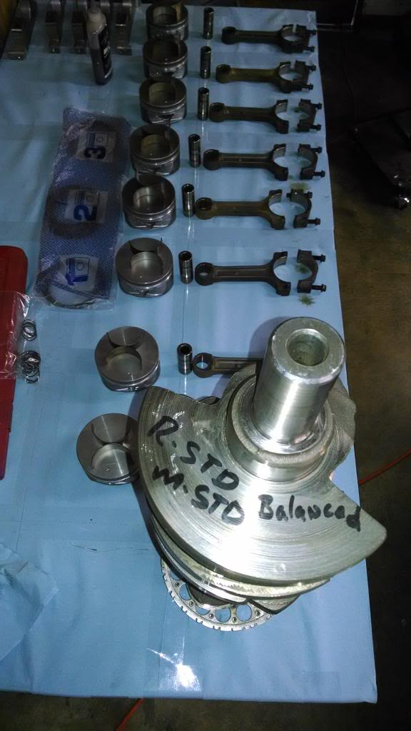

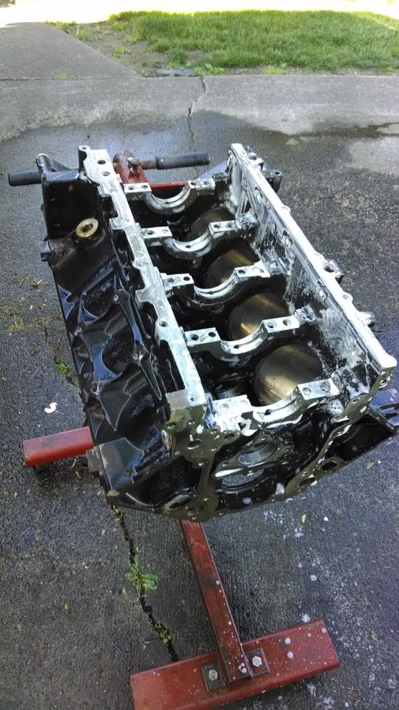

Here's some updates on the build. Can't find a T56 GTO main shaft anywhere (Tremec is back ordered on just about everything) so I sent out one of my spares to get repaired. In the mean time, got some work done on the budget 6.0 engine build after getting the block back from getting honed.
Prepping the block for assembly...

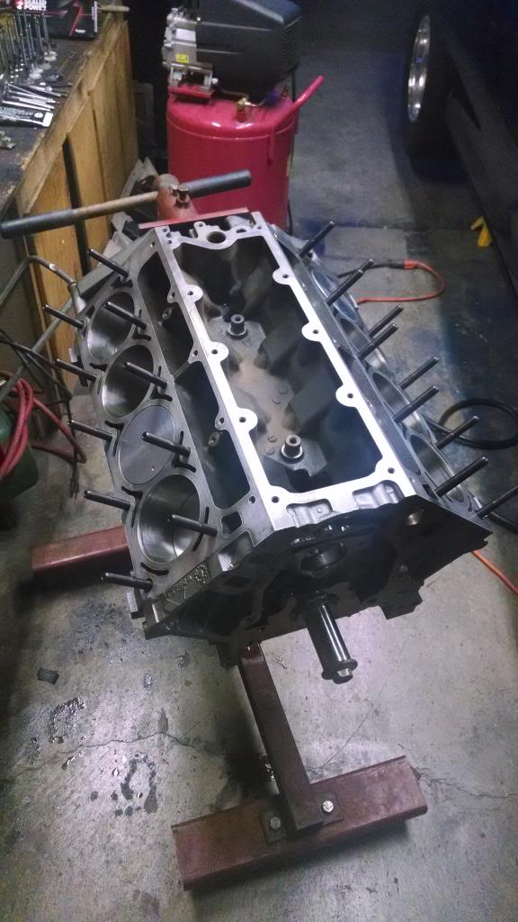

Checked the tolerances on the main bearings and got the crank installed. Also got the rods mated with the pistons and installed the rings. Should have the short block finished up this week if I can find my cam degree wheel.... :)
Mike
