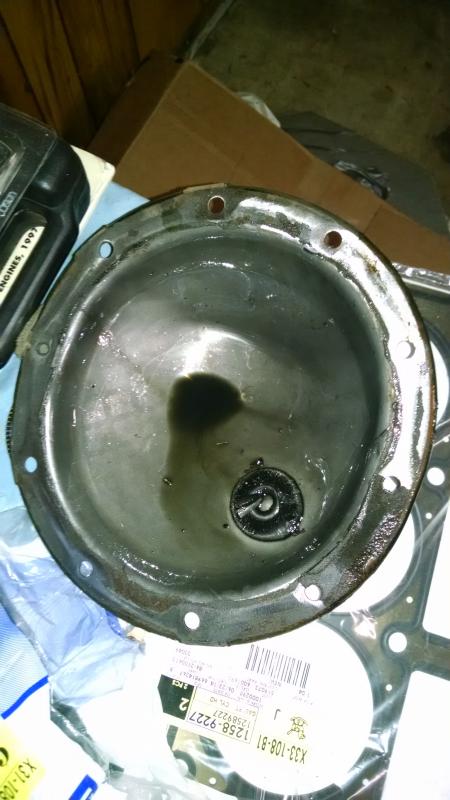

Got the inspection cover made for the T56. Then realized I'm missing the vehicle speed sensor.
