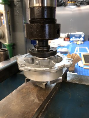

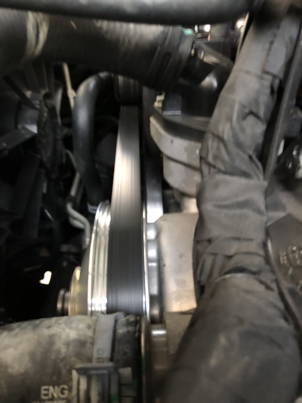

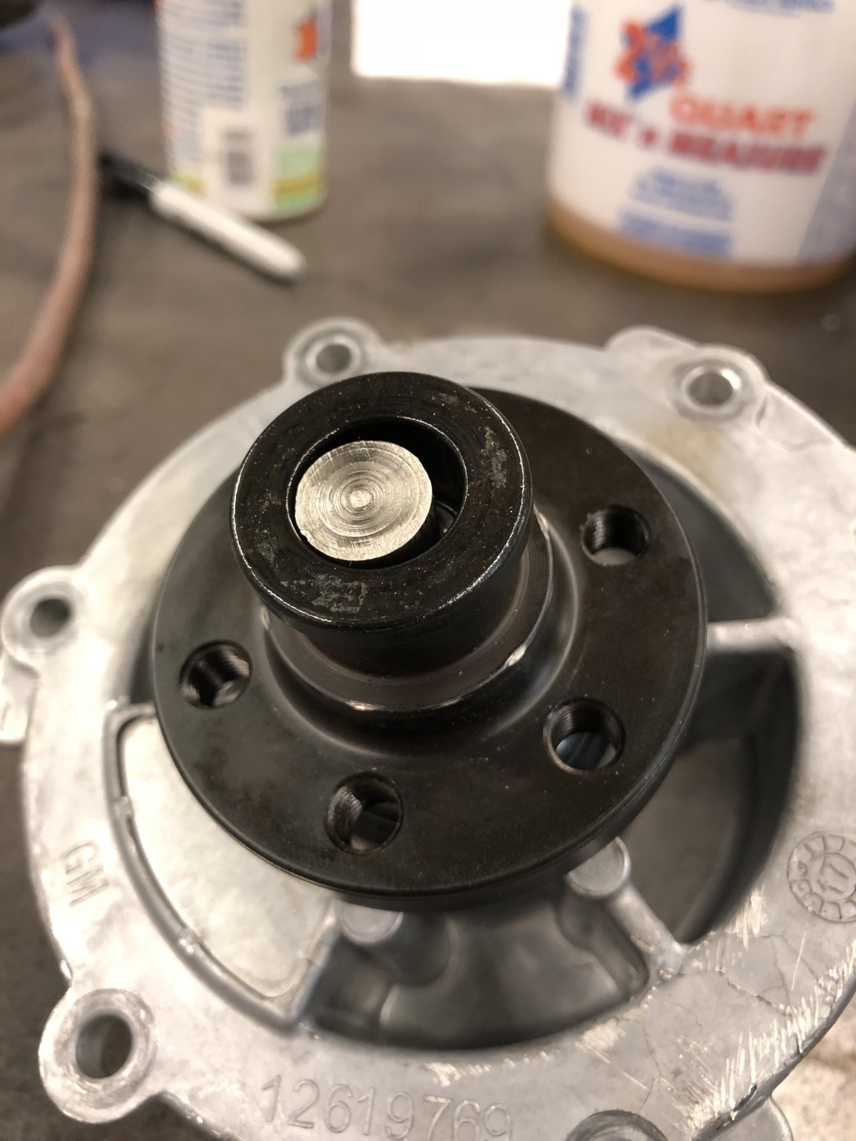

Installed Innovators West pump pulley today. Requires a stout press, my press registered almost 8 tons. Machined a .500 spacer to control press depth. Glad I’m “dry running” the belt setup before build. Wanted to check tensioner however did not receive a pulley. The alignment came out really nice

Talked to Innovators West today, the people there are awesome! Missing pulley already in route. Really friendly staff.

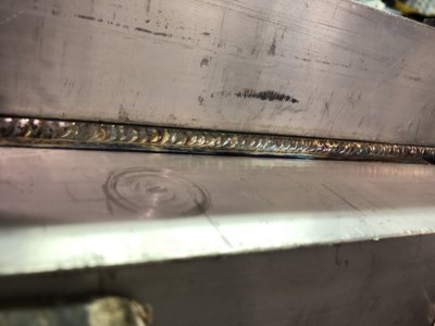

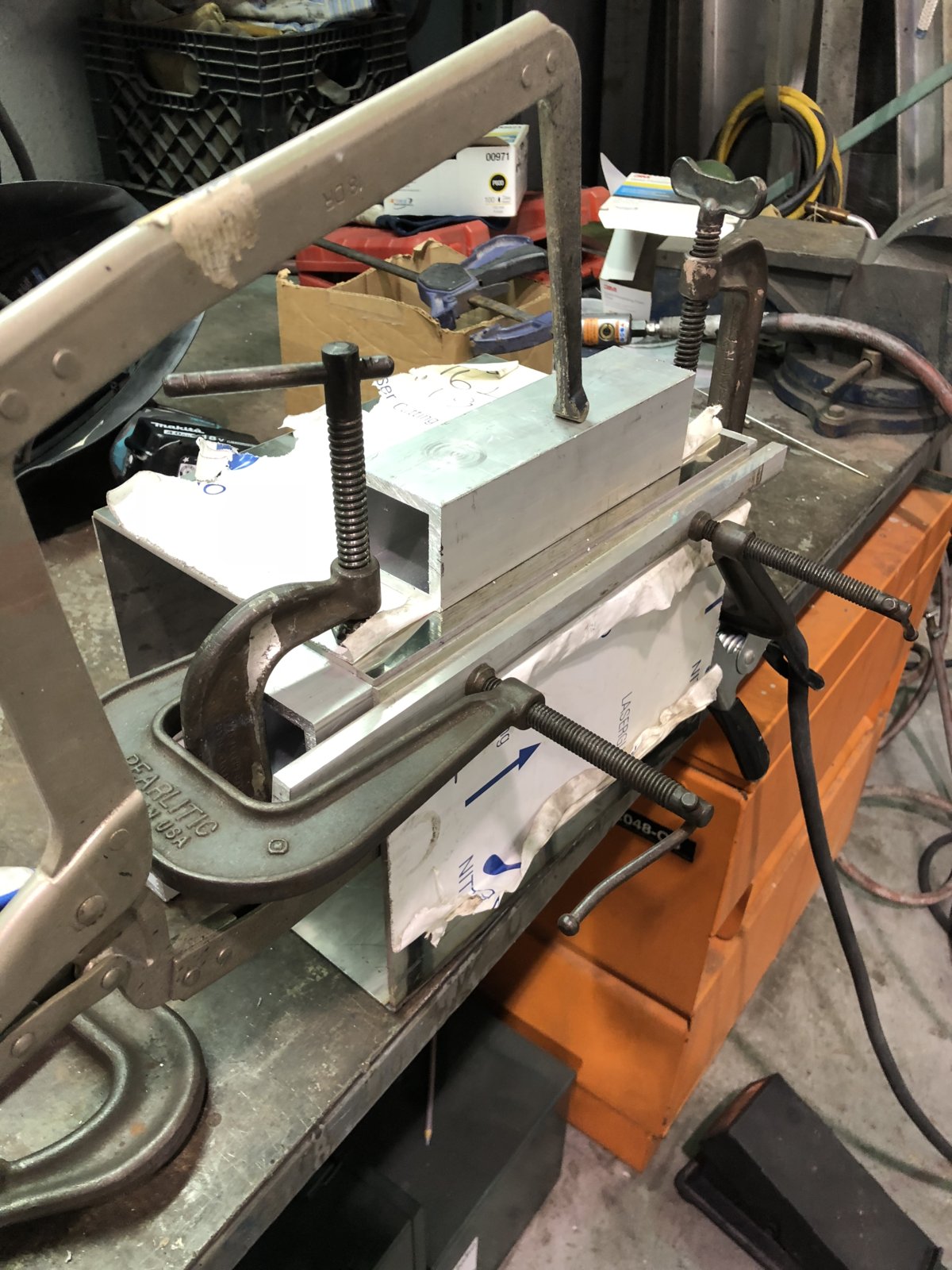

Hi all, been awhile, quick update. Manufactured my meth tank, still need to do final lines to the pump and a vented fill, however should have permanently installed by weekend. Was a good project to practice stainless welding and procedures. Pretty happy with final product, extremely little distortion. I used rivnuts for the mounting. If done again, I would make the tank slightly smaller, needed to modify the battery tray to fight right. Final yield is 2.5 gallons usable
