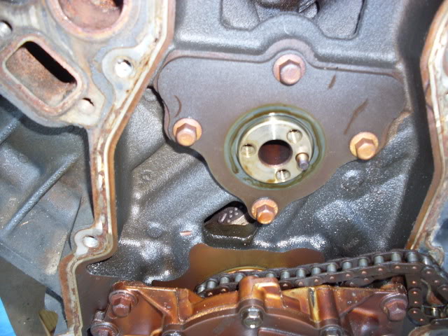

got started on pulling the flywheel and replacing the rear seal and the rear seal housing today. there are 6 15mm bolts that hold the flywheel on, took those out, sprayed some pb blaster or pblaster or whatever that stuff is and gave some light love taps from the backside with a hammer.
better pic
so that's the ass of the crank right there, and that's the housing that holds the rear seal. better pic to follow.
so you pull those 10 or 15 10mm bolts on that silver plate, and off comes the plate with rear seal.
outside:
inside view:
and the gasket that seals the cover to the block:
straddle the cover on some blocks of wood, put a screwdriver in the back of the lip of the old seal, couple sprays of pb blaster, couple love taps with a BFH (big f***ing hammer) and the old seal comes on out.
hard to see in this pic, but there is an "outside" stamped on the seal, so you don't get it backwards.
pic of said BFH
i didn't put the new seal in yet, need to get some steel wool or crocus (spelling?) cloth and buff the outer race of the crank so the seal won't tear up prematurely, and some brake parts cleaner or carb cleaner to clean the mating surfaces. anyhow, like i said, nothing real spectacular to report, just an update. i'll try to remember to put the torque settings on this thread as i go back together with it so maybe it'll be worthwhile for someone that cares to do this or has to do this later. have a good weekend subscribed threadwatchers.
