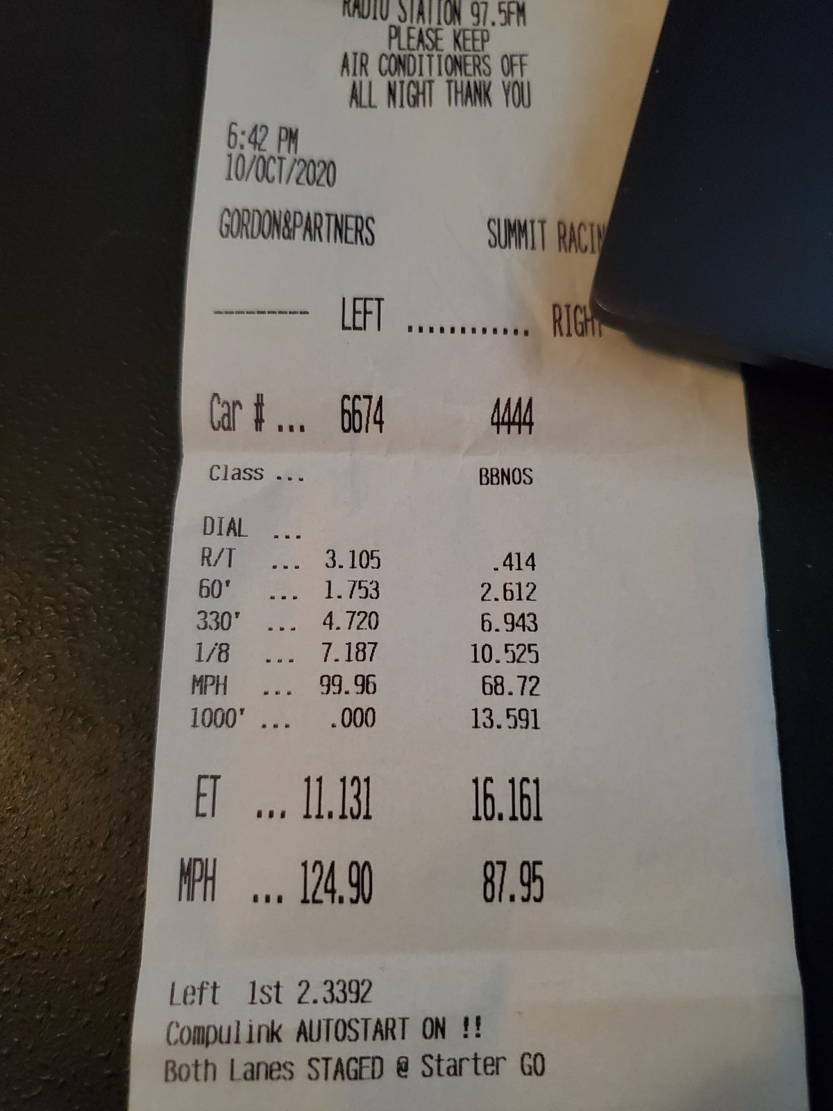

its not really slow by any means, but it should be a lot faster lol
1/4mile calc puts it at like 860hp...1/8 mile is probably more accurate because its not as restricted at around 940hp. 20% driveline loss i wouldnt be surprised if it were higher should be well over 1100hp.
may try and make a turndown right at the downpipe to see if that lets it breath a little better
