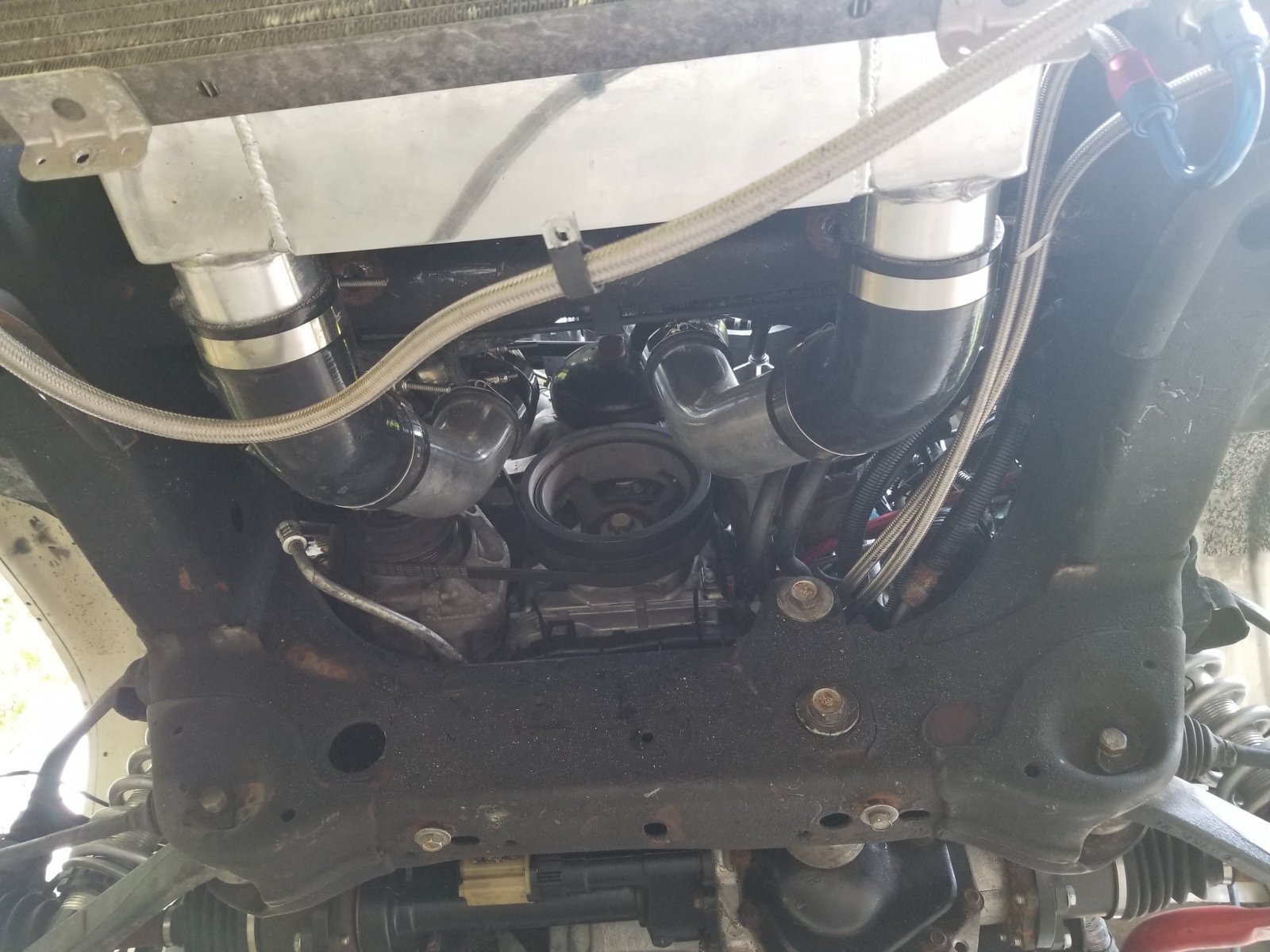

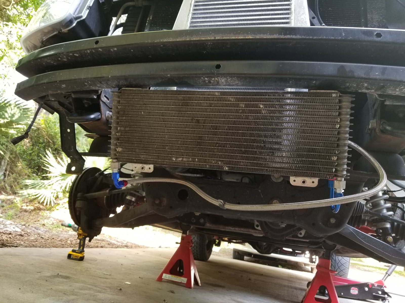

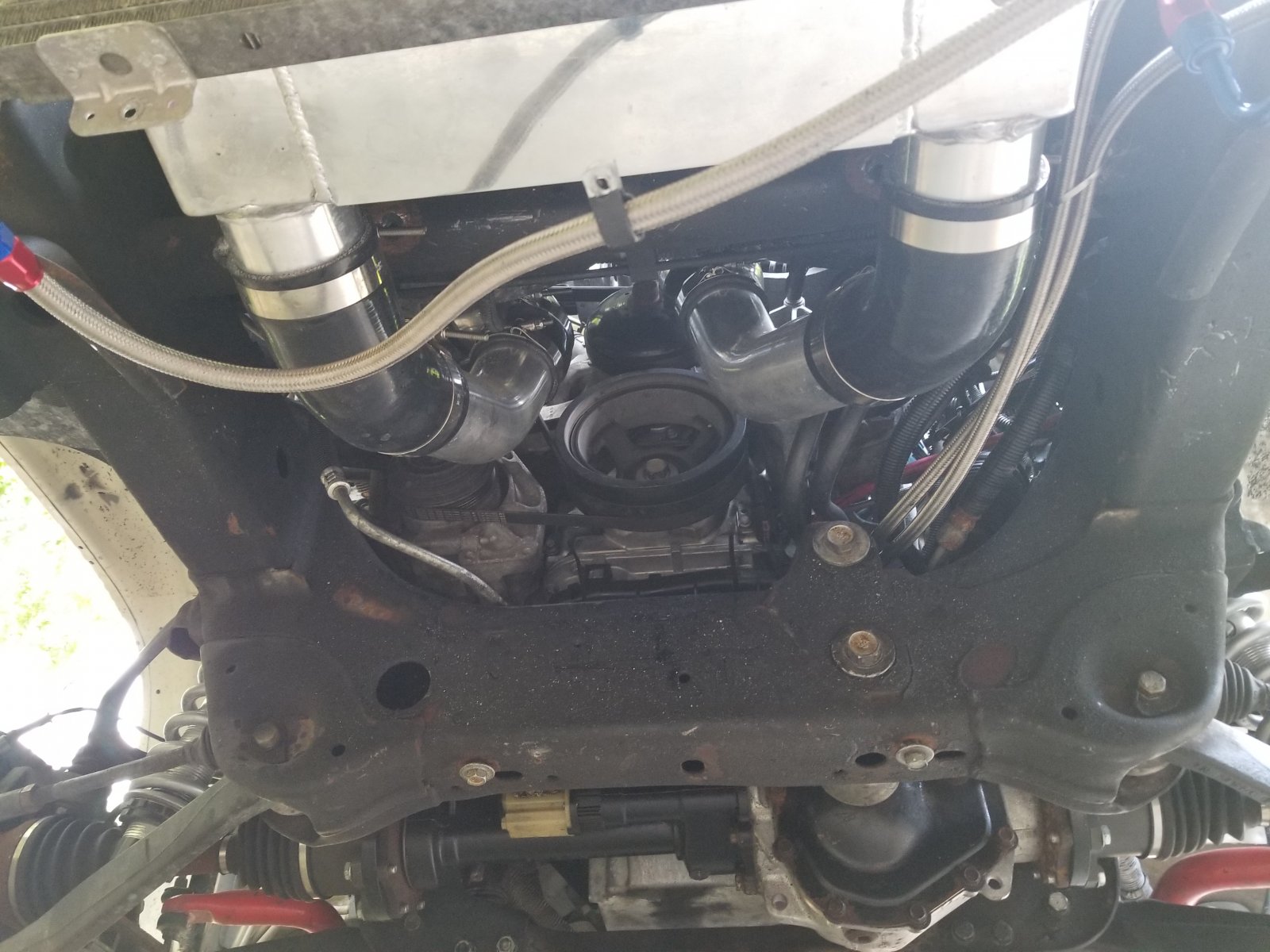

Can hardly see it behind grill:chewie:...was dark by the time I wrapped up and got cleaned up. I'll take a few pics in morning. Need to remount trans cooler or maybe grab a stand alone one with fans to mount under truck somewhere. Intercooler to throttle body all done too.
Finally bent all the ac lines where they should be good, will still grab some insulation wrap though.
Turbo and dp went in and out about 20 times test fitting, moving crap , test, move, should be done though. Going to wrap downpipe tonight.

That red wire under car is new one to starter. Wanted to get it in before I buried the starter. Ground side I threw back in to block and another smaller ground went behind the bumper
Kinda wanted to get it started with no turbo make sure any crap in the exhaust pipes blows out before goi ng thru turbo, make sure oil feed is good (havent even started)

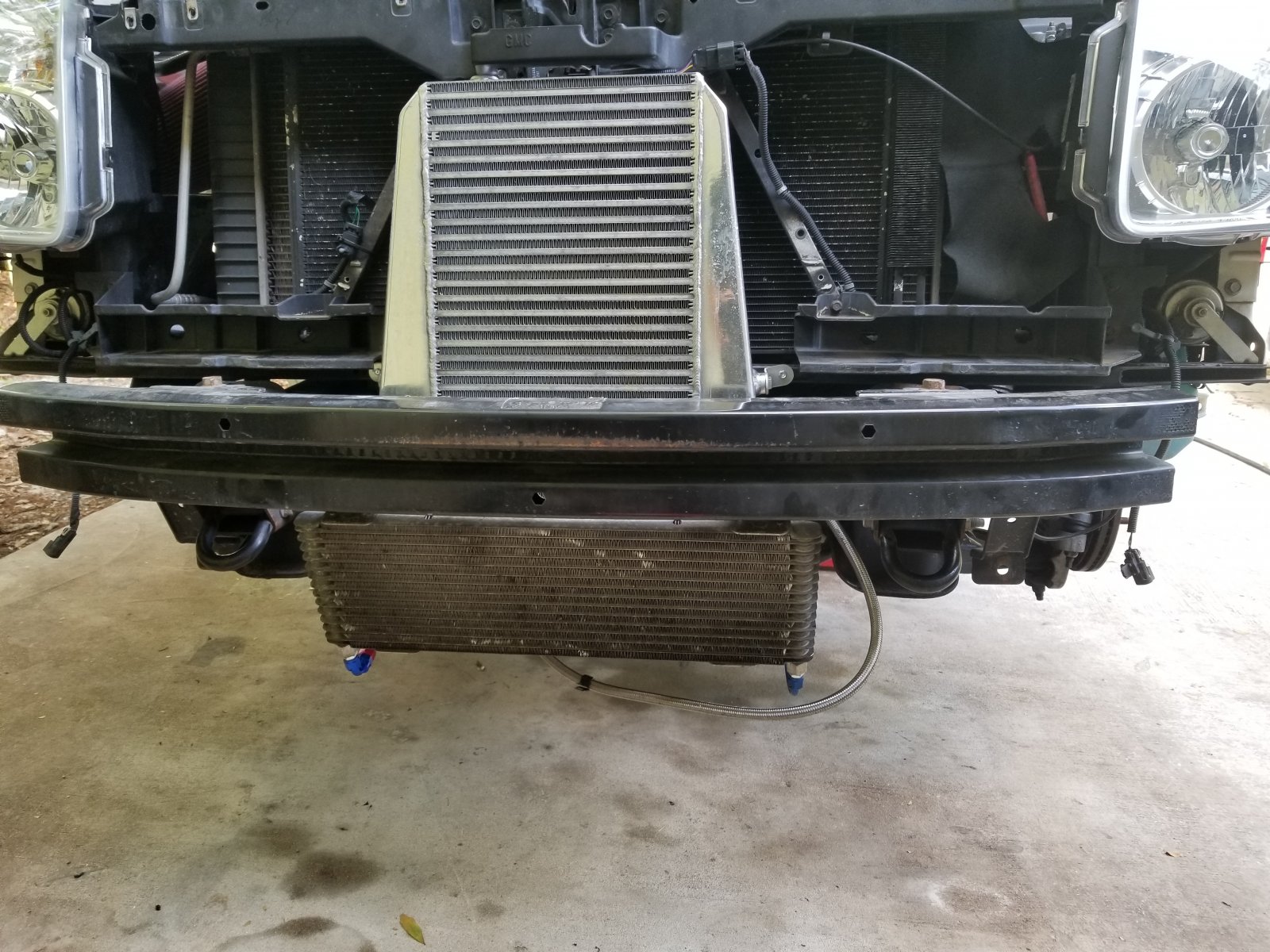

Left the lower grill out to cut out behind it so more air could flow thru
