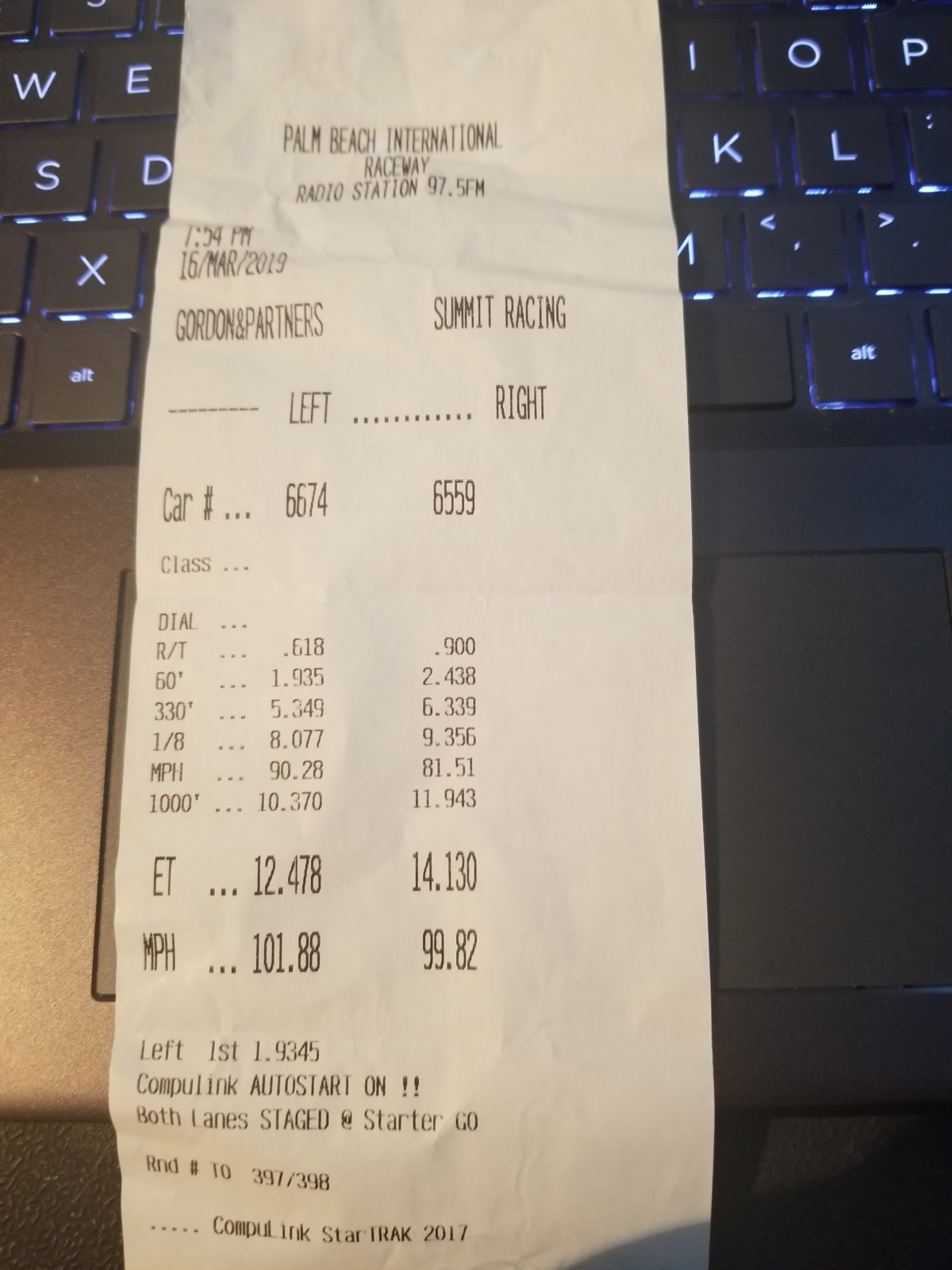

I started out looking at gear swaps and was about to pull the trigger on 4.11s front/rear. With the 6L80 and 3.42s stock i thought it was a pretty good combo but slower than hell off the line. I think i found somewhere comparing the gear ratio it ended up being like driving a 4l60 with 4.56 gear.
I had been to 1/4mile track a few times and 60's were terrible 2.3-.4. i noticed similar trucks, even 5.3s that were cuttin 1.9-2.0s. I didnt realize it but the stock converter on mine only flashes at like 1600 rpm on the foot brake. So hopefully converter will help out, and way less $$ than the gears after install.
Not sure how we are about naming non forum sponsors but they were extremely helpful, responsive, and got it out to me quick. stall should be around 3k rpm
