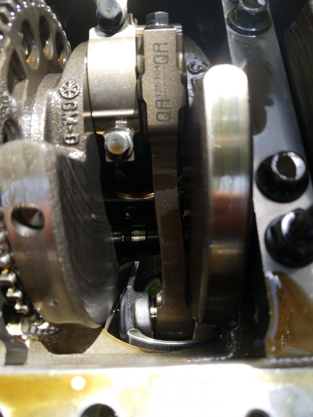

today - oil pan gasket showed up, pulled pan off - it sucked about as much as i figured it was going to. where i wanted to place the oil return, on our trucks, the oil pickup tube runs down that side of the pan not the middle like i assumed. i dropped the return down as low as i could on the pan and am going to try a threaded fitting in the pan (1/2 npt), cleaned pan used some gm thread sealer (same used for oil pressure gauge). it was real close to the bottom of the pan, like cutting threads into floor of the pan :lol: but it tightened up good, letting the sealant sit for a day or two before i put oil in it anyway. if it leaks i'll get it welded in the same spot.

...i dropped the return down as low as i could on the pan and am going to try a threaded fitting in the pan (1/2 npt), cleaned pan used some gm thread sealer (same used for oil pressure gauge). it was real close to the bottom of the pan, like cutting threads into floor of the pan
This is the return oil line from the turbo? I thought it was a gravity drain, which means you should have it drain into "open air" inside the pan.
I wouldn't doubt your knowledge with this stuff, so I'm sure I'm just misunderstanding something.
