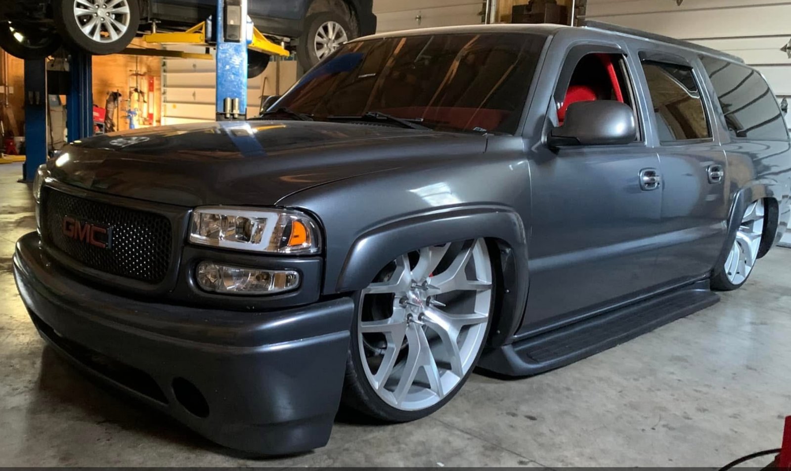

Looks awesome. Good pick. Anxious to see how it does for you. Are you bose?
Bose hybrid as I like to say. Lux amp running JVC 2 ohm door speakers, tweeters and D pillar speakers. Sub output from HU running Soundstream 250 w mono amp to a 10”’ JL sub in an MTX Thunderform enclosure behind the rear panel. It has great imaging due to the Lux amp and great bass. And this HU just made it sound even better. All done. It was pretty easy, just cut all the wires off the Sony plug and color matched them to the Pioneer plug, plugged in the cam, usb wire, remote plug for the SWC adapter, sub and had to install the included mic since the plug was smaller. I ended up having to cut the brace behind the radio cage too, this units was deeper. Then had a bit of a time setting up the wireless CarPlay but it’s working now. I’ll add a pic of The Beast for the splash screen. It has an HDMI input too so I’m gonna add an outlet as well as 2 usb outlets
