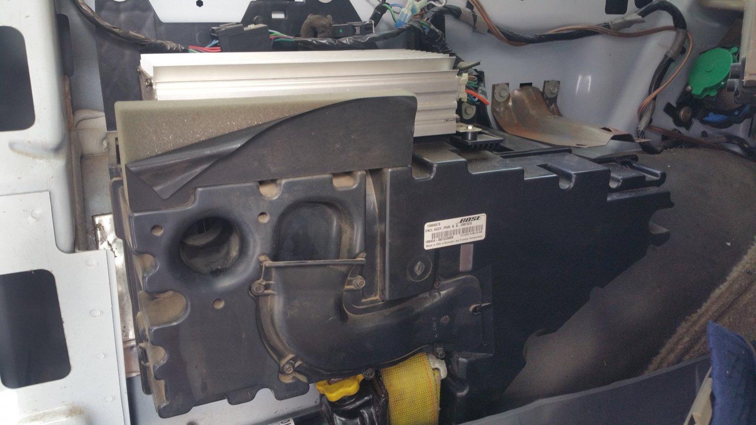

Next I needed more bass. I was running everything off the factory Lux amp, which is the best GM had at the time and is actually not bad. The Denali had the Bose Acoustimass enclosure in the rear driver side quarter panel. I looked into upgrading the sub itself but due to Bose's proprietary system, that was impossible. here's the stock enclosure, with the Bose 4 x 7sub. It has a port where the bass comes out of with a 7th order bypass (I believe) enclosure. The actual sub is mounted in the interior.
Where is the Denali Bose amp located at

If you have 01-02 it sits on top of the subwoofer behind the drivers cargo panel. The 03-06 is under the center console if I'm not mistaken.
My 02 sub/amp

Unless you go with the mtx thunderform $$$ upgrade I'd stay with the bose sub. I did a mod with a suburban/tahoe sub box and a 1200 watt 8in sub but the bose sounds better. Now I have added 1 15 in sub and I'm happy.:2cents:

In my opinion, if the Tahoe sub box with an 8" sub sounded worse than your bose sub, you did something wrong. Either a mismatched sub with the wrong impedance (you need 2 ohm on the stock amp) or a cheap sub. Also, the stock LUX amp isn't strong enough to power any sub very good, you need to run a good sub off a good matched mono amp. If you put that in a Tahoe stock box in the rear compartment it will rock. But hey this is my build thread so....next!
