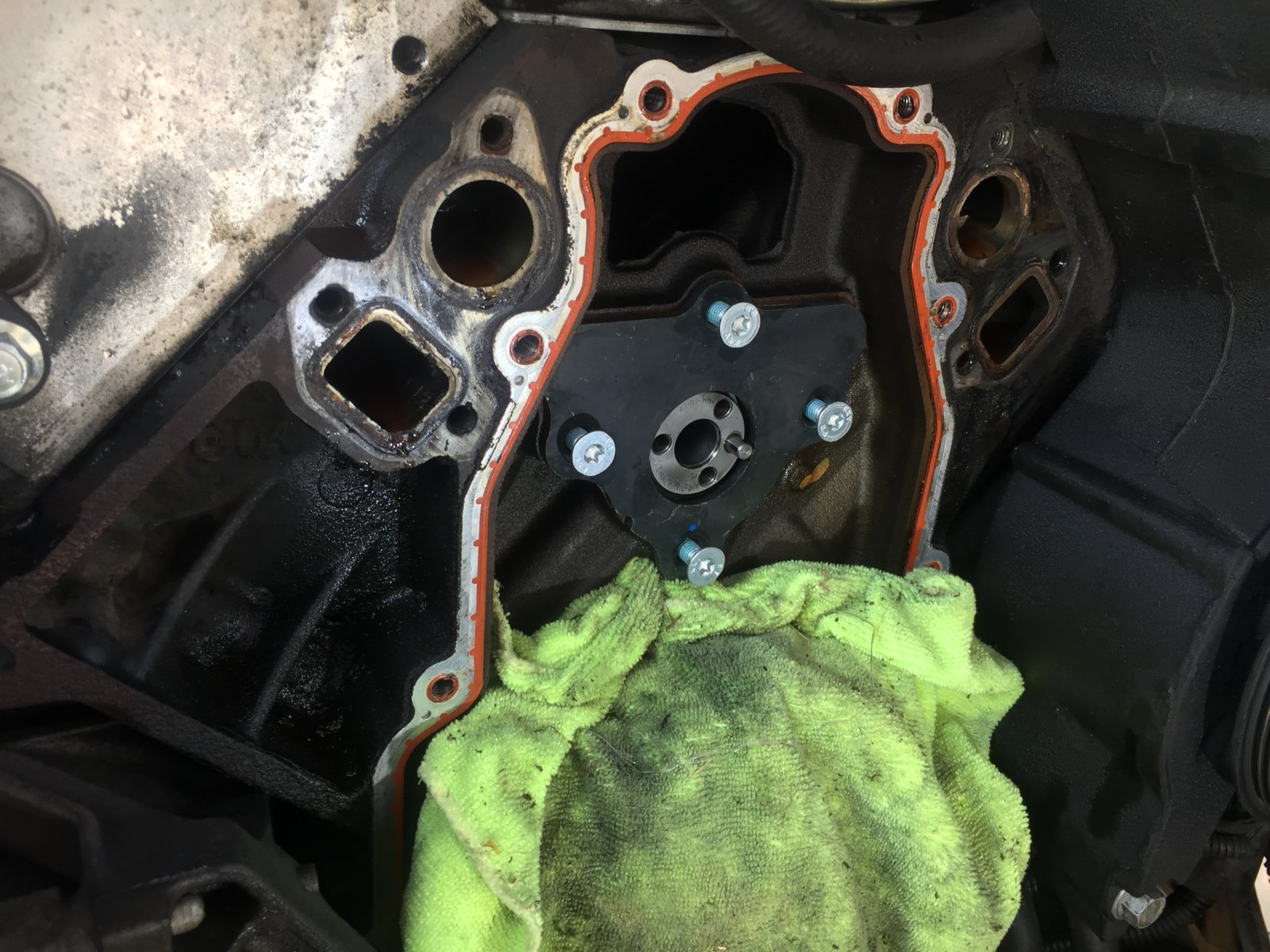

I decided to install the fuel rails and injectors onto the lower intake manifold. In the entire 72 page instruction manual there isn't anything said about this step other than to install the lower manifold with them on it. It was pretty straightforward though although I was a bit confused when I installed the first fuel rail and the mounts were 3/4" above the mounting surface. Then I saw they were adjustable. I believe the idea is to leave them up a little so that when you tighten the install bolts it pulls them down tight, so I left a gap of about 1/8". The bolts that hold the fuel rails are part of the 10 that are used when installing the lower manifold.
26,085
51,100
In the first pic here you can see the adjusting plate. I had ordered harness adapters to connect from the EV6 on the new injectors to the Multec 2 which are on my truck. I didn't know Whipple was sending me a set so I have extra. I like the ones I bought better though since they have split loom so I'll use them.
