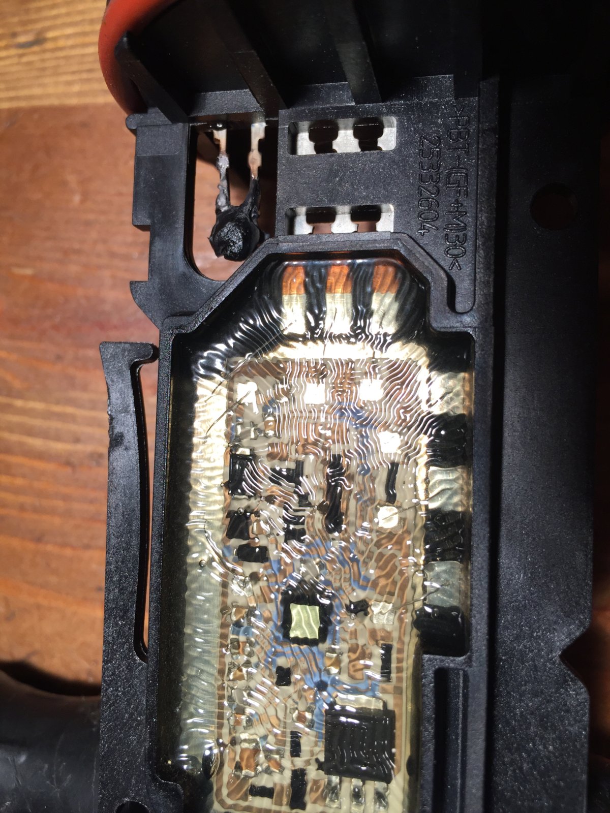

I decided to go look at live data and mess with the IAT sensor. It didn't take me but a minute to decide it was a bad sensor; it read 220 degrees when the truck was cold. I checked the wiring, then unplugged it and it went to -30 like it's supposed to. Went inside and ordered a new sensor. Then I decided to double-check that it was the sensor and the guide I was looking at said to test between pins 1-2 and it has resistance values for temperatures and the sensor showed 120 ohms which meant it should read 220 degrees which it did but it was inside my house and it was 68 not 220 lol. I pulled it out of the housing and there it is- a fried sensor. The thermistor is definitely bad. It's that little crispy black thing that directly connects to the 2 pins.

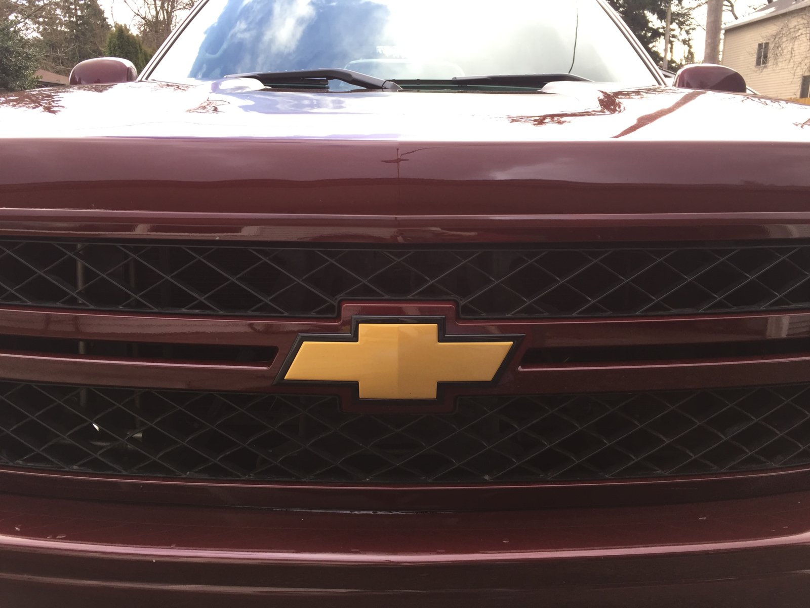

Got a couple clips in for the hood front trim today. Every time I opened the hood the trim would move away from the hood about 1/4" at the center because it was missing clips. It's the little things sometimes. The PO had left a ton of stuff that needs attention after the painters had torn the truck apart. Anyway it's nice and tight now.

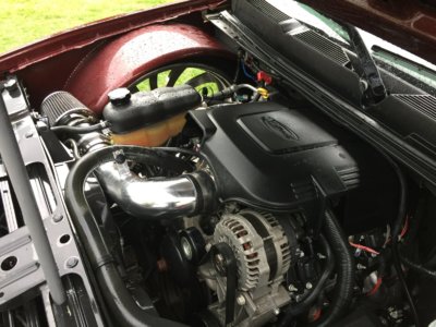

There's no room for the original springs or even the gas shock mod with the tubs. The firewall is tubbed too so it will fit 28's. If you look, you can see they come all the way up to the bottom of the hood where it sits down at the edges where the gas shocks would go. It didn't even have a stick when I bought it. I asked All Star if there was any particular prop rod that works and they say most guys just use a prop stick. I decided a Jeep prop rod would work and it does, perfectly. Plus it stores like it's supposed to and clips into the keeper that came with it when not in use.
