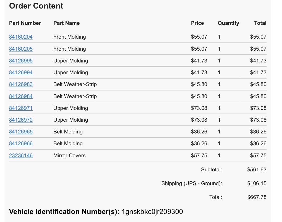

I attempted this about 4 months back. While I was getting my oil changed, I found a blacked out RST on the dealer lot and got the VIN off the windshield, then went to the parts guy at the dealership. After he found the moldings, and priced out all of the trim (let me tell you, this guy was absolutely ecstatic about pricing out these parts), the total came out to well over $500 in parts alone; some of the strips were $120 a piece. And then, to install, you have to take the doors apart because the strips connect on the inside...which would be probably a full day of labor, if not a day and a half...but here is what I found out for part numbers:
22772904
22772905: (R) Molding RR S/D WDO GARN
84160204
84160205
84126995: (R) Molding RR S/D WDO UPR RVL (BLACK); 84126996: (L) Molding RR S/D WDO UPR RVL (BLACK)
84126994
84126983: (L) Molding RR S/D WDO BELT RVL (BLACK); 84126982: (R) Molding RR S/D WDO BELT RVL (BLACK)
84126984
84126965: (L) Molding FRT S/D WDO BELT RVL (BLACK)
84126966: (R) Molding FRT S/D WDO BELT RVL (BLACK)
84126971: (L) Molding FRT S/D WDO UPR RVL (BLACK)
84126972: (R) Molding FRT S/D WDO UPR RVL
