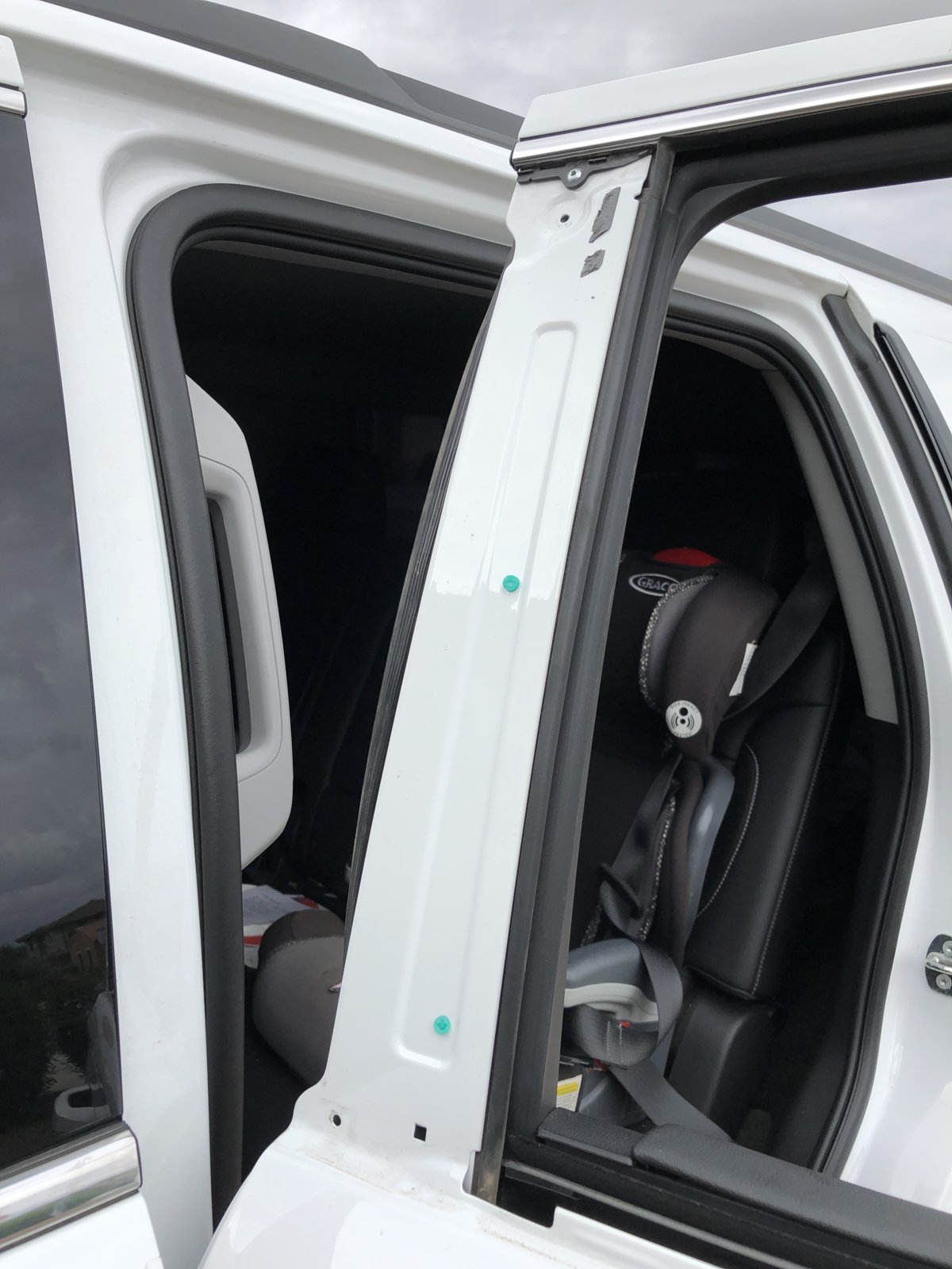

Now is when it gets a little tricky. GENTLY pull the very bottom of the vertical trim piece outward to release the bottom clip, and rotate it from the bottom away from the car. It won't move easily so be careful and once the bottom is released, keep it as close as possible to the door. The phillips screw which you took out earlier holds the top of it, and there are two clips in the middle which you'll see in the next couple pics.

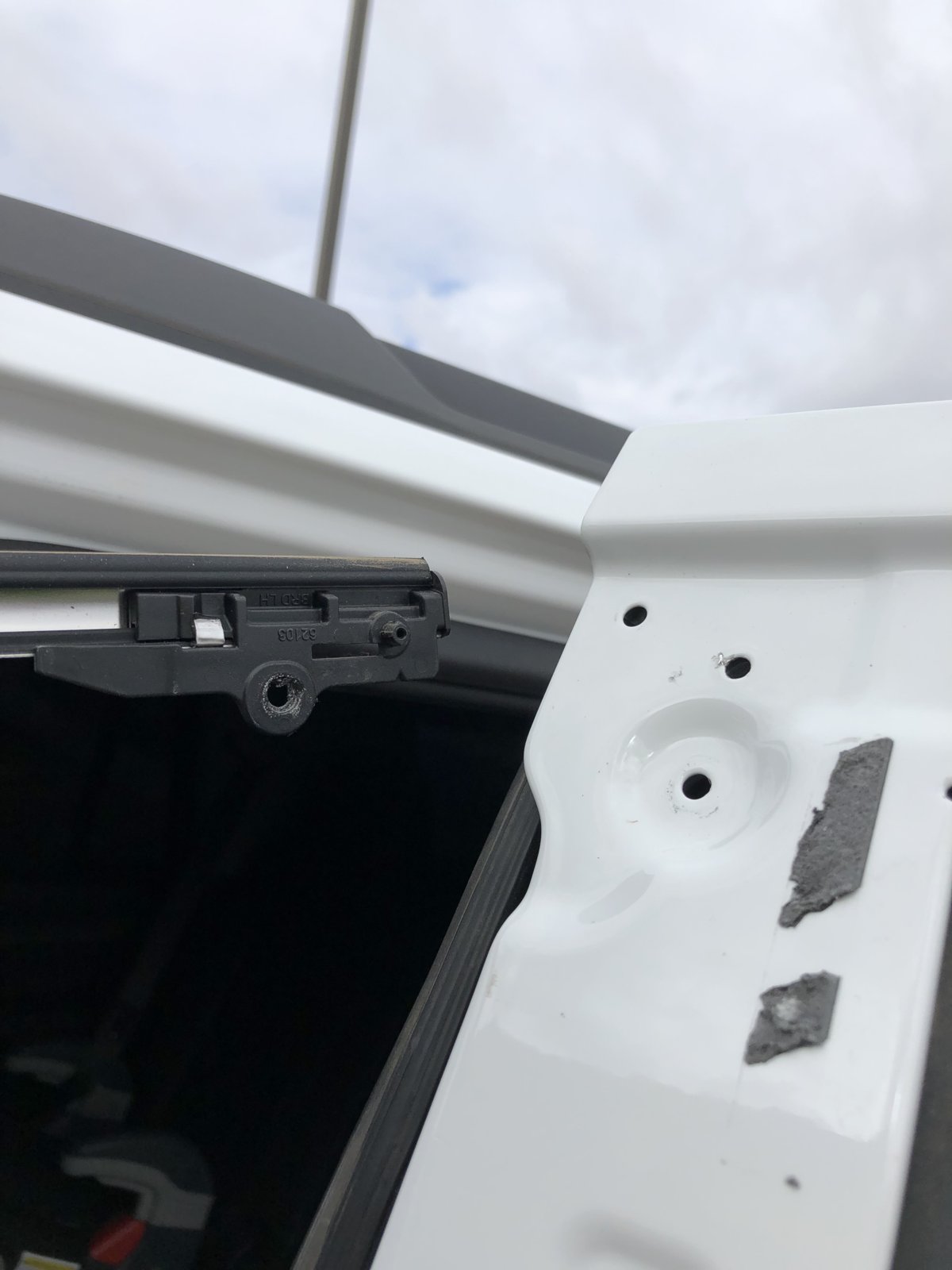

If you did it successfully, you will leave two green buttons on the door. (this is the only door I managed to leave both of them in BTW). If you break one or both, don't sweat it. One will work just fine and if both are broken just use some 3M molding tape when you reinstall it (the red backed tape not the foam stuff). Notice the upper molding rivet at the top which you will have to drill out (it's easy).

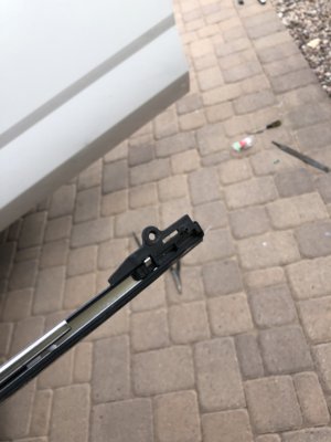

Here is the back of the vertical piece that was just removed. Those green buttons slide into the claws. I had one or two claws break off, but that was remedied by the 3M tape.

Do the same routine for the inner vertical trim price. Just rotate it the opposite way. You'll see another rivet at the top that needs to be drilled out.
Drill em.

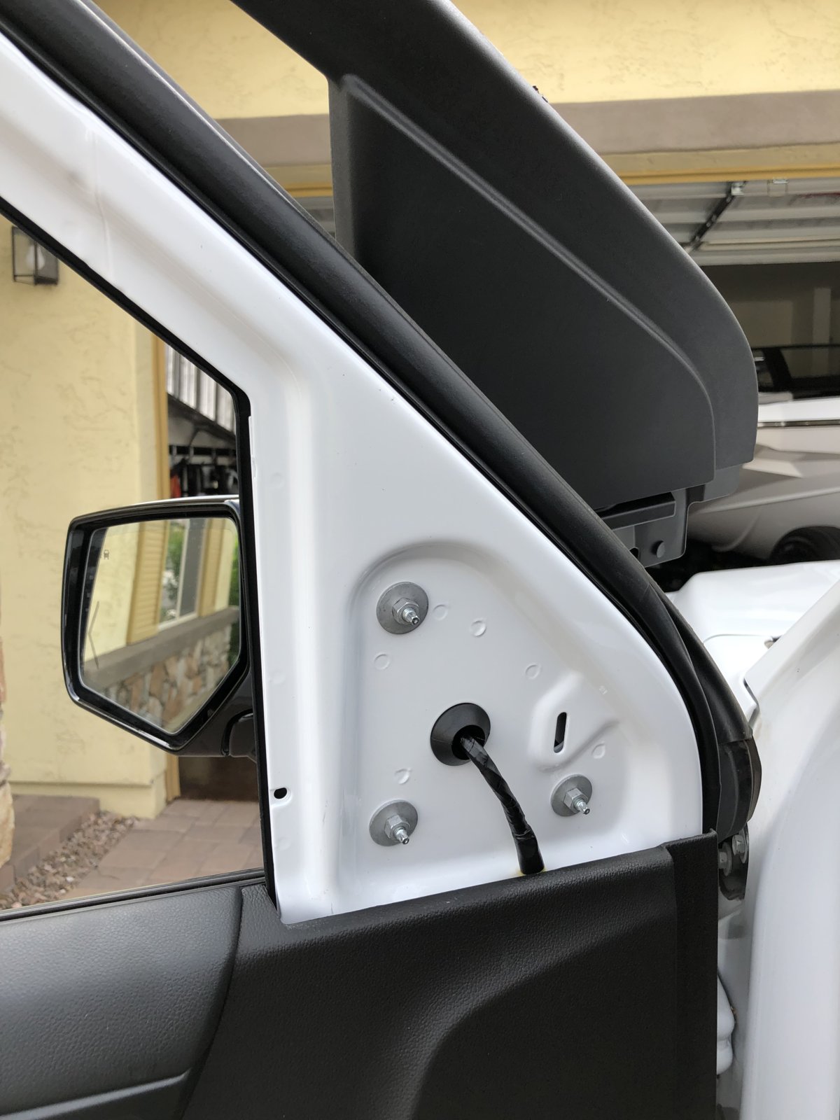

Finagle the interior window trim to reveal the mirror bolts. Loosen with a 10mm.

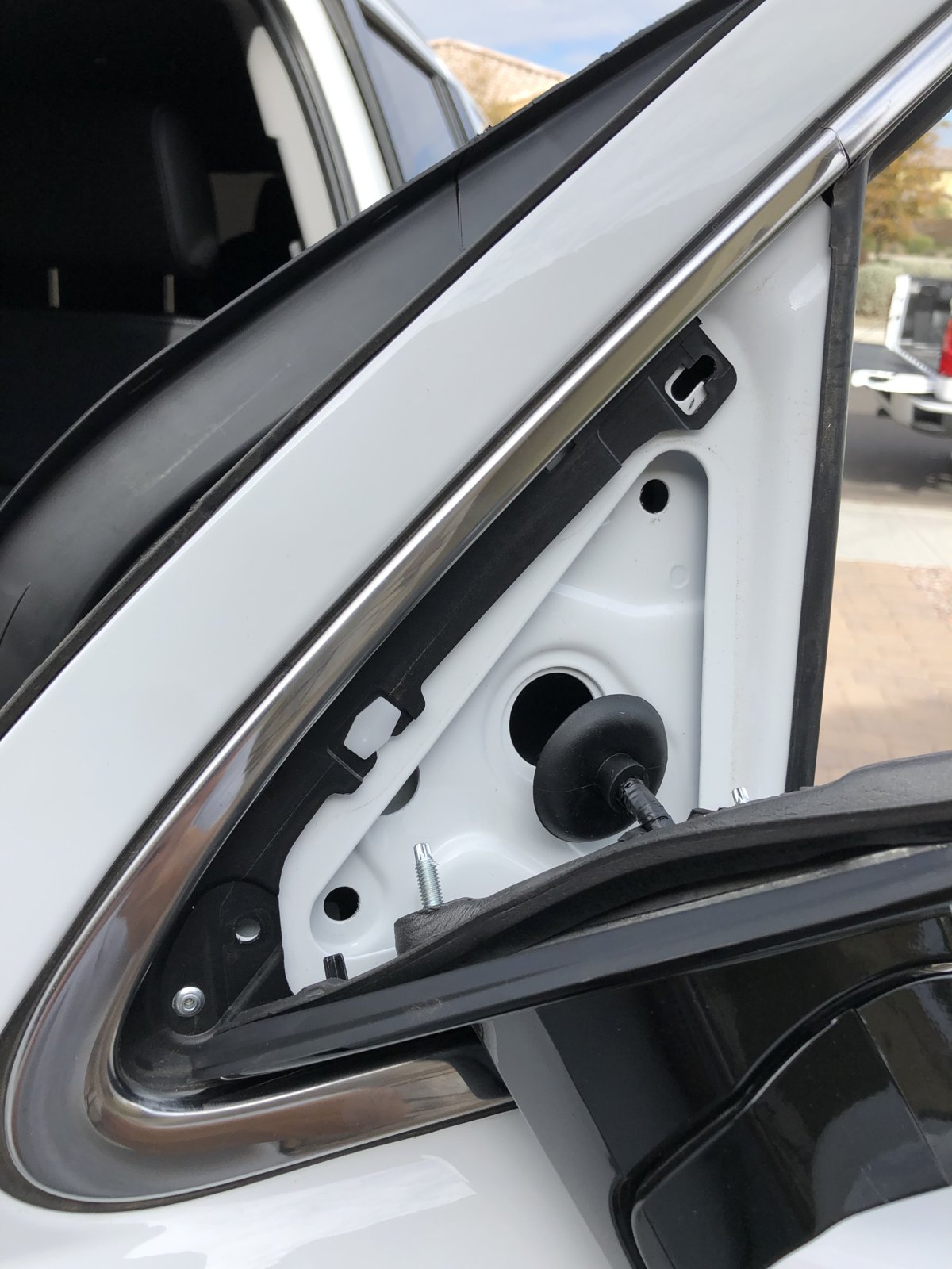

Aside from the three bolts, the mirror is clipped in at the top. Gently pry it to release. Here you'll see a rivet that needs to be drilled. There are also two clips holding the trim piece on.

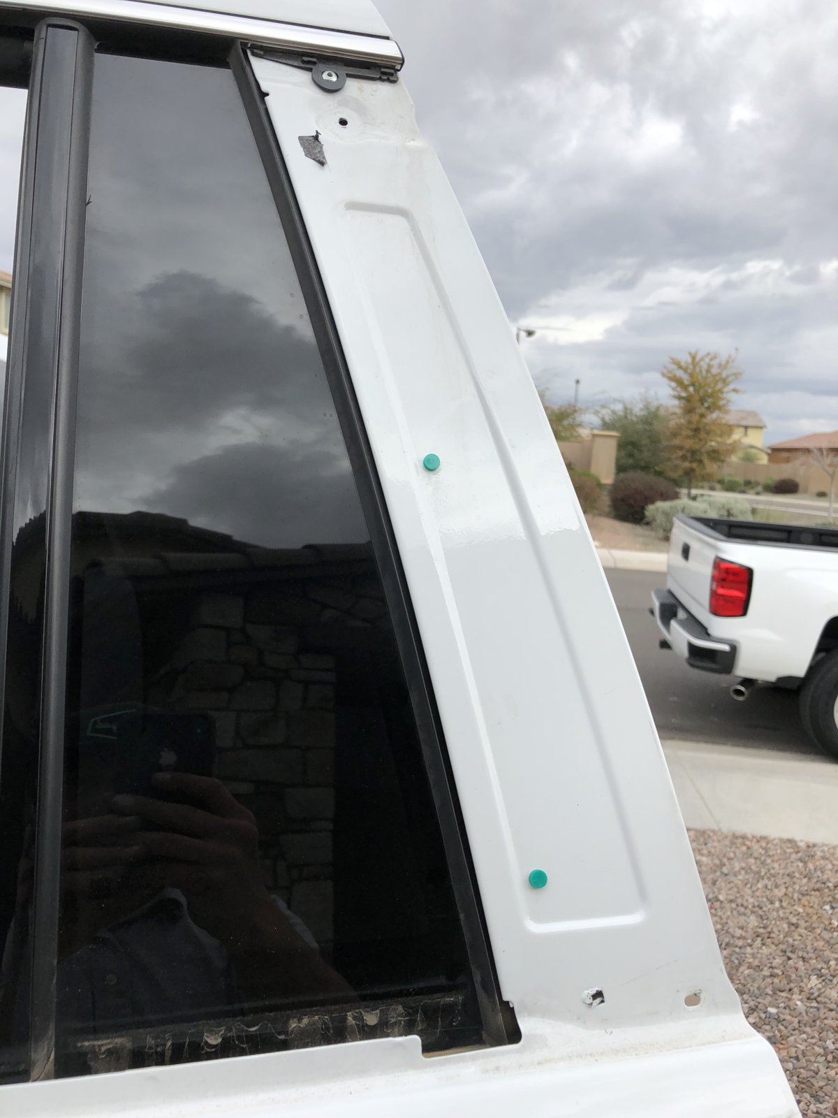

Here you'll find the same scenario as the rear door with the vertical trim piece, green buttons, and a rivet to be drilled out.

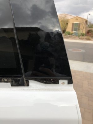

Great write up but very pricey... Any do wrap and how much was it to wrap??
