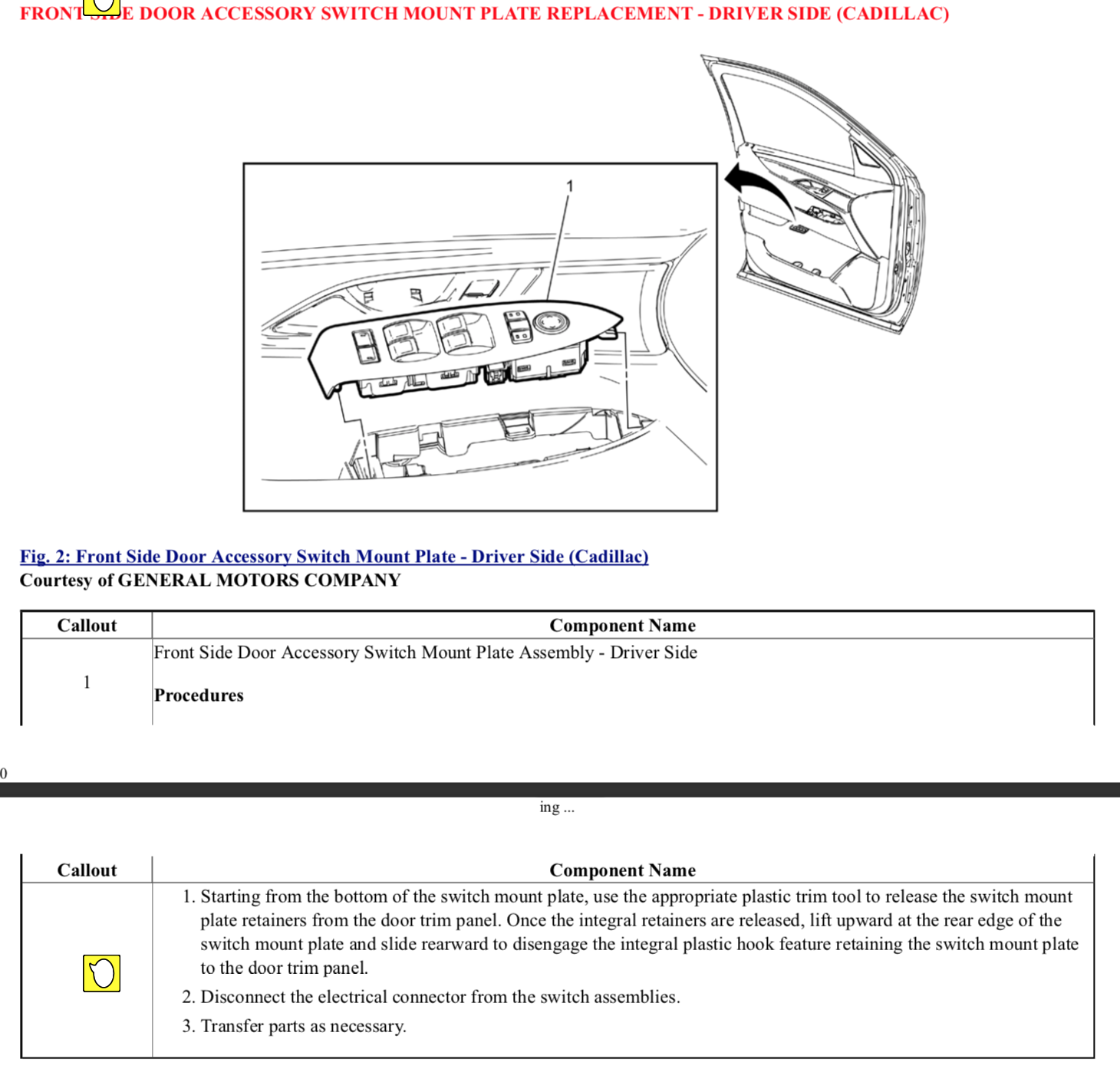

yea, I'm was going to check the switch, just looking for repair manual for 2016 Tahoe that details the removal process. It's a bit more complicated of a mechanism then I thought...

Doesn't look like it's a simply button replacement, the button is a simple switch which leaves me to believe the issue is further down the line and perhaps somewhere within the control module... which stink because the control module is money. Pretty crappy design that if the electrical system that controls the locking mechanism fails, it doesn't fail open or allow for a mechanical override. Wasn't an issue when my kids were a couple years younger...
