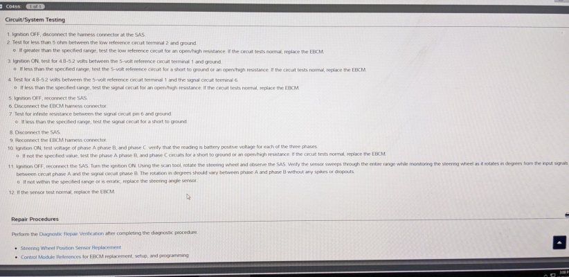

Here’s one example…

So I just went out to my 2007 with my Tech2 to calibrate the steering angle sensor and there is no such option in the Tech2 for these trucks, apparently.
