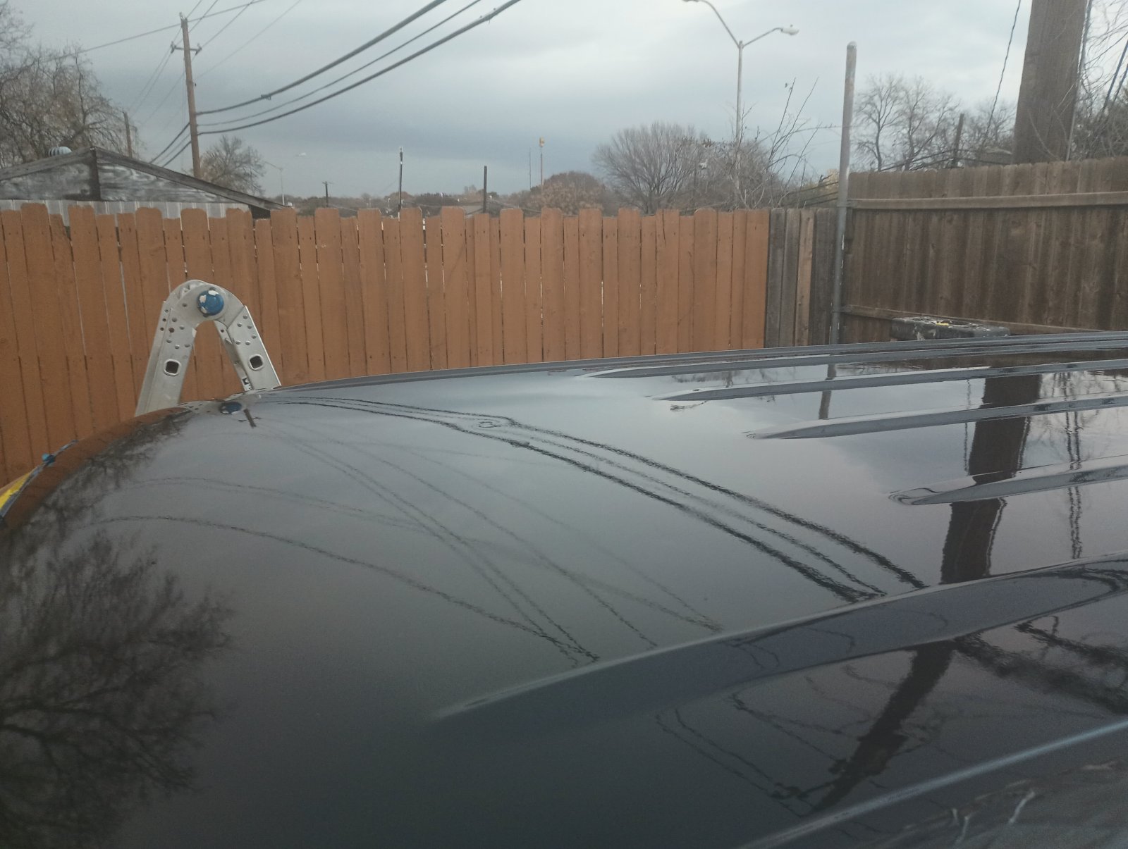

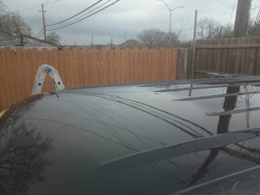

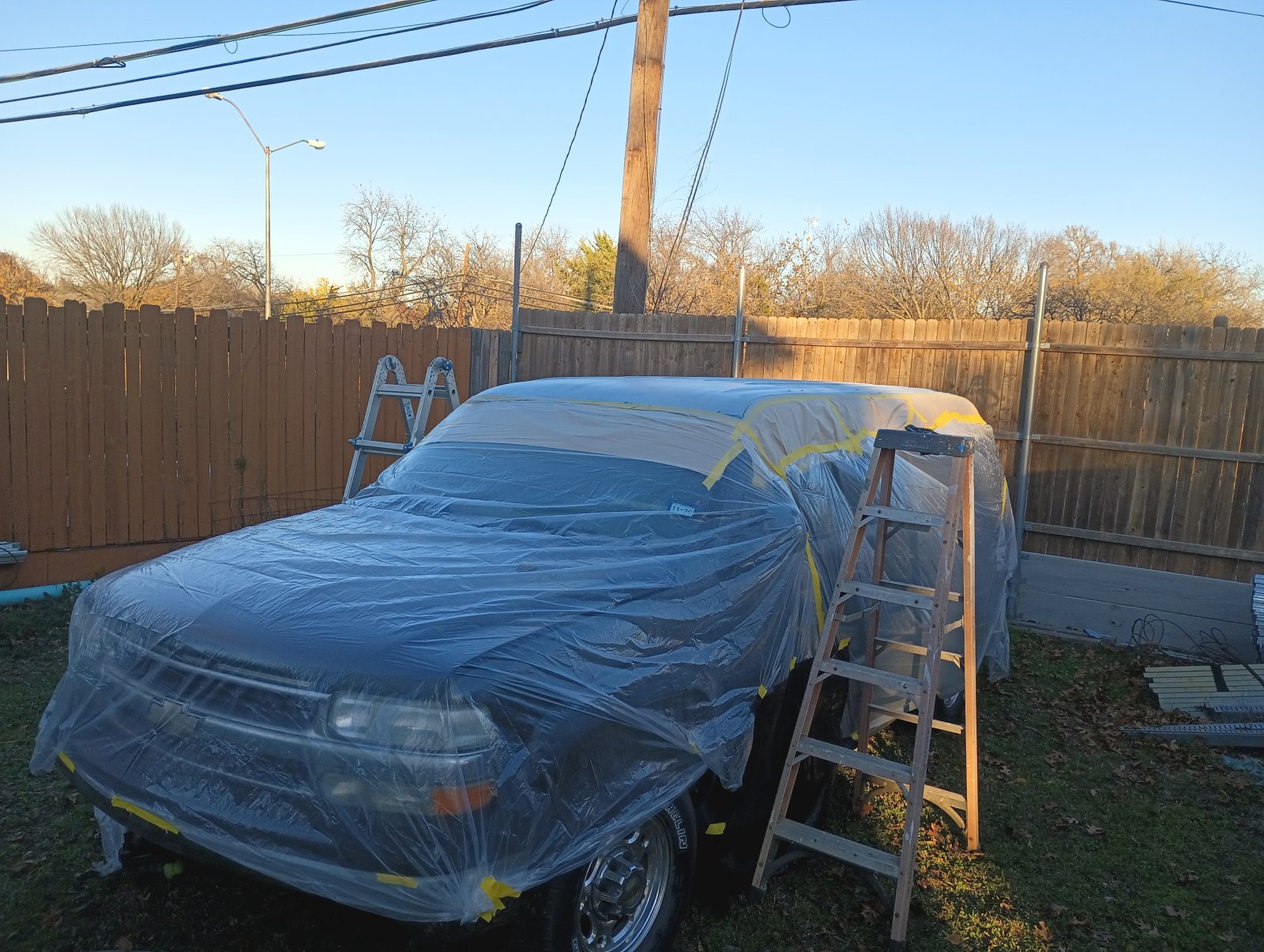

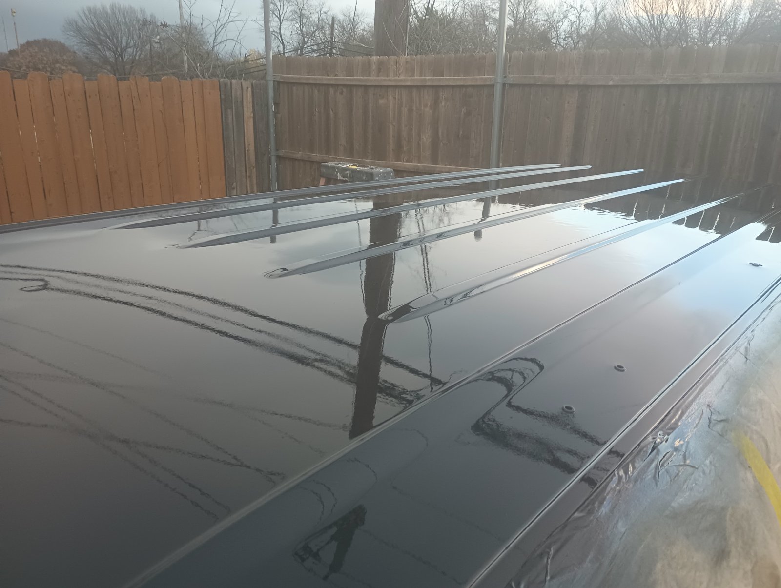

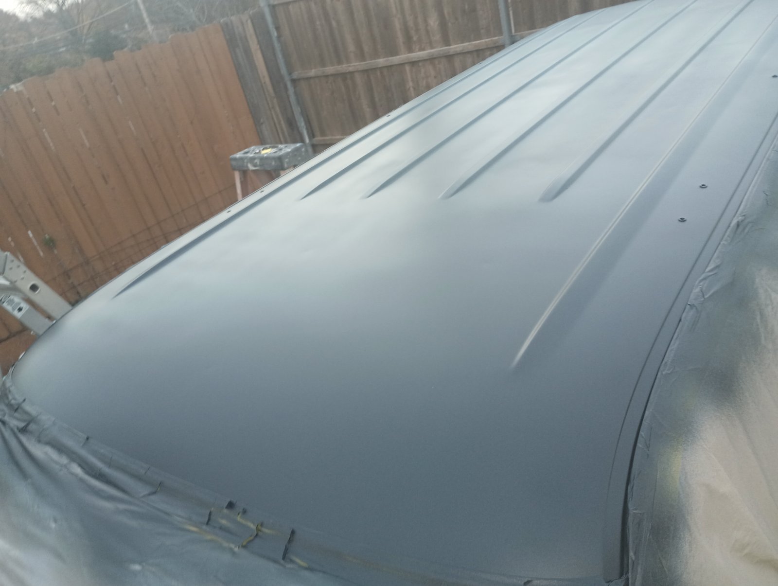

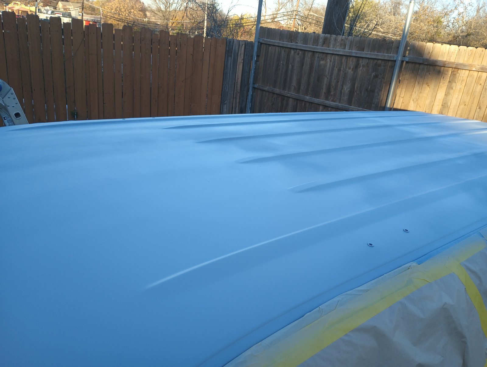

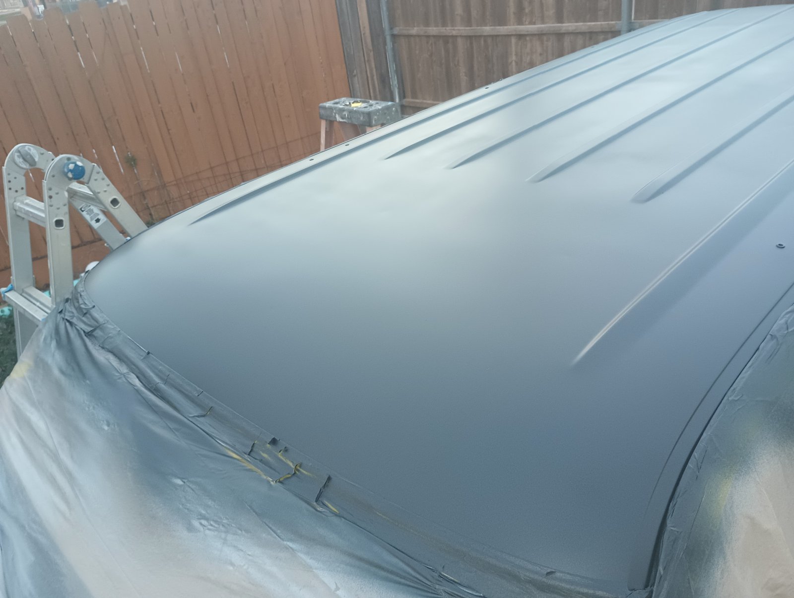

I got the roof sanded and prepped this weekend. The clear was in really rough shape and I wound up pretty much removing all of it off, down to the base and original primer. I used 100, 220 and finished with 360 grit sandpaper on a 5" and 6" ROS electric sanders meant for woodworking. Wasn't too bad, but it's still a large area. Pretty boring work.
Last night I had to hurry up and used an aerosol self etching primer to spot prime the areas with bare metal burn through, as we have been getting dew overnight here and didn't want those bright metal areas to flash rust.
