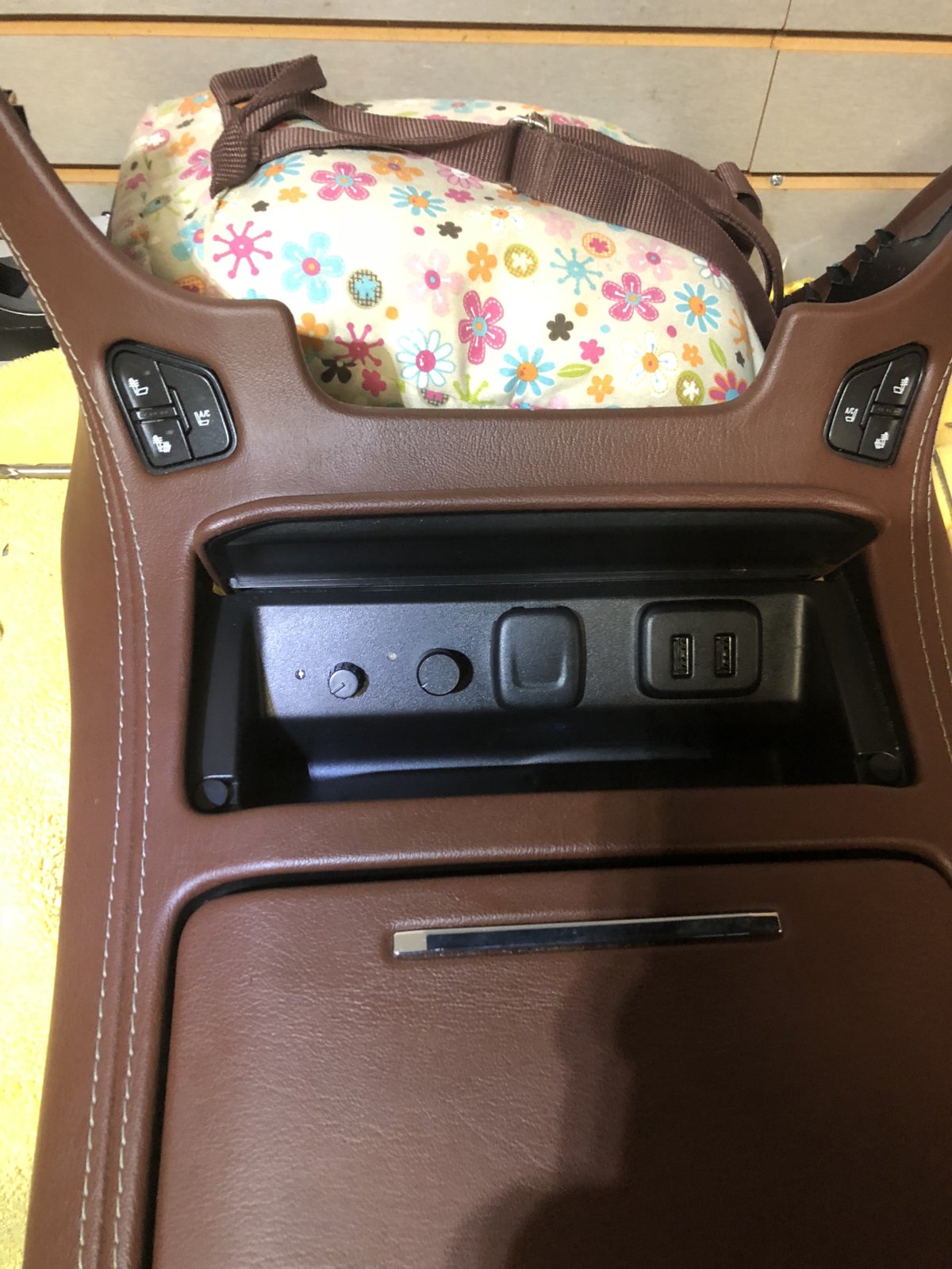

I am doing the same thing. Where did you tapped your wires for the lc2i

Have you adjusted your LC?
When you say it does nothing.... what are you referring to?
Do you have power to your LC? You also have to ground it too. You can tap into the power wire on the factory amp plug to power the LC. Then you can use the bottom bolt on the factory amp to ground your LC.
