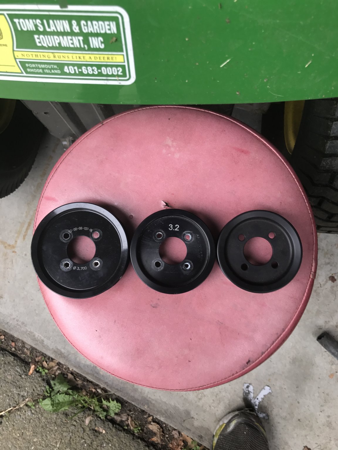

u just have stock maggie pulley?
i have heard/read that headers lose 2# of boost. & peeps recommend starting w/ a pulley 2 sizes down to get back to 6 psi
According to dyno, I still pulled 7 pounds no problem.
Those headers are making me drool by the way... pure quality craftsmanship there. Pre-family I wouldn't think twice about em, but with the little ones etc etc, I didn't even want to go with the corsa sport but rather the touring... so I guess the trade off is no headers and the sport, bummer because those sound amazing... glad to hear my blower isn't alone when it comes to volume of whine! I swear my MP-112 Maggie on my SS was quieter! Fine by me because I love it! Great job man, that truck looks and sounds absolutely awesome
I got little ones too. The only thing I considered and glad I did was went with the catted version. Emission and smell stuff like that. You gotta hear this. I'm running ARH header, stock 2.75 cat back, magnaflow muffler and resonator delete. I was going to changed to 3 inch but dyno convinced me I don't need to. Sounds perfect the way it is.

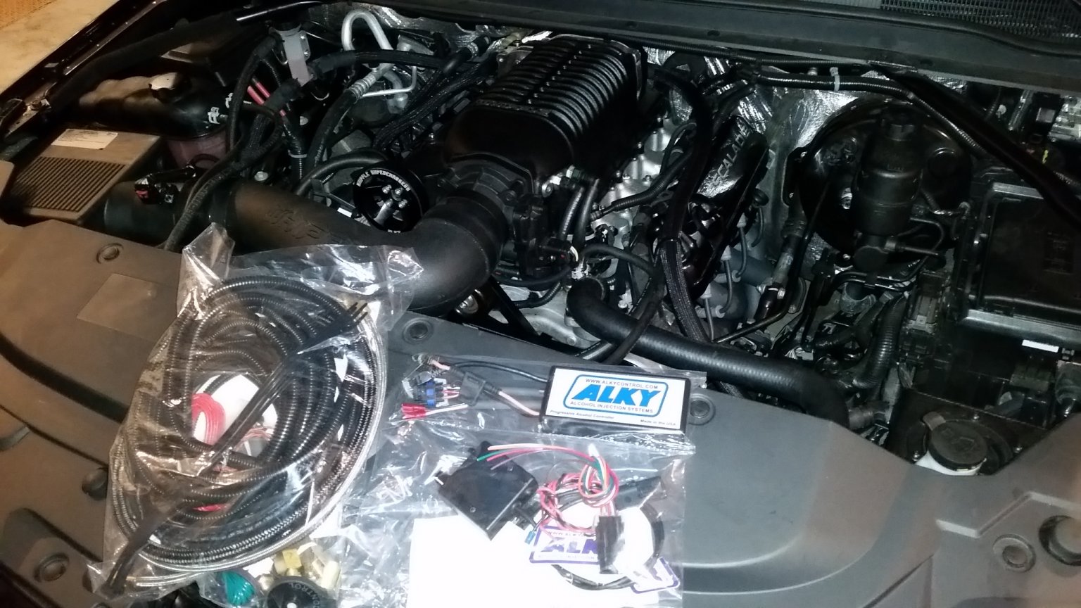

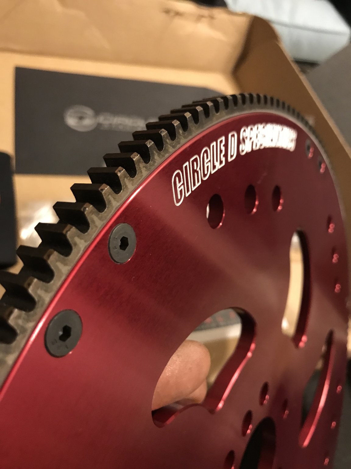

Shucks. Look what arrived today too. I kinda hoping to see about that 15hp gain @5k claim. Oh well, next dyno
