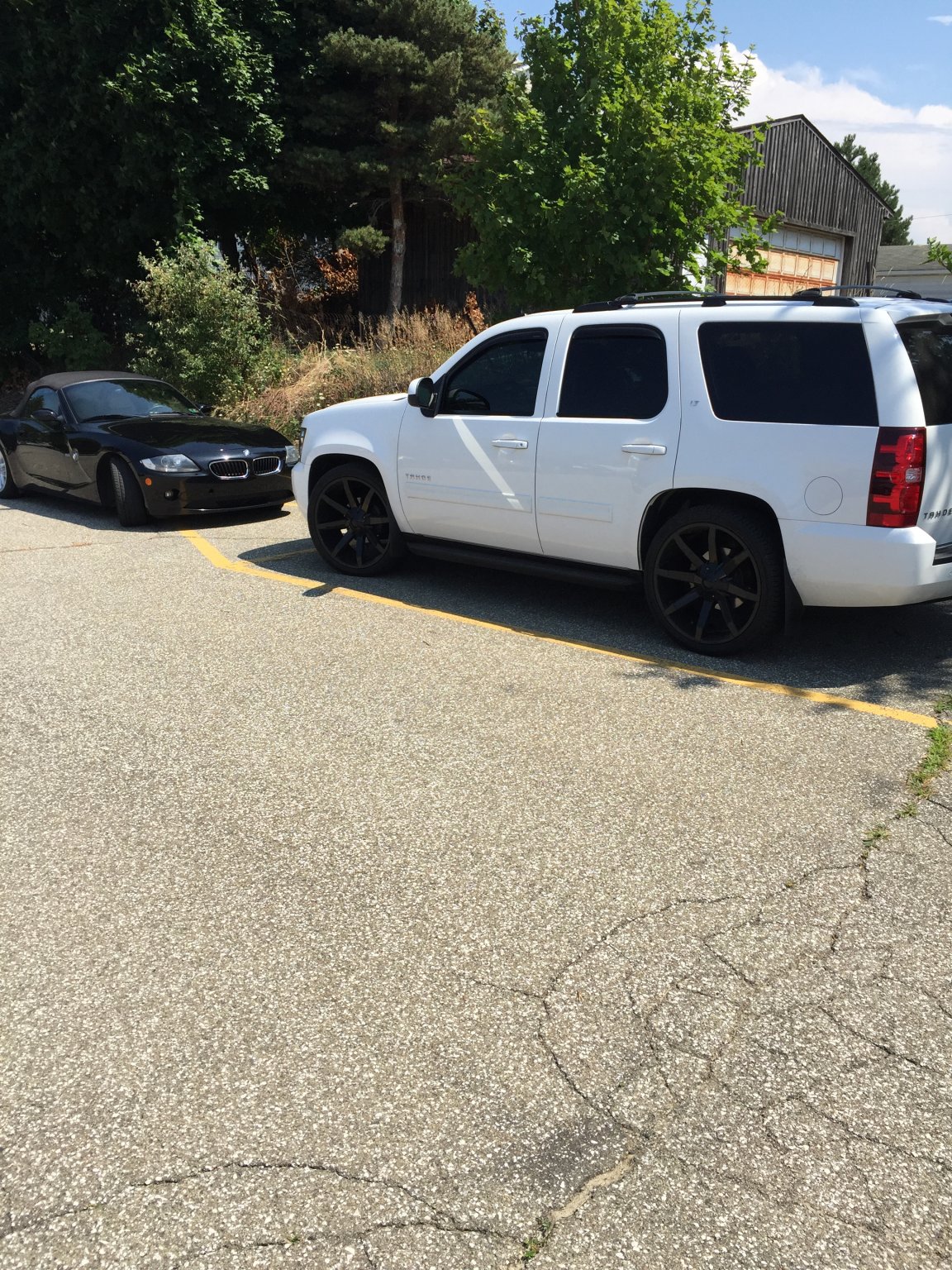

Here is my 2013 LT with 2" drop both front and back with 24" wheels. Did the OEM struts with 2" drop spindles in front to keep alignment stock. 2" drop coils in back. Runs great both on highways and city streets but I also only have little under 13k miles on truck.

Thanks, I don't think I'd go bigger than stock on the wheels, was probably looking at getting a set of steelies because of how bad the city streets I drive on actually are but that's a nice looking truck. I have almost 63k on mine and the body roll/ instability/ handling characteristics are just not what they should be. Good to hear that ride quality hasn't suffered with the drop and wheels though.
