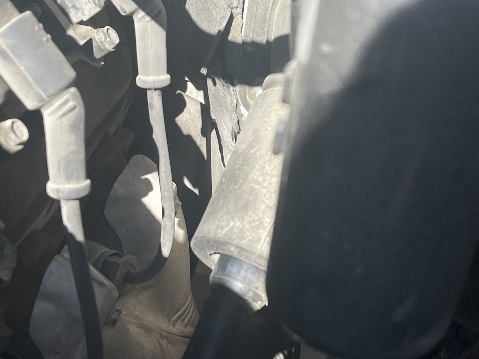

I was just about to ask you why you think you need a jack and stands but decided to take a quick look under my hood to see if I could get to the rear dr side exhaust stud to install the clamp without having to take the wheel or exhaust off.
Low and behold I just 'discovered' that I also have a missing bolt/nut at that location!
Note the last bolt hole location - nothing's there.
For what it's worth, I also have no soot or other signs of leakage other than the tick sound - the same tick I hear in your video.
Again, I could be wrong (and its worth checking just to be sure as @wjburken suggested) but I don't think your flex plate is broken.
I think it's your missing stud/nut or bolt (or whatever the hell goes there).
I guess we both have clamps to install...
