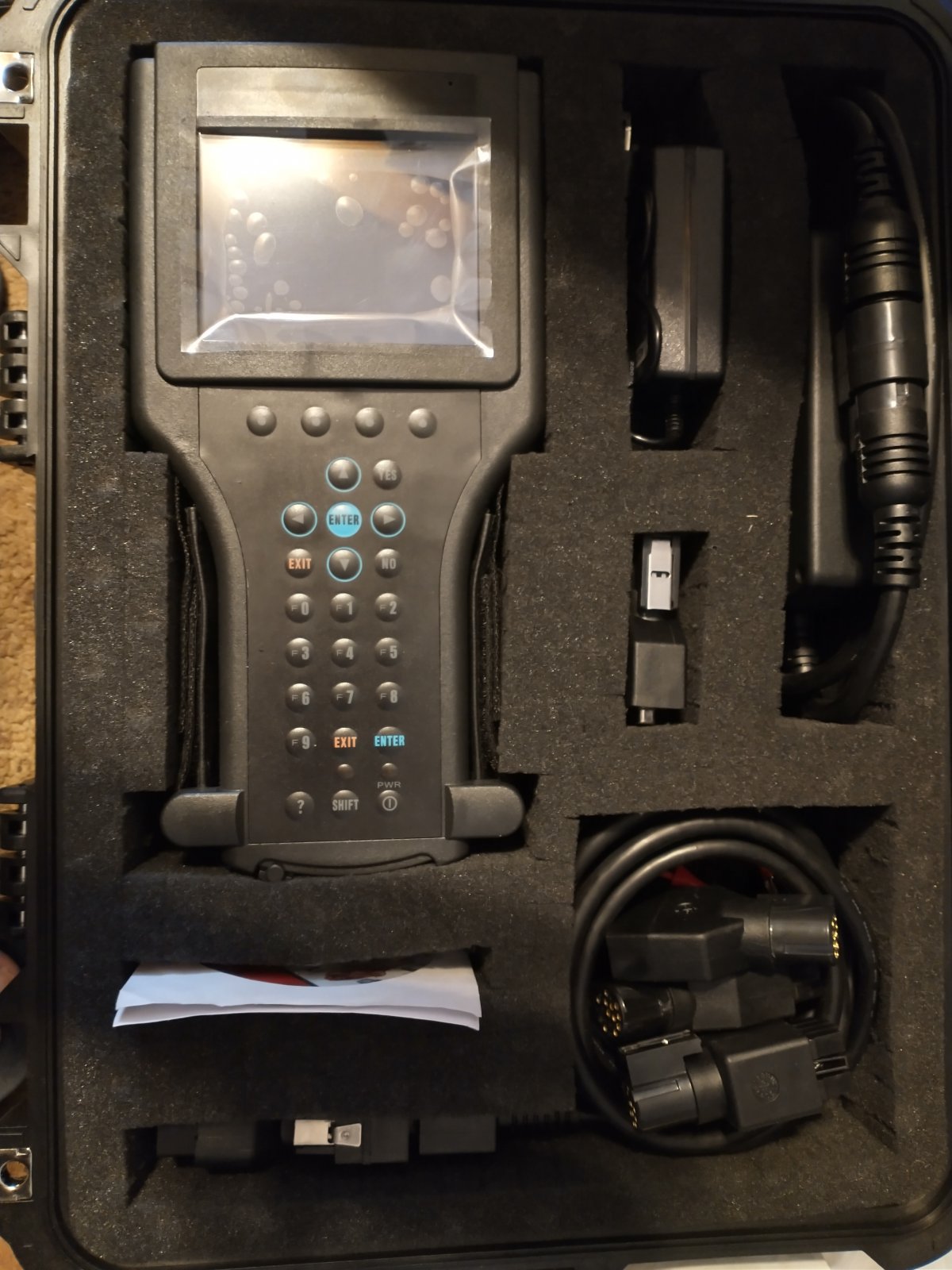

You do not NEED the CDs. You need the PCMCIA card to communicate with a vehicle. It's supposed to go into the slot closest to the screen.
@swathdiver
The card shown below is on the lower slot, do I need to move it to the upper slot?
The software is on the PCMCIA card which might come separate or might already be installed in its slot. The CDs are pretty much worthless but I believe one of them has explanations on basic setup like inserting the PCMCIA card and such. You can Google it though.
@Rocket Man
Is this the PCMCIA card?
20,164
27,511
@swathdiver
@Rocket Man
To answer the question posed to Mark, yes, that is the PCMCIA card and it goes in the slot closest to the screen. The instructions mention this but I also know because I moved mine to the other slot for convenience and it works fine with CanBus systems like the GMT-900 but the Tech-2 would not talk to my Pontiac Montana or some fellow members' GMT800s until I moved it back to the other slot. I believe that is because the 800s and the like communicate through the VCI Module and think mine has plumb wore out and only acts as a pass-thru now.
Got it, I will move it over and keep tinkering with it. Thx @swathdiver

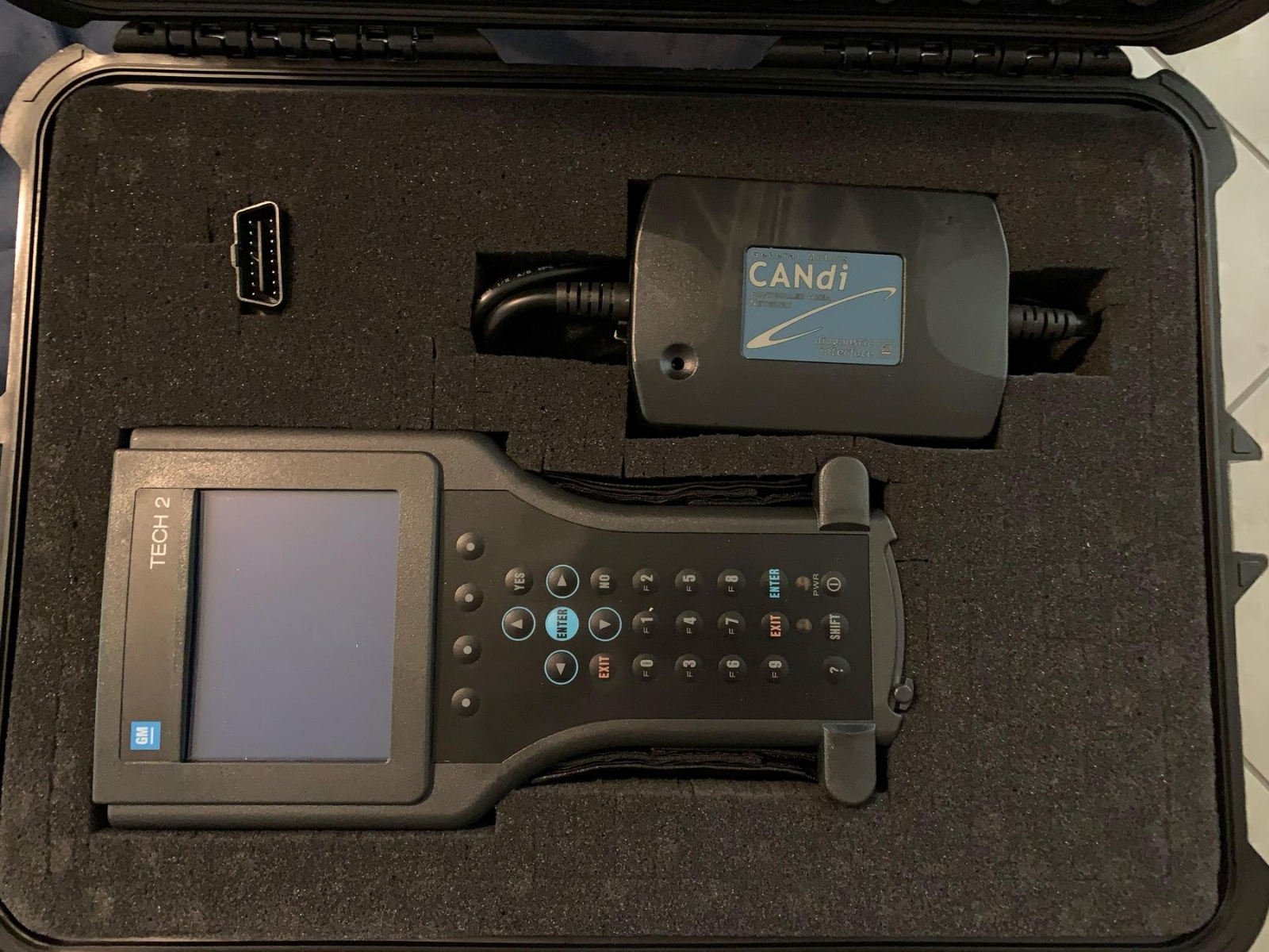

Just thought I would post this here...
https://www.chinacardiags.com/whole...or-gm-saab-opel-suzuki-isuzu-holden-1011.html
They have the Tech 2 with a case and all accessories for $289 with "Free" shipping.
They also have the Tech 2 with all the accessories but without a case for $215 BUT they charge $68 for shipping.
I opted to pay the extra $6 and get the case and the "Free" shipping.
Waiting to see how long it takes to receive it.
Anyway, I thought it was a pretty decent deal so I figured I would share.
