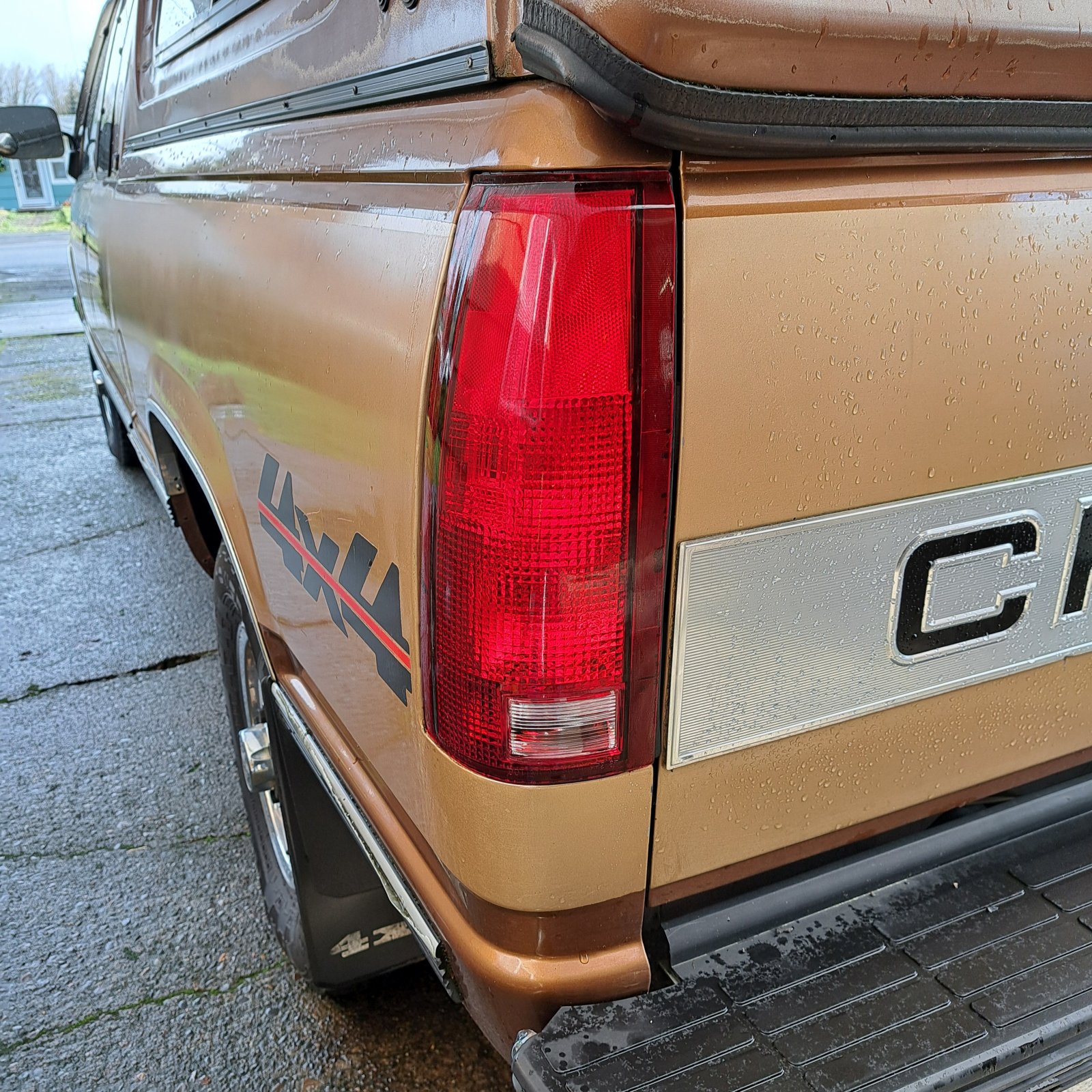

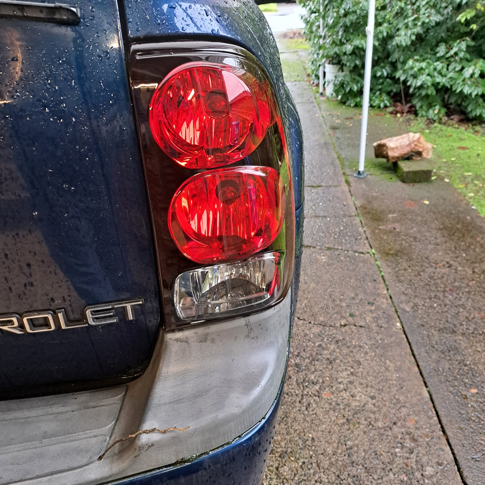

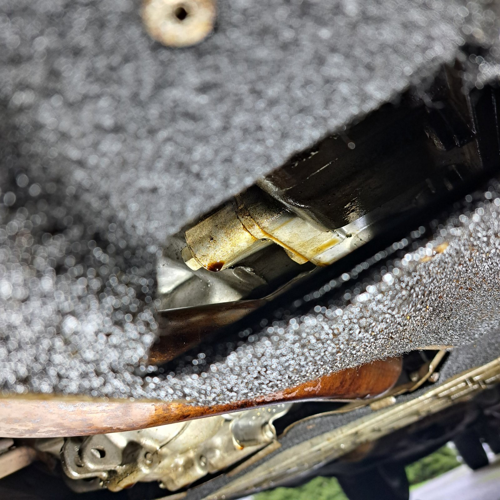

Picked up the 05 GMC Sierra Duramax today and brought here for inspection. Gobs of the Duramax power and smooth transmission shifts. Looked under hood and found slight seepage at the hydro-boost where the master cylinder bolts on. The master cylinder looks dry but the booster does have some wet on it. Steering gear has slight seepage at the shaft. Rear diff cover lower half shows seepage and has the dark brown wet dirt. Both front axle seals leak at the stub shafts. One is a leak, the other is seepage. Rock chip at upper 1/3 of p/s w/s.

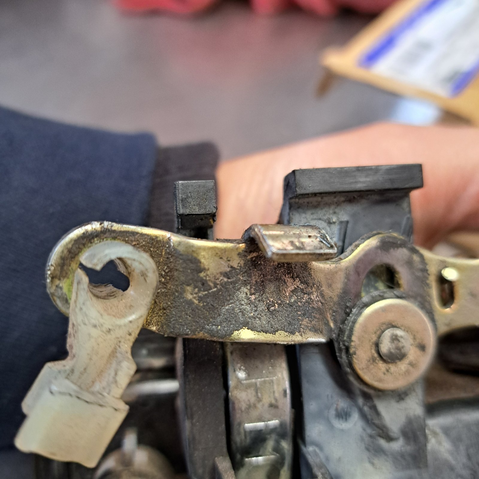

Was all set to take it back and tried all the windows. The left rear went right down but stopped 1/2 way up. Went back down easy and then 1/2 way up and stopped but could hear a grinding crackling noise. No matter how I tried to help it up, it was stuck. Called him. said what I expected, "Worked fine the last time I used it". That could have been years ago. Back window of a crew cab and he can only get around with a rolling walker. Removed the inside door cover and tried it again and narrowed down the noise to where the cables go in and out of the motor housing. Then I found it. The cable is coming apart. See pics. I unhooked the window and taped it up so would no rain in and showed the guy the pics. He is having me fix that. I estimated the parts and labor for the rest of the work and with the broken mirror, the dent in chrome at left rear bumper and the dent under the right rear taillight. I explained that at best it is FAIR condition at KBB and figuring in the cost of the listed repairs, I offered him $4k cash. He does not get around and may likely get more at CL but then he has to deal with the crazy buyers and no shows and and and.......His son does not want the truck either.
