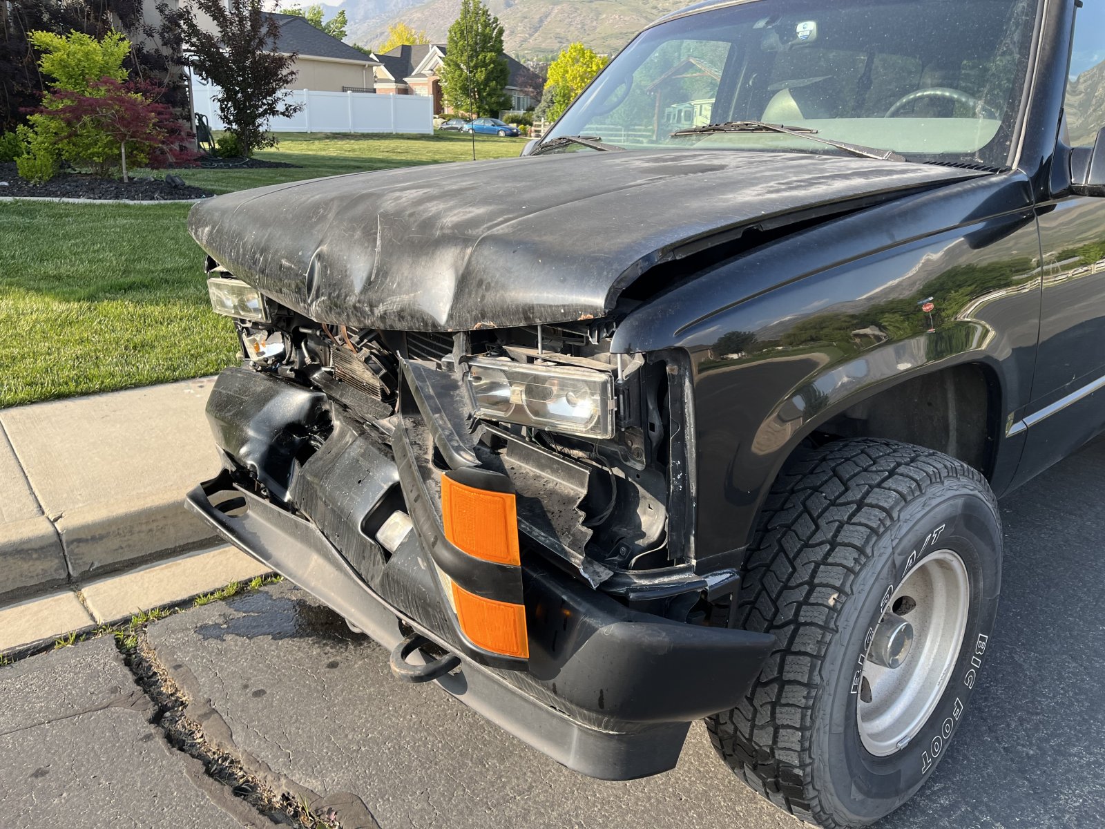

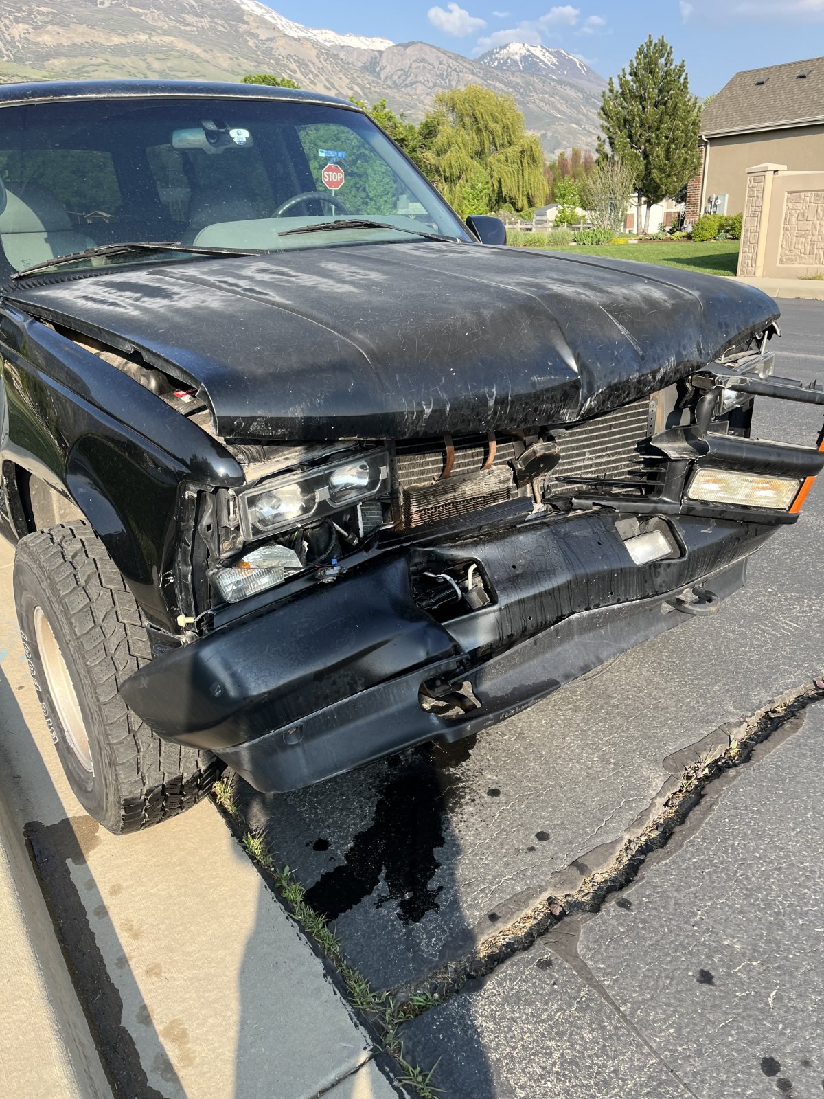

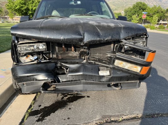

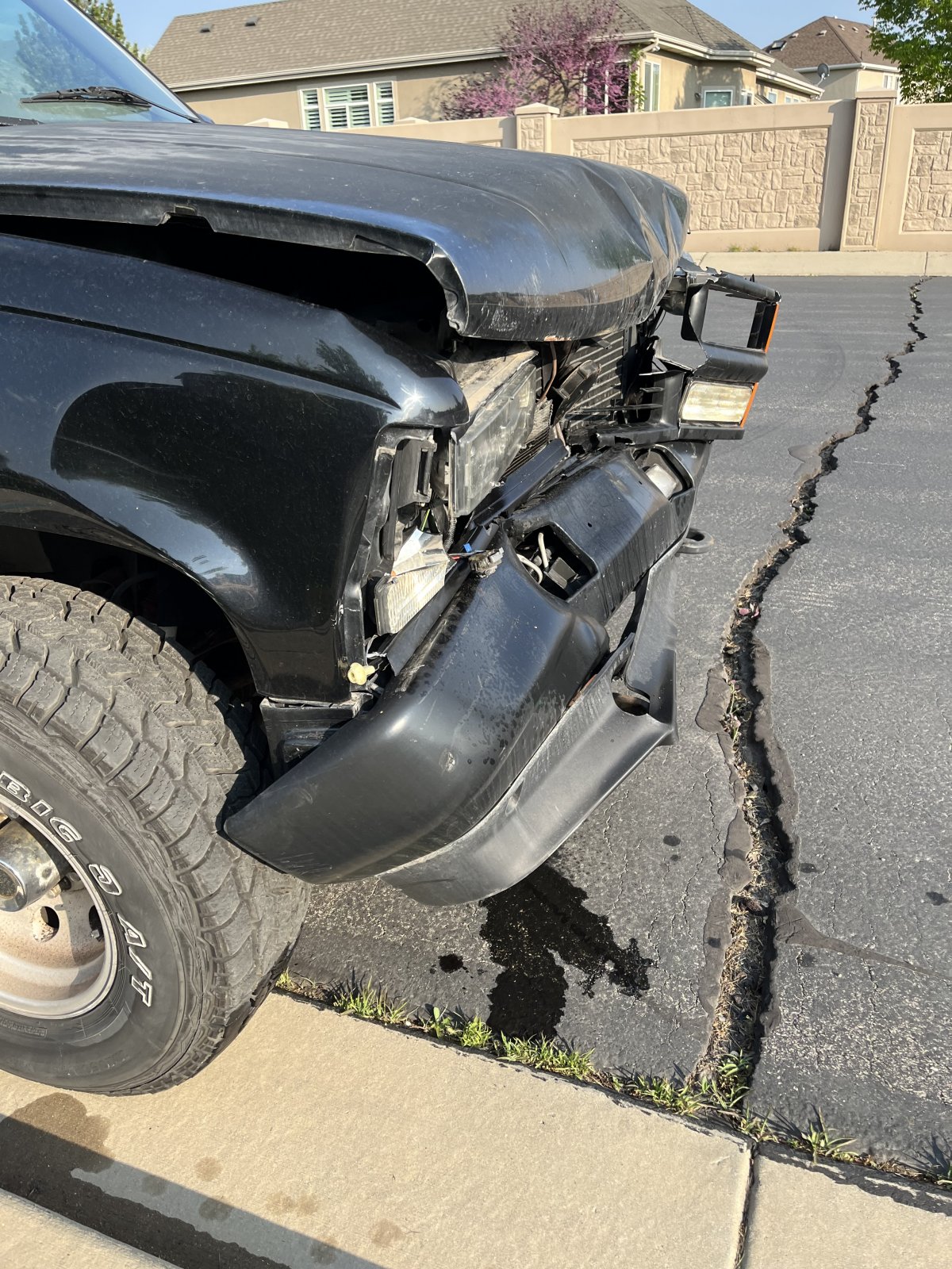

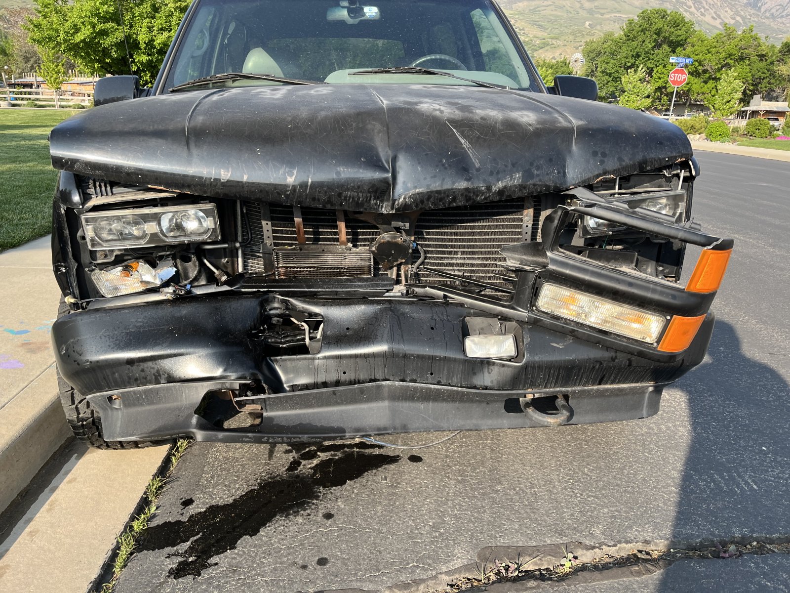

I had just finished all the mechanical things and had it running perfect, just swapped to the MPFI.. things were good. Let my 17yr old take it to school for 2 weeks, the. She runs into a car in front of her.. At first look, yeah it needs a hood, fenders core support, bumper, radiator, exct.

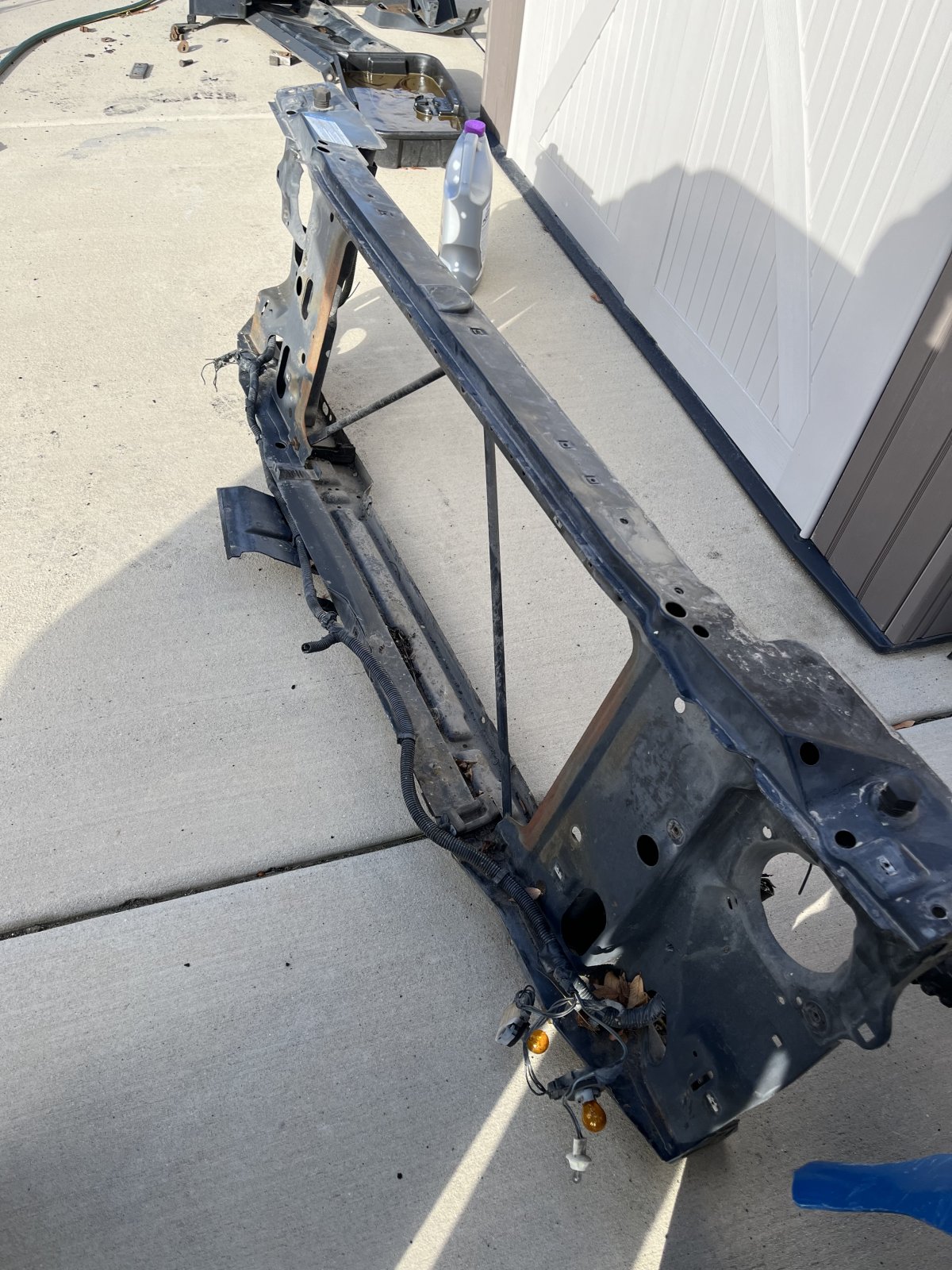

Tore it all to pieces only to see the passenger frame horn was bent. Let it sit for a few months trying to decide to fix or trash it. Well I decided to fix it, got on to LMC and ordered everything. Just this week I finally was able to find a shop that #1 was available in a decent time frame, #2 was willing to do it. So right now it’s at the collision ago on a frame machine getting pulled. More to come… this will be my build thread

I am sure the shop will but make sure you get a printout, if has the capabilities for it, of the frame readouts and see if it has a "diamond" in the frame and what the before and after readings are. It will never align correctly if it does. If the damage is all in front of the cross member, you got lucky.

Other car was a 2019 Ford expedition, didn’t really damage that car as much as I thought it would have. According to insurance they paid out $3,200 to fix theirs. So far I have spent $1,100 at LMC, another $400 at Rockauto. Going to do the work myself as I do all my own stuff as much as I can(I can’t do a frame lol)
