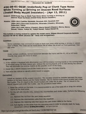

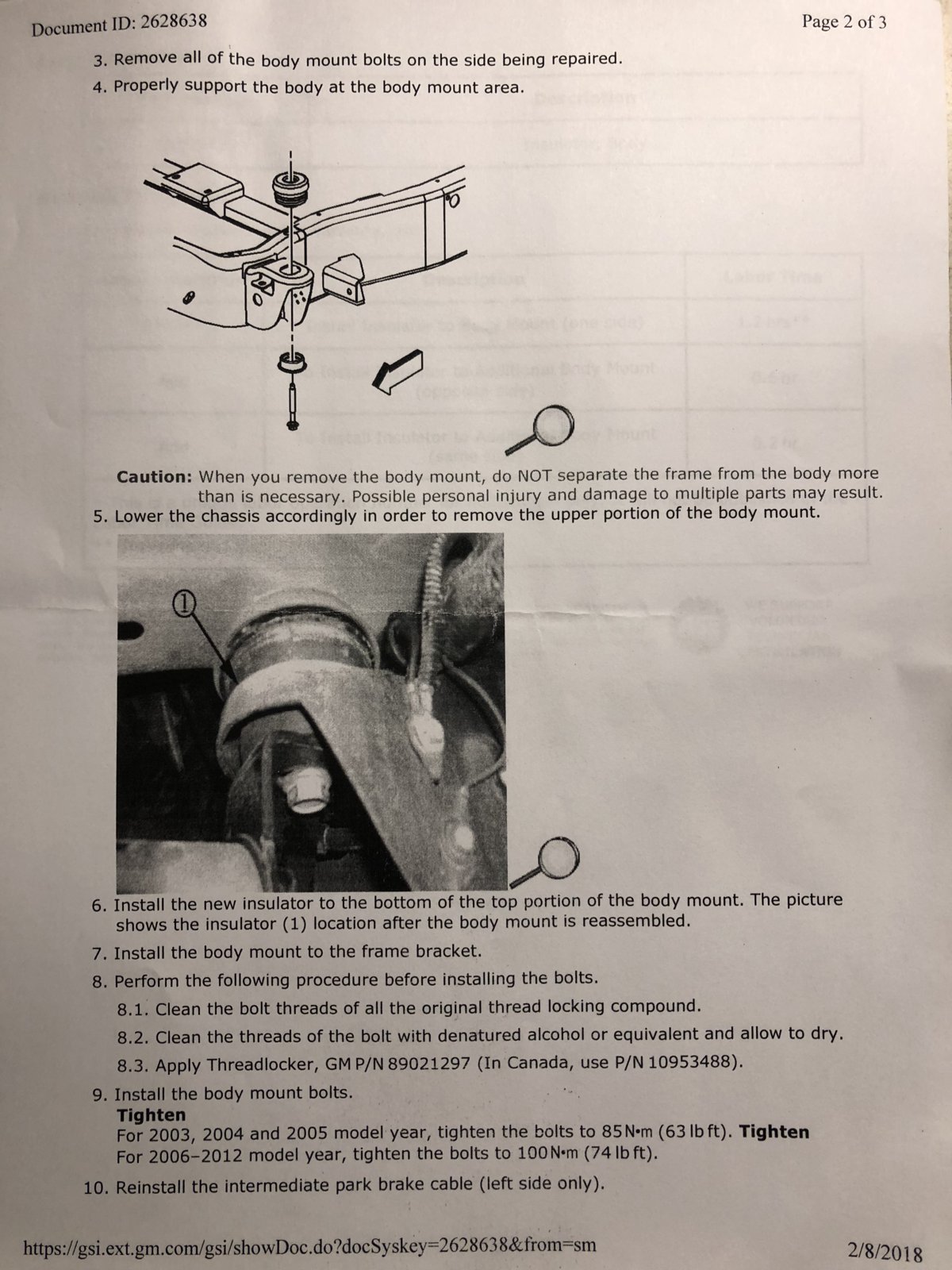

@Doubeleive do you happen to have that TSB for the crossmember?
could be the main support-crossmember under the motor/trans, there was a tsb on the NBS for the same issue, the fix was to replace or swap the bolts around and be sure it was all very tight! mine used to do that and it would drive me crazy, same with the rear torsion bar right behind the rear diff, if that was not tight it would "pop" then it just got so worn out I had to replace it.
