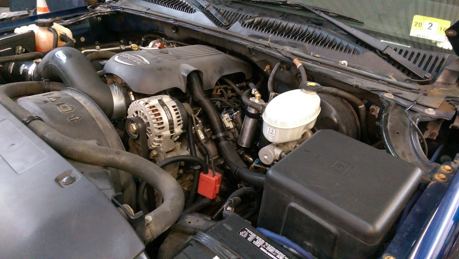

I highly recommend doing the catch can install. Catches all the oil that would go into your dry intake. Easy install. For me, all I did was cut the rubber hose going to my pcv and put the catch can in between it. Added some more hose, and done! Works like a charm. I used an existing bolt coming from the brake booster/ master cylinder, as I hate drilling holes if I don't have to. Added a new pcv, just because. IMAG0482.jpg IMAG0483.jpg IMAG0485.jpgCan doesn't hit or touch anything. Perfect spot for me.
