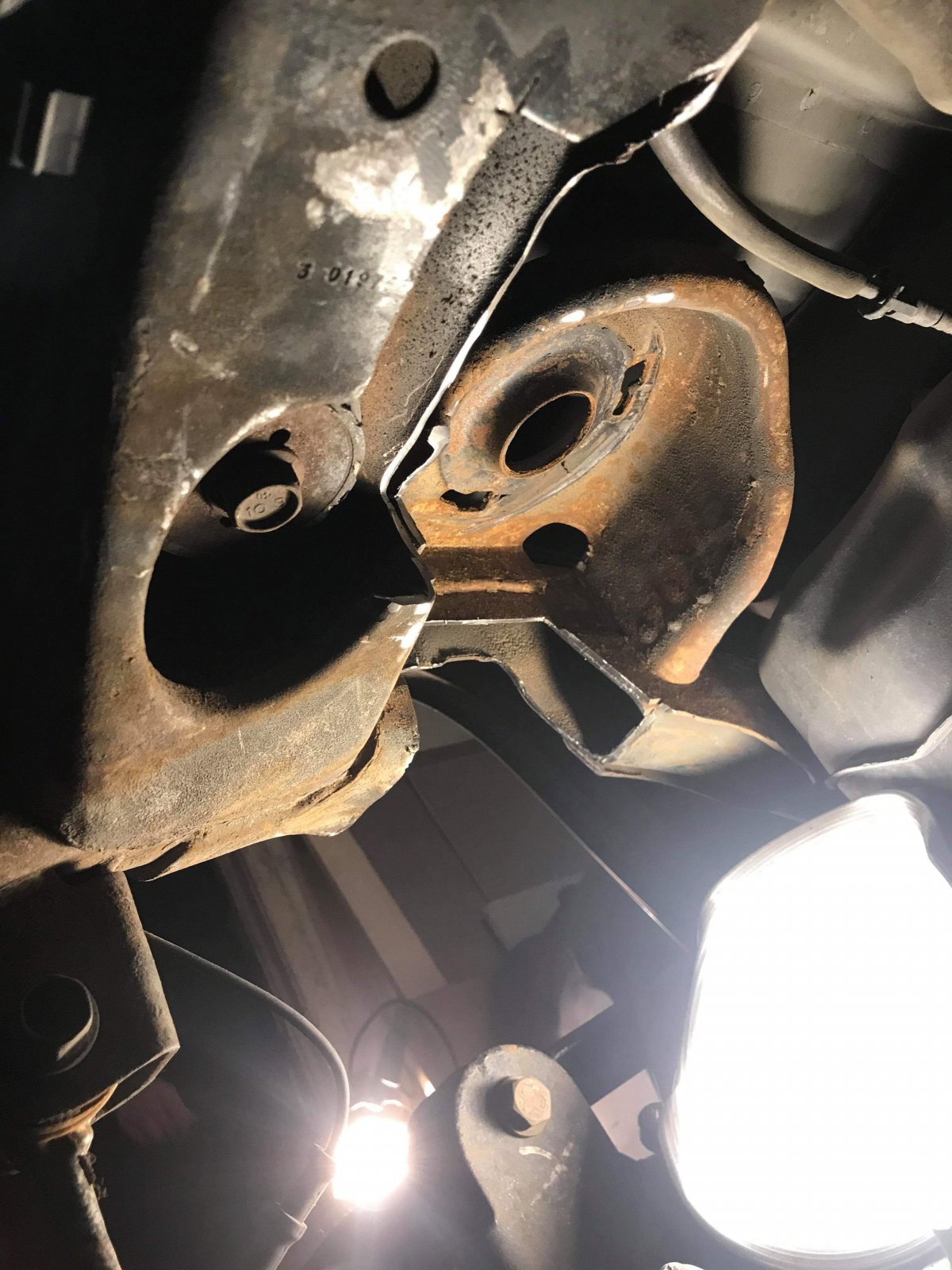

I am curious to see pics when you clearance the crossmember for the panhard bar.
I get a thump when I go over a bump to fast... I assumed it was the axle hitting the frame but it could be the crossmember and panhard bar i guess... haven't been back under there to look... lol
Have you done the free travel mod for the axle hitting the frame? The other thing that hits is the panhard bar on the passenger side end link. DJM sells a set of offset end links for that.
kbuskill
Mar 11, 2017
5,319
8,355
NE. FL.
Yes I did and yes I do have the DJM end links as well as the Spohn Panhard bar...
It was actually NorcalSS that mentioned the panhard bar may be hitting the crossmember to me... I just remember 992dr saying something about possibly clearancing his so I figured there would be pics involved.
I think Tony's 6" springs for the Tahoe may be slightly lower for the long body.
Without the auto leveling hooked up the axle has maybe 2" until it touches the frame... not a while lot of travel... I honestly don't know how you could use these springs and NOT do the free travel mod.
