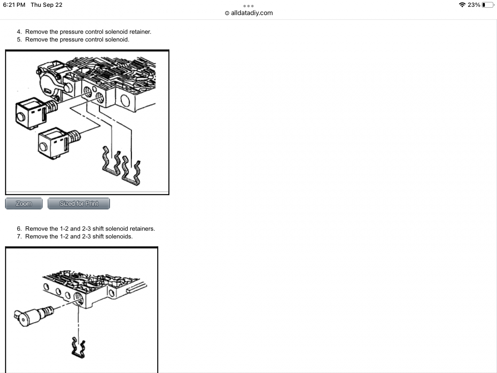

Fully removed pan after clearing steering linkage. Upon visual inspection, all wire connectors seem secure and tight. Fluid looks very clean (just changed 5k miles ago). No metal bits in the fluid. The one concern is one of the modules (unsure what it is) is loose compared to the one next to it. See video. That is the only item I can find concerning before I put everything back. Anyone know if it should be as loose as what the video shows? If all is good, I'll reassemble and give it a try.
Video Link:
