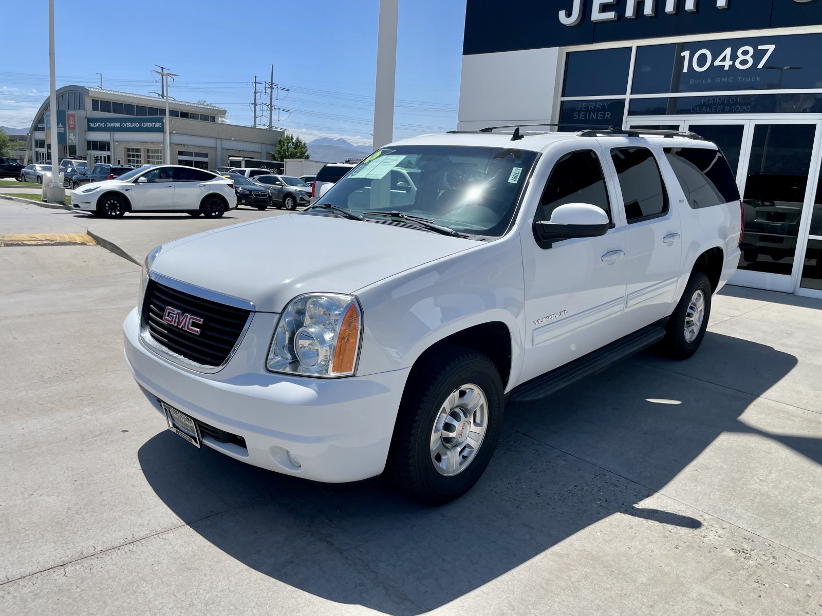

Ended up getting the 2013. The newer 6.2 was very nice but also alot more money and we decided against spending that much. Bringing her home today and will try to get some photos! Thank you to everyone that posted and shared all their insight and experiences1692123391497.jpeg
