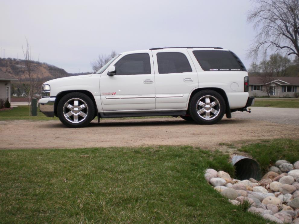

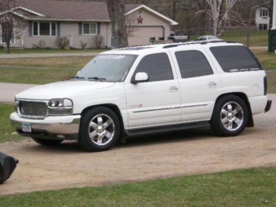

All done and adjusted...........:party36:

Right on, Looks great man! It's got a nice stance now, and probably riding better with everything adjusted right. Ya no problem man :Handshake: helps to get input, suggestions, advice from others who have dealt/dealing with same sh$t. im still learning, but glad to help when I can. Been messing with my suspension for over 5 yrs, constantly changing and trying new things n ways. And I (well especially the wife-which is who I have to get to love it to justify my time n money, haha) like the way my Tahoe rides and handles. But.... Can always be better:imo:
Ya Just moving the sway bar over should be money. Like I said, I just try different sh$t to see how it feels, and grinding bracket and putting sway back at stock location seemed to work for me. Or just in my head:Stupid Me: Life of a modder
Cool u got it worked out man

yuko04- digging the stance bro.. you will come to find out, there is no low enough lol..

Yuko04- what are ur measurements now? what size tire? It looks like a 3/5 drop now, much better! You have the 4230 coils? wish I knew someone local that had those so I could feel how they ride.
