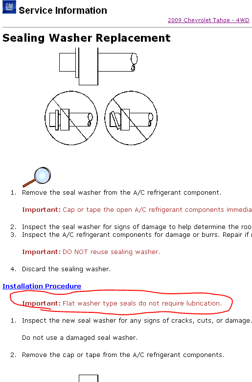

If you’re vacuuming the system down and it’s holding then I would assume you are overcharging the system when you’re adding refrigerant, causing a leak…
Well, the system calls for 3 pounds and we used four 12 ounce cans.
Maybe the O ring got pinched causing it to still leak?
I thought that, but they have metal in them and appear to be non-directional as well.
When you created the vacuum and got to the reading you wanted, how long did you turn off the pump and watch the vacuum needle?
About an hour give or take.

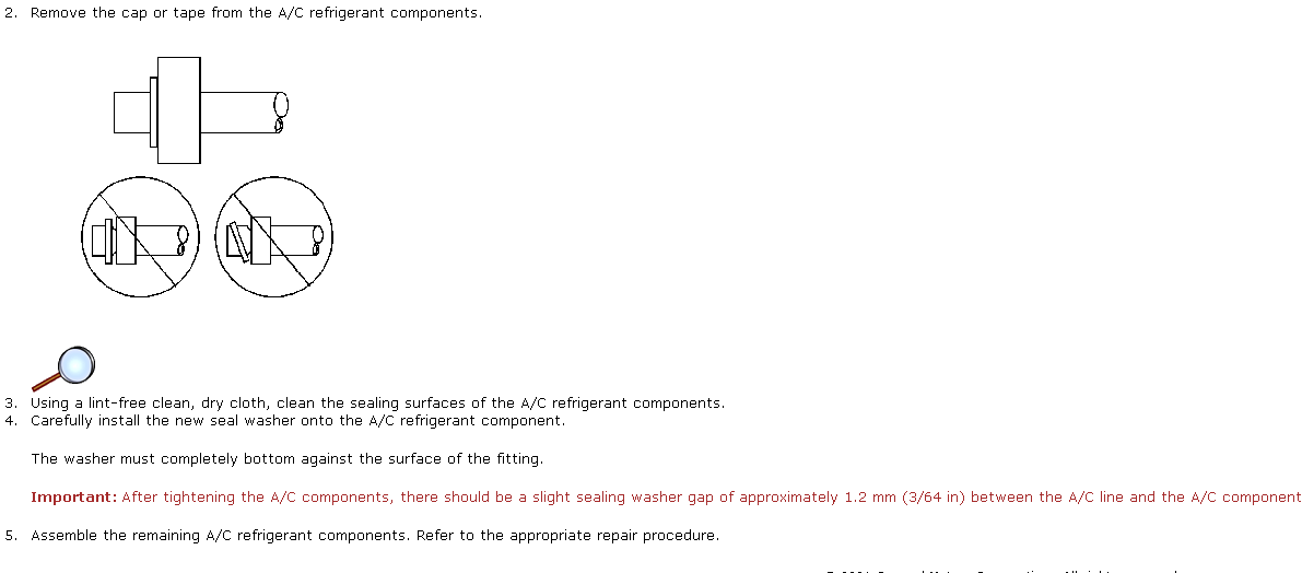

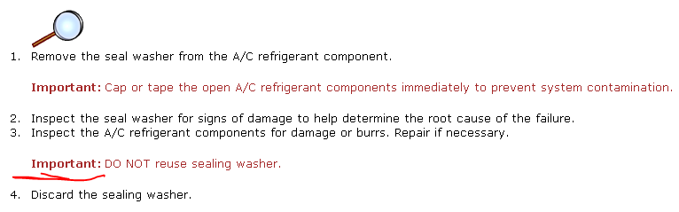

Maybe the line is cracked and it's not the O-ring.
They recommend holding a vacuum for 12hrs or overnight… especially if your having issues like your having.
It's leaking at the connection, both before and after replacing the gasket. I reckon one or the other has become mis-shapen so we'll replace them both. You can tell its here and nowhere else because of all the bright green refrigerant.
