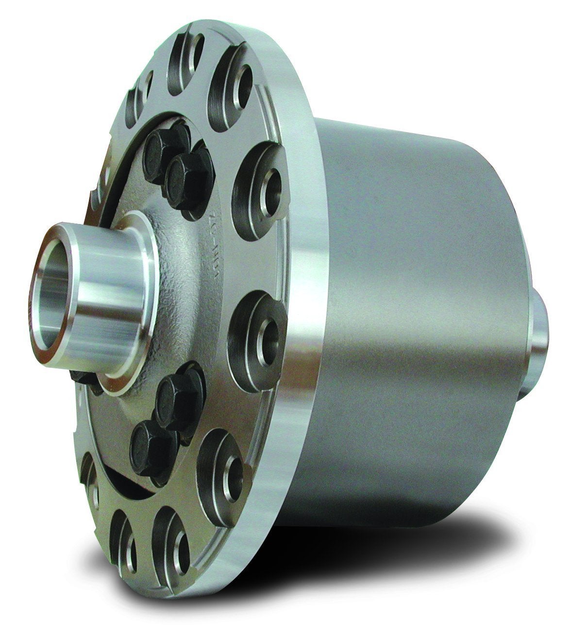

Got the unit out, easy with the right tools.
Next to figure out how to get the bearing on and the ring gear off.
L
ls1frc
Aug 10, 2019
923
1,350
Actually don't even need to take the bearings off, that's great. Need to heat up the ring gear and get it to slide off.
L
ls1frc
Aug 10, 2019
923
1,350
Checked backlash. Got .011. Looks like a consistent reading. With new diff do I just match it?
