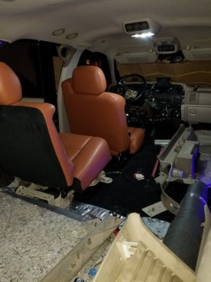

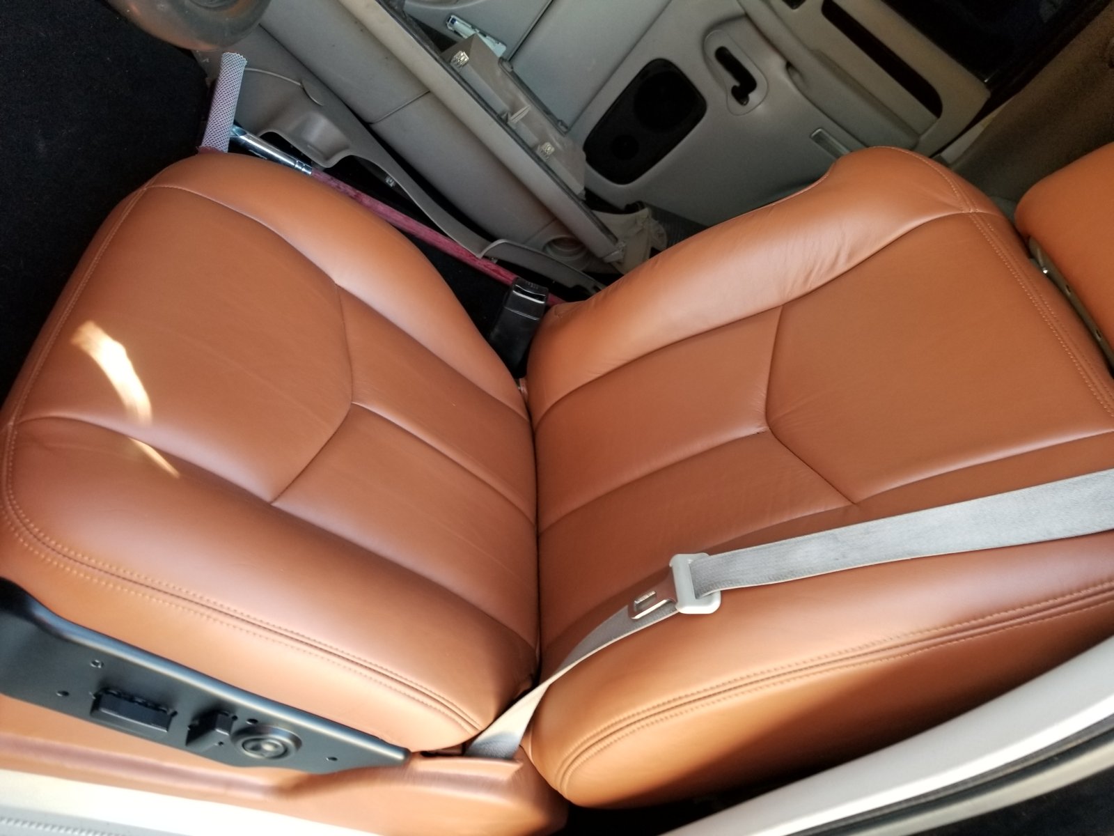

Houston weather is blistering, but I got everything done in preparation for my q-logic factory fit subwoofer enclosure to get here monday.
LED interior bulbs
LED white reverse bulbs, LED Amber DRL, LED amber turns and side markers
It's too late for the DRL to come on, with the tint I just put on 20% over everything. So about 15% up front and about 7% in the back 5 windows MP audio on 1960 for anyone in houston, they did my whole truck tinted for $180, Great work for a great price. I usually get all my audio work done there, but I'm doing this one myself.
Got my Pioneer GM-D8601mounted on mdf on under the 40 side of 2nd row bench
4ga wires ran, 12ga for the sub.
Ran my esky Ec170 backup cam, although I've gotta pull the video cable out and put in a different place I guess because I can't get it to come on automatically or at all for that case, I wired it to the driver side reverse light, then ran the video cable up to the back of my AVH-X2800bs, I don't know if it's not supposed to be in RC-In where I placed it or Video-In/out. So if anyone knows that answer it would be cool if ya share!
Here's some pics!2016-07-09 18.58.04.jpg 20160709_184826.jpg 20160709_185614.jpg 20160709_184824.jpg 20160709_184818.jpg
