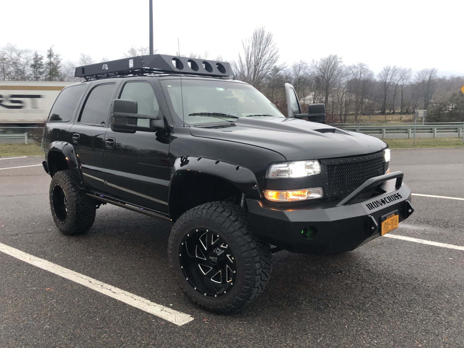

Finally put the HD hood on my 03 to finish the conversion. Still a lot of prep and paint to be done but I'm just glad it's on. 2f07f36219e60ad761d414e63a0722b9.jpg
