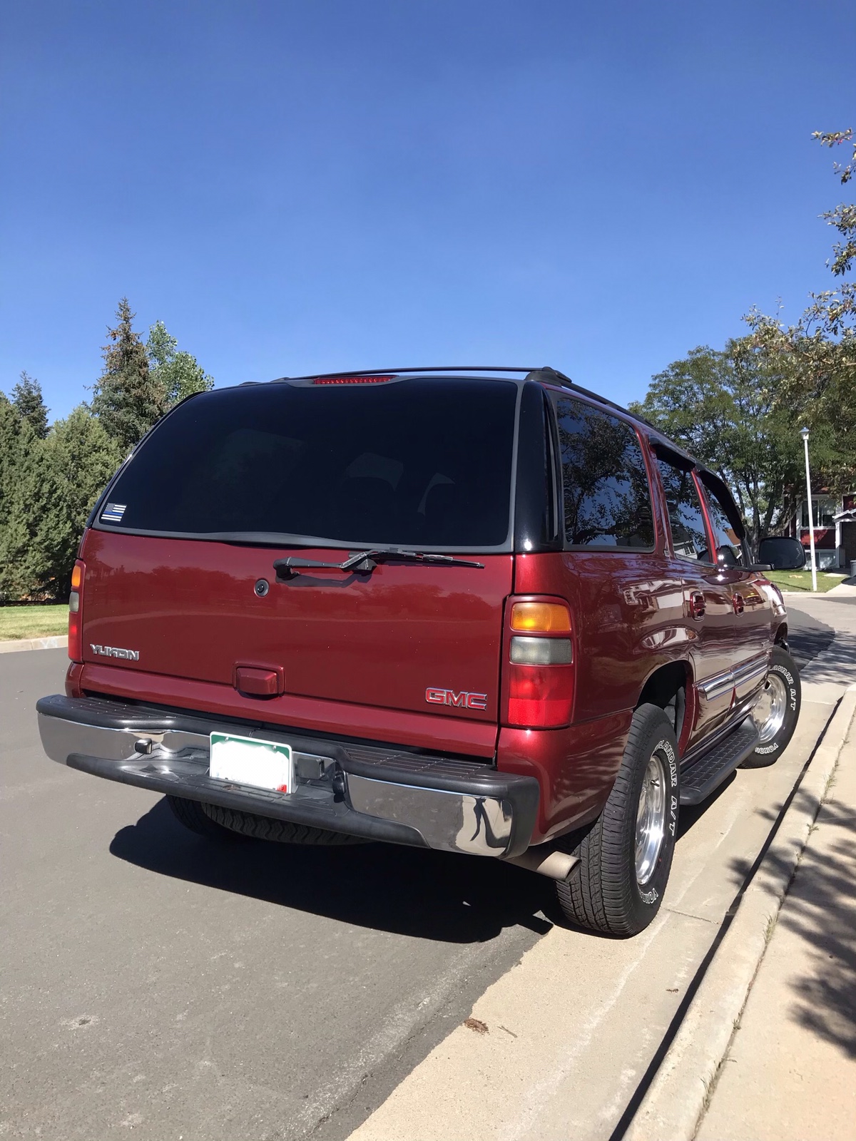

I picked up an NNBS Tahoe rear visor on ebay to mount on my NBS. It’s going to take some modifications to get it to fit but the roof line matches exactly. The ends will have to be reworked to match the curvature of the glass, so I picked up a sheet of 1/8” thick ABS plastic to do some plastic welding. I’ll probably be swapping the rear glass to the ’05-06 second design since it has three similar mounting holes like the NNBS glass.
I guess a few of us had the same idea. :cheers:
