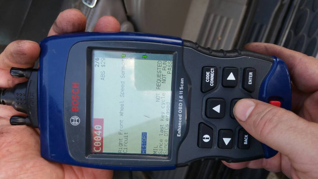

So progress has been made. Got rid of on the c codes for the abs module. Still have C0040 which is the front right wheel speed sensor. I checked it with my multimeter and it is fine. I am getting the proper level of resistance from it. So my next idea is that the Hub might be going bad. The Hub Holt the wheel speed sensor is fine. I know that's not the right word for it and I can't think of it right now. It's the rigid piece that detects when the wheel is spinning. Found a picture online but even that doesn't show the spline that I'm talking about. I also know if the air gap is off from the wheel speed sensor it will throw up the error code. But I have no idea how to check it does anyone else?
