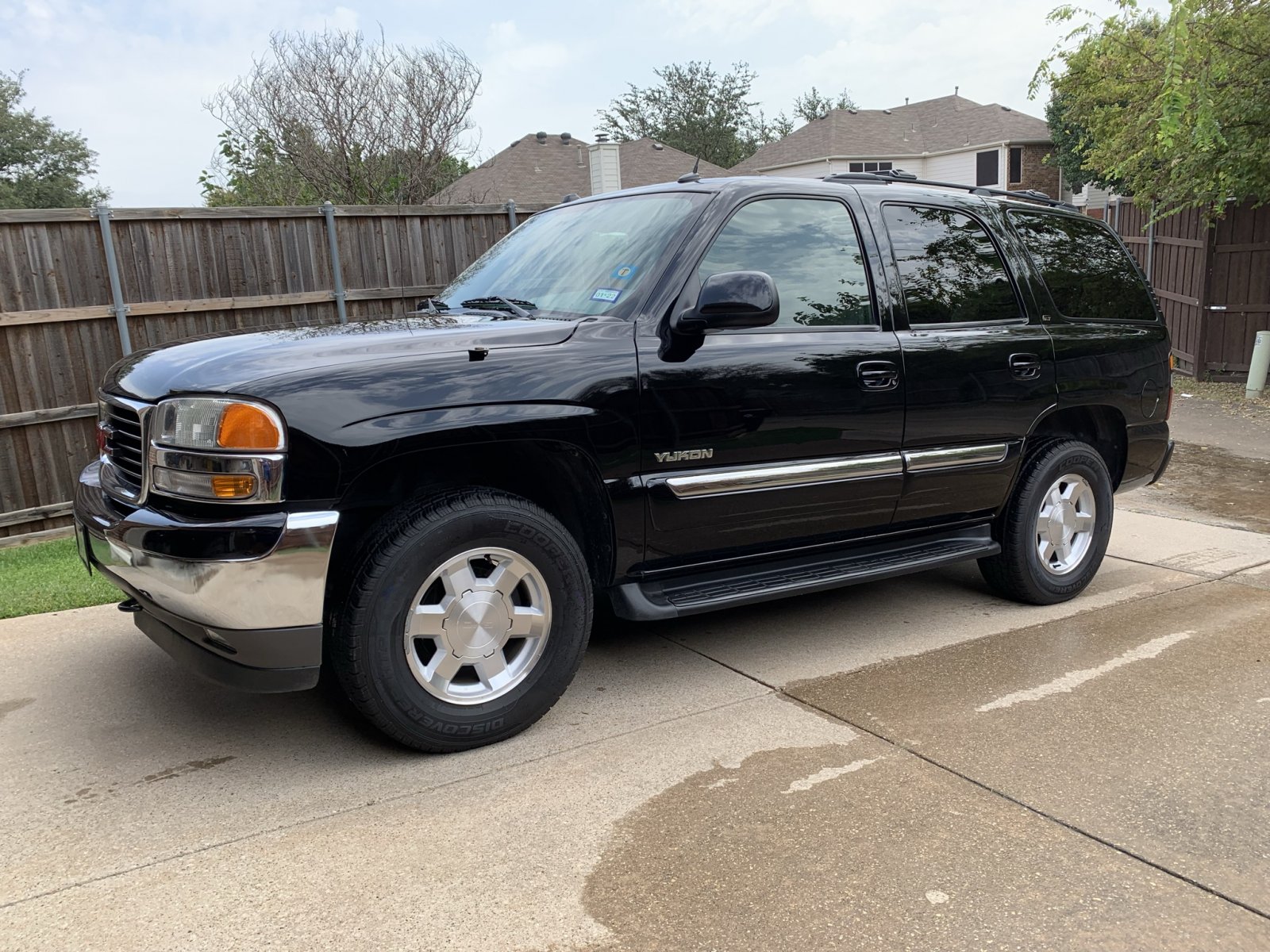

Last week I picked up the truck from the body shop after a new paint job. Every panel was flaking paint, so it needed to be done. A bit of overspray in places, but it looks almost new.

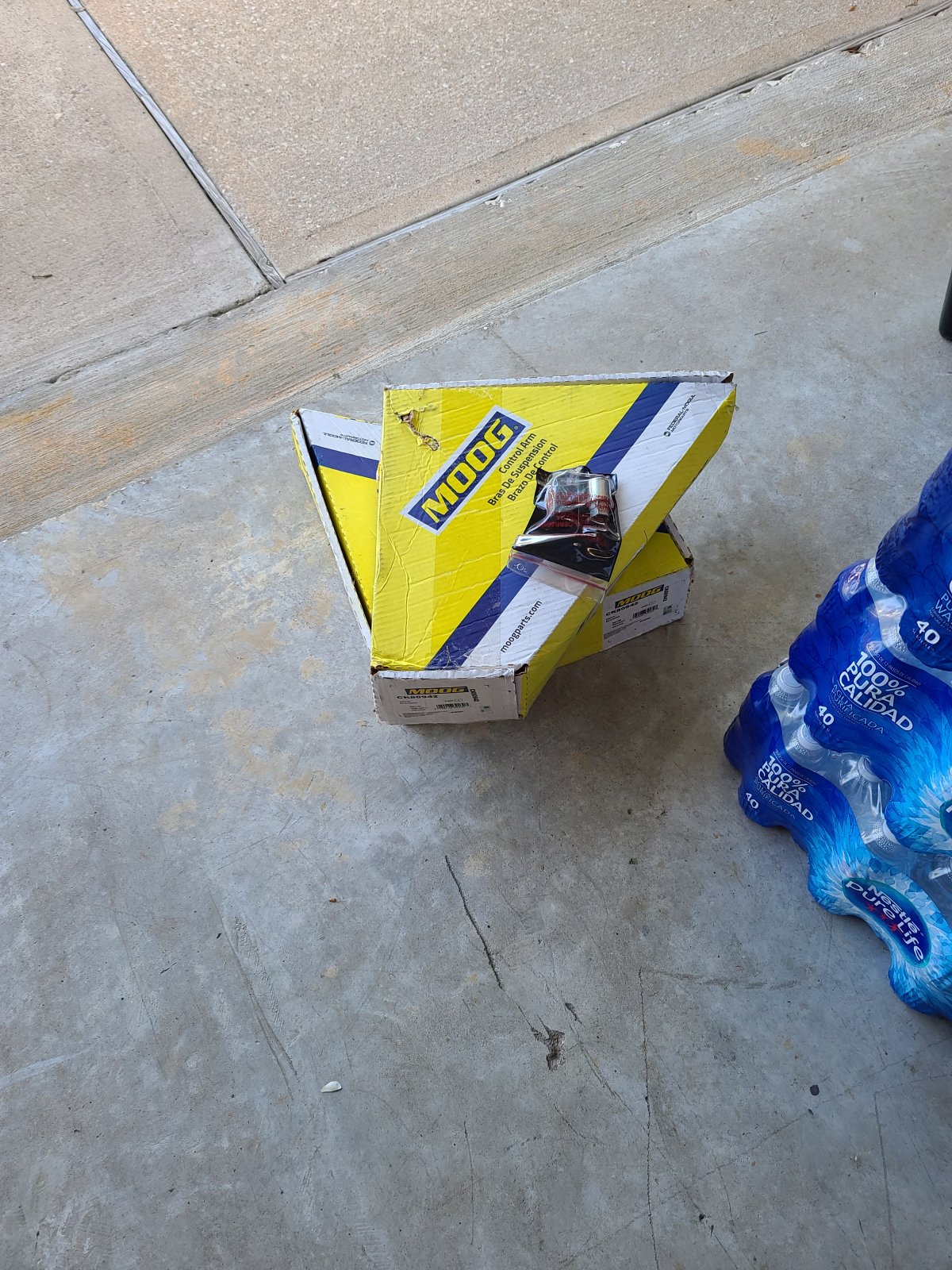

Yesterday I replaced the loose idler arm and bracket with Moog, and attempted the pitman arm. A puller, impact wrench, hammer, breaker bar, and blowtorch couldn't get that thing off. I'm probably going to have to take it somewhere.
Today I replaced the sway bar end links and brackets with Energy Suspension polyurethanes.
Tomorrow, I'll be replacing the brakes and rotors with Powerstops, and next weekend will be the inner and outer tie rods, all 4 ball joints (all Moog), and if I have time, the upper and lower control arm bushings (Energy polyurethane).
