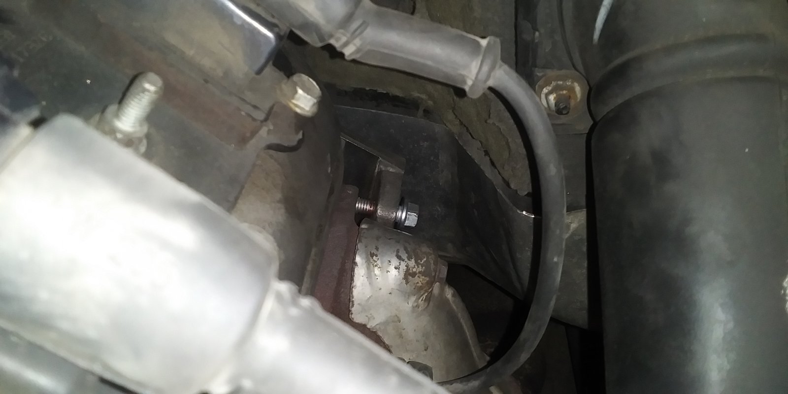

Since I've had my Yukon that back HVAC has not worked properly. I tracked it down to what I thought was a bad air blend door actuator. As it it now starting to get hotter, I decided to tackle the project. After watching some videos it seemed pretty straight forward, just removing all the interior trim and panels to actually get at it. Much simpler than getting to the passenger side front actuator that I replaced last year.
Finally got to it, and pulled it out and to my surprise this is what I found:
The shaft came out with the actuator, and appears to be no longer attached to the blend door.
So I guess today, all I did was find out that I have a larger problem to deal with, and the actuator is likely fine.
Has anyone else dealt with a similar problem? I assume I have to pull the whole HVAC unit and split it open to replace the door? Any pointers would be welcome.

That video looks like you'll be having some fun but like you said at least it's not under the dash. I did the recirc door actuator and that one's 5 times harder than the blend door.
Yeah, at least it's some what accessible. My first thought was to try to epoxy the broken spindle after seeing the break in the video. But I can also get the whole housing for $90 delivered, so if I am going to have to take it apart to try to fix the break, I should probably just replace the unit with a new one rather than having to take it apart a second time when the epoxy lets go.
You could even plastic weld it back together in one piece but that new box is definitely a cheap PEACE OF MIND!
