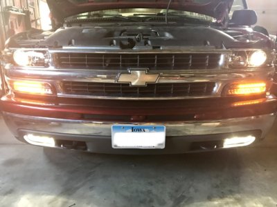

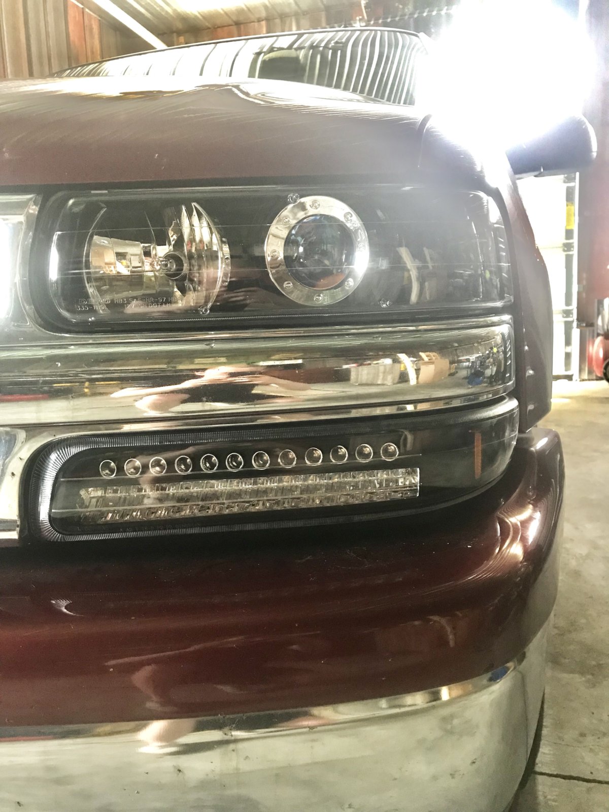

New headlights and signal lights came in today! Had some issues with a blown fuse for the turn signal because I didn't pay attention to polarity, and I can't figure out how to turn the DRL's on. But it's installed!

View attachment 198599 View attachment 198600
those look damn good.
the drl lights, e brake on, key to run, put the truck in drive, they will then turn on. they only work when the trucks in gear.

I tried this @Scottydoggs , and still didn't see the DRL's turn on. I'll try what @05Single suggested and see if I get anything. If not, the female connector that they plug into was black and charred when I pulled the halogen bulbs out, so I'll try replacing those since they got pretty hot.

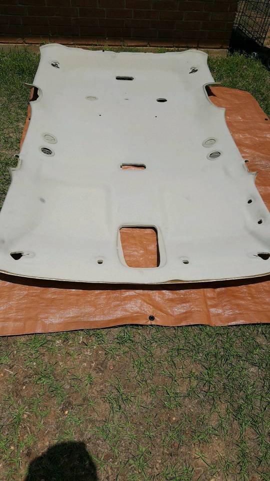

Didn't want to stretch back in place. So I have to find a fabric place and get new material. a28267c0a8774b2970c236e2a07a3be1.jpg6ed8ace4b0694d43631b208a268451f4.jpg
