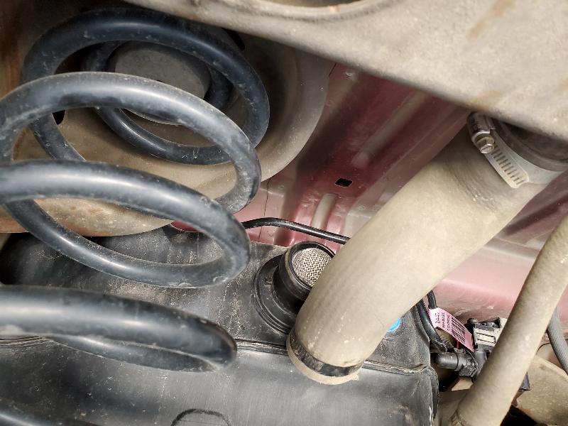

There is a strainer that slips into the tank filler stub, maybe to prevent siphoning? It just slips in and out but is the exact size for the inlet.
