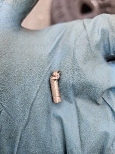

I finally worked on the rear ds brake line. The guy who originally did it was a butcher. What happened was i blew the rearend, so I paid a shop to swap rears. I supplied the new/used rearend. We'll, I found out much later that the shop farmed it out to a guy. He must've stretched/broke my braided brake line and replaced it with a rubber line. Didn't even tell me. He also replaced the steel hard line and used the wrong type of flare. So anyway I installed a new braided line and used a bubble flare--Thx @Fless --. It now stops when I step on the pedal.
This is the flare he used for the brake lines connection.
I kept messing up the flares. Found out I was using the wrong size.
Thank God I'm done. Now I need to use the Tech2 to bleed the abs--anyone know the correct process?

Just to clarify--I was using a flaring bit that was too small for the inlet OD of the pre existing brake line. That's why the flares were collapsing or coming out crooked. Using the correct sized bit fixed that.
