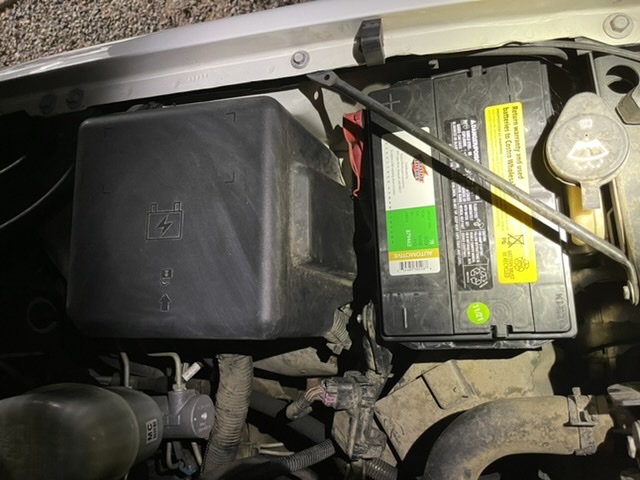

Battery died about 50 miles from home. Luckily a Costco was a few miles down the road. I usually carry at least a 8/10 mm wrench/socket/ratchet for emergencies . I was able to loosen up the 14 mm bolt for the battery tie down with some pliers.

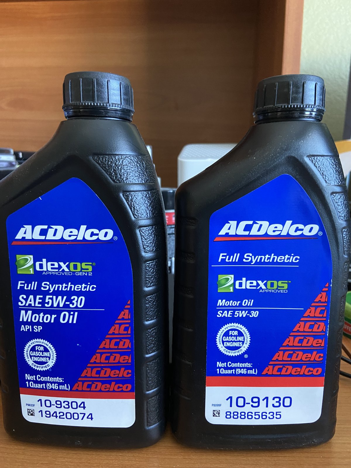

Another thing.. I have been using ACDelco oil for the last 1.5 years or so, and am quite happy with it. But can anyone tell me why there are different part numbers on some of the quarts..? I want to ensure this is genuine oil, and not some rip-off..!
