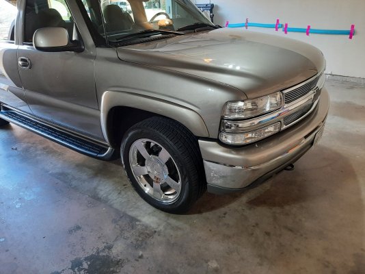

Just installed my painted upper bumper cap and gave her a wash.
