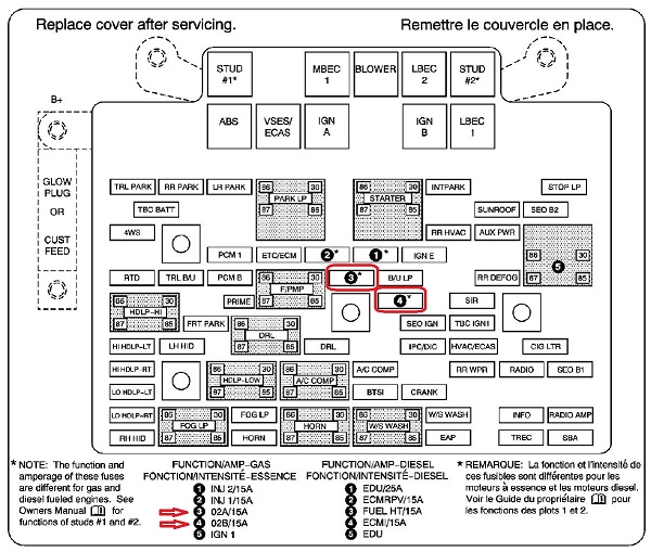

Here are the O2 heater fuses to check if you are so inclined (O2A is for front; O2B for the downstream):
