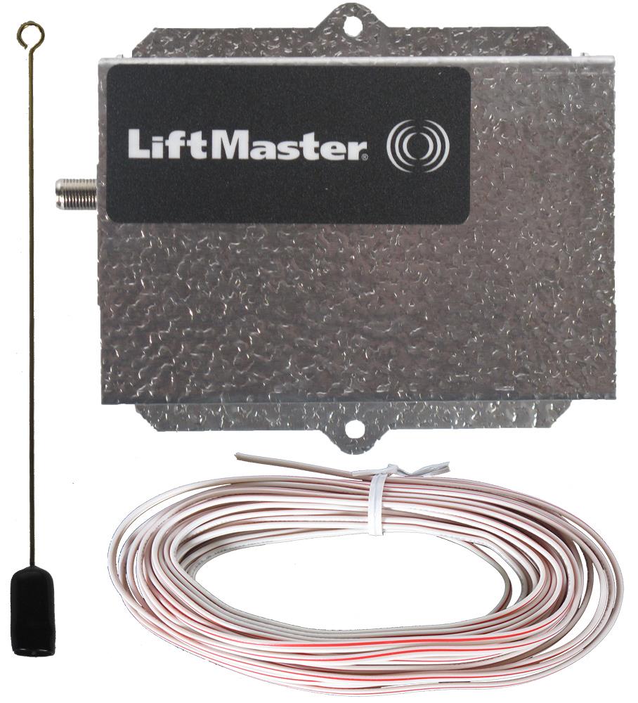

You nailed it! As an example, Liftmaster has this universal receiver:
It uses a standard RG-6 male on the housing and that antenna is just a stiff wire for the core/center conductor with the outer female coupler (under the black vinyl cap). You can screw the antenna directly to the receiver or use an extension kit if needed:
I have this receiver on my shop's door operator. I don't have the extension kit, or even that antenna. I screwed a length of coax to the receiver and routed it out through the peak of my shop, above the door. I stripped off the insulation and shield to expose the core the same length that the antenna is. A friend that still did doors at the time gave me the measurement. Remotes work great!

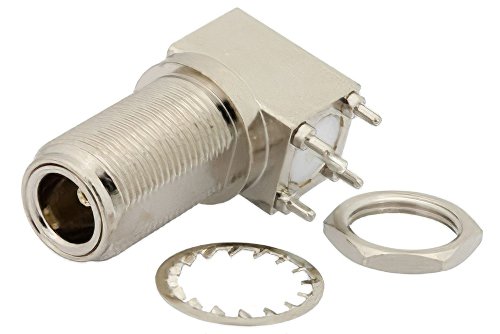

The problem with the residential operators is that the antenna is just a length of wire soldered directly to the control board. The newer ones don't even have that. You could solder something like this:
to the PCB and run a coax to wherever you wanna put an antenna.
Now if the coaxial connector was integrated into the GDO and the antenna was removable, I'd have the option of using the antenna directly at the GDO or using a coaxial extension to move it closer to the outside so the metal door wouldn't shield the signal. Mine's a Sears belt drive that is probably 12 years or so old. I should look at it to see if I could integrate an F-connector like that. Weird though that it would be RG6 (75 ohm); usually this type of application is RG58 (50 ohm).
