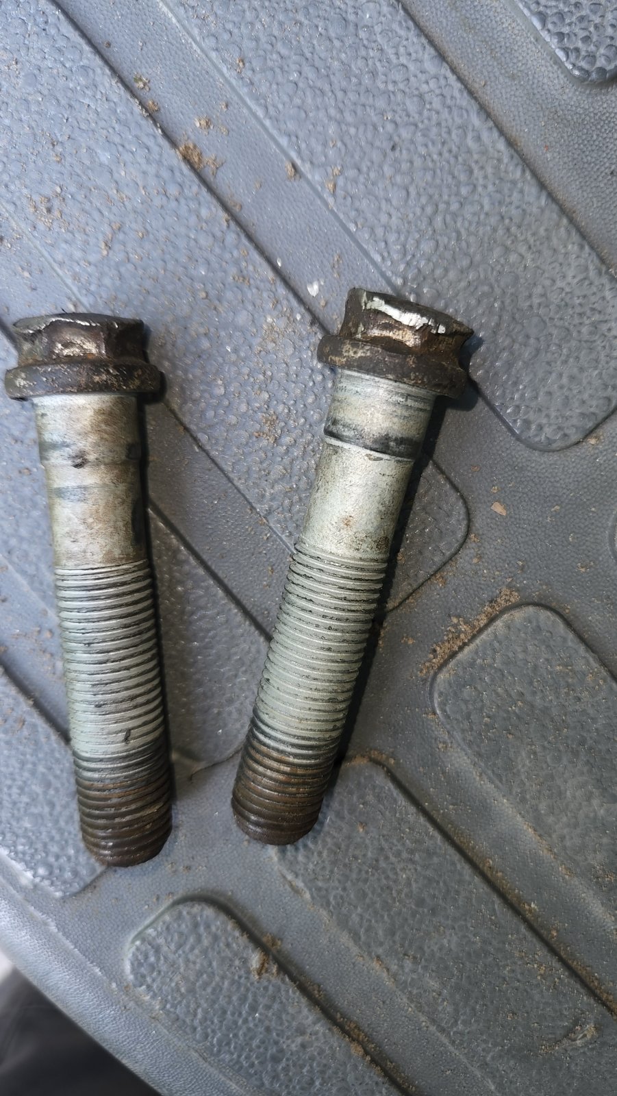

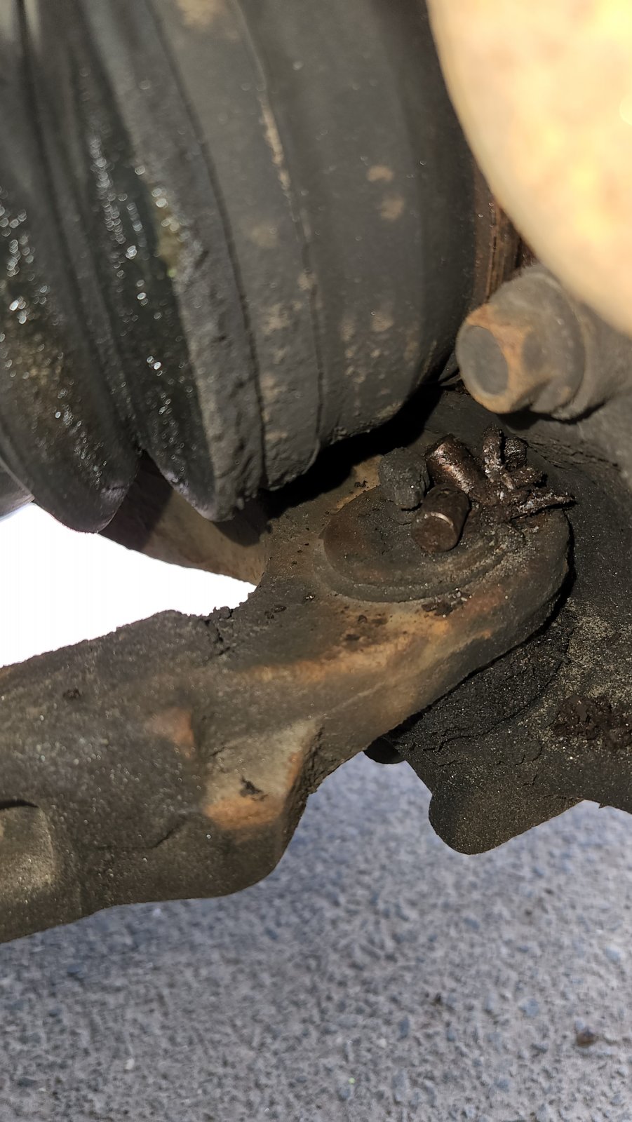

Recently, I had an ABS code related to the right front speed sensor come up. The code cleared and was gone for almost a week. Running fine.
Found out the recent Right Front ABS sensor issues were 100% caused by failing hub.
Made a big POW and grinding noise driving home from Home Depot.
This is what I found in the morning... It spit out bearing rollers like a hockey player spits teeth!
I was able to pull the front half of the hub off by hand as soon as I got the axle nut removed.
Removing the back half of the hub was the fun part!
The only thing that got the hub to pop out was backing the bolts out about a half inch and beating the snot out of the bolts. I am so glad I bought the new bolts!!! I am keeping these to use again the next time...
This all that remained after the hub ate the ABS sensor...

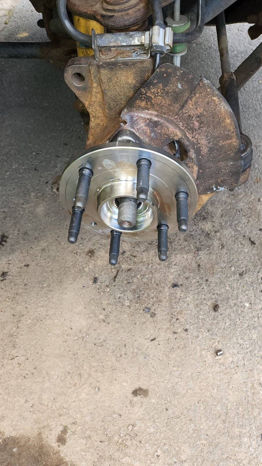

New hub had sensor included.
Here is the new hub. I did not go low-grade, because I could get the better hub with 20% discount this week from NAPA. It was https://www.napaonline.com/en/p/BRGBR930304?impressionRank=1
Someone more knowledgable can tell me more...
It is an SKF part BR930304.
From a quick search, I saw some information that SKF was OE supplier to GM and may actually be Timken.
Let me know.
Usually with NAPA, the higher price item really is the premium product from the major OE suppliers. I have never been disappointed any time I went with their higher-priced items.
I still had time to get out and mow the lawn after I was done.
All is good in the neighborhood. No ABS codes and everything feels tight.
Let me know.

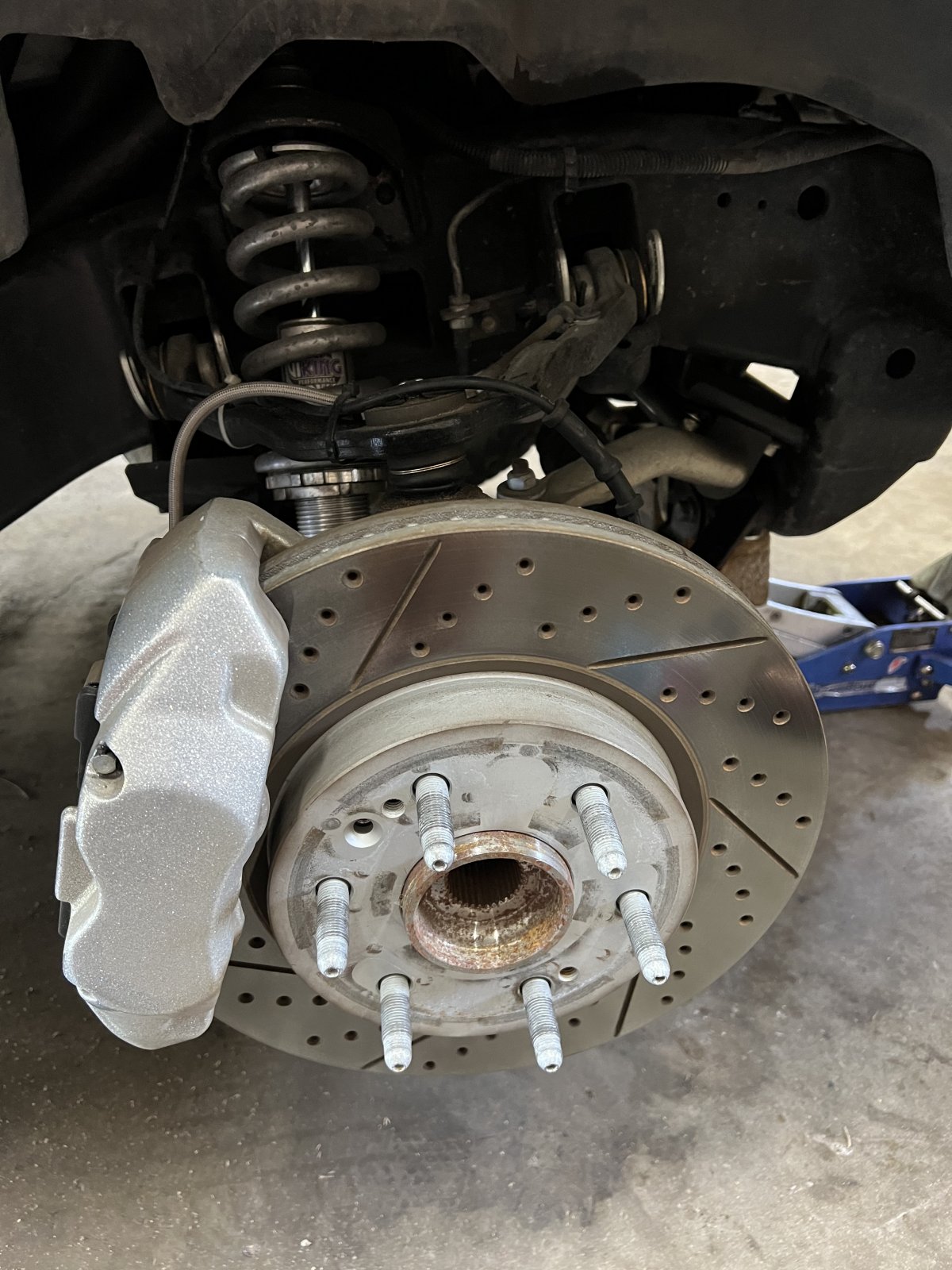

Calipers locking are up scary! Not sure how the pad or rotor quality could have caused that tho. I had a caliper lock up in another truck while I was heading to go camping in the Black Hills of SD. by the time I could find a safe spot to pull over the brake had gotten so hot that when I splashed water on the wheel it immediately sizzled off! Having minimal tools and being by myself I simply tapped the caliper with a hammer after it cooled off, it unlocked and the camping trip resumed. I did swap the caliper put shortly after the trip.
I've had the bigger front brakes for a year or so and probably 15k or more miles, they are the best brake upgrade I've ever done other than swapping to hydro-boost. They are also wearing very well, the pads are very meaty still.

I do feel comfortable with my choice. With 20% off this weekend, I got the SKF (Timken) for $159, which was the regular price of the cheaper product line. So not a bad deal!
FYI for other members to keep in mind for future reference:
This is the source I was referring to... Dodge guy opened Timken box and found "SKF" stamped on the part.
